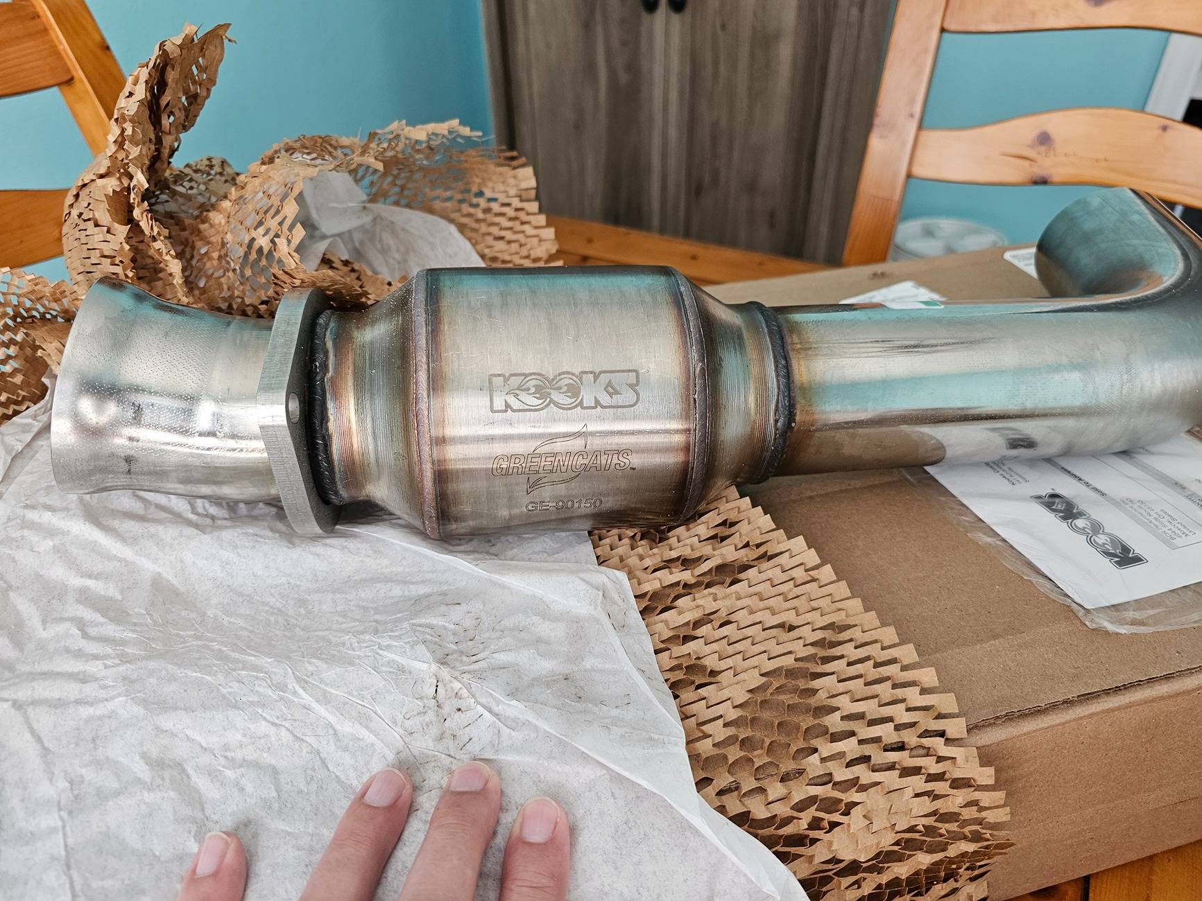

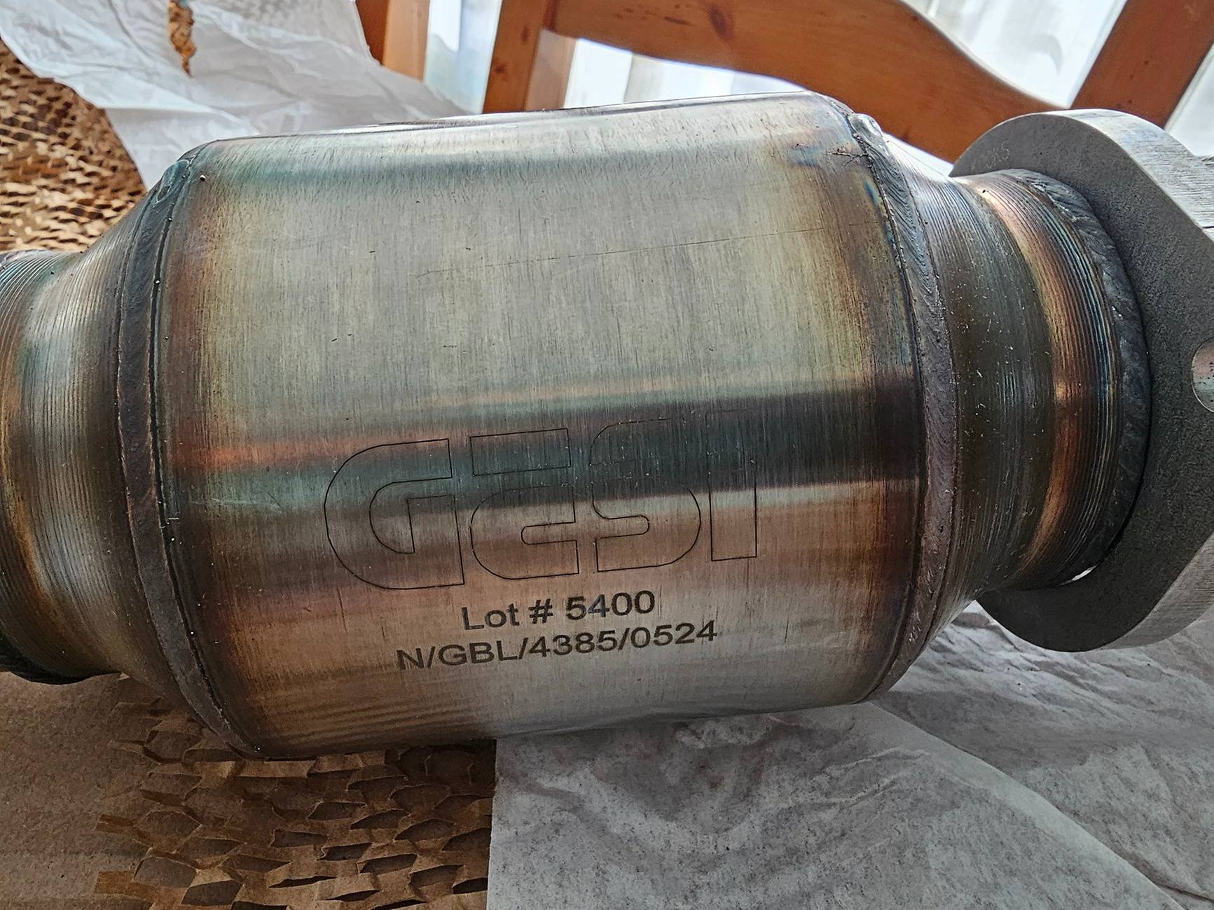

Are they all pretty much the same gesi cat just different names?
Don’t think so GESI can handle highest hp. Kooks greens will often not pass emissions.

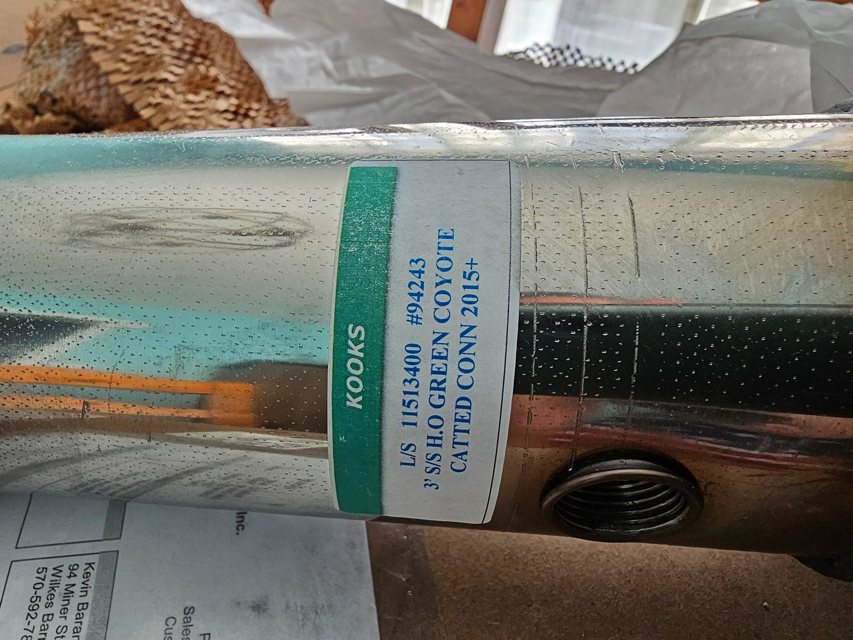

Kooks high output cats are GESI.
The older gen 1 GESI had occasional failures but was often linked to running tunes with cat over temp protection turned off.
The new gen 2 GESI G sport cats which Kooks sells as there High Output Green or Ultra Green cats have a much greater capacity.
I have been CEL free without any issues at 819 whp as well as my buddy at 1070 whp.

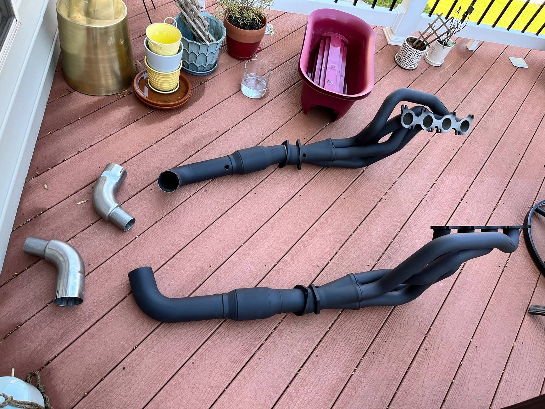

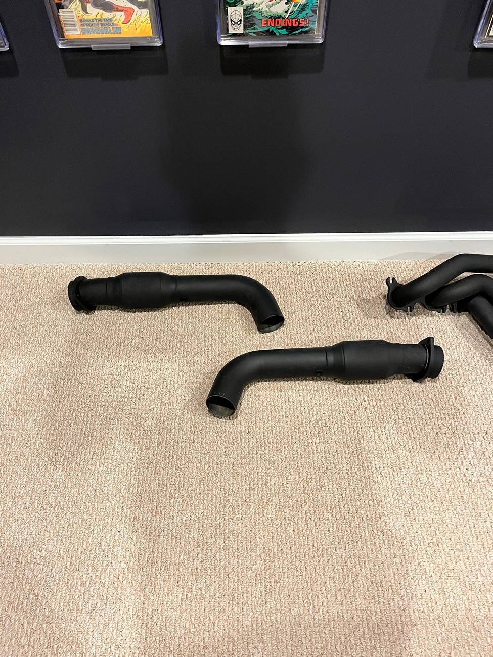

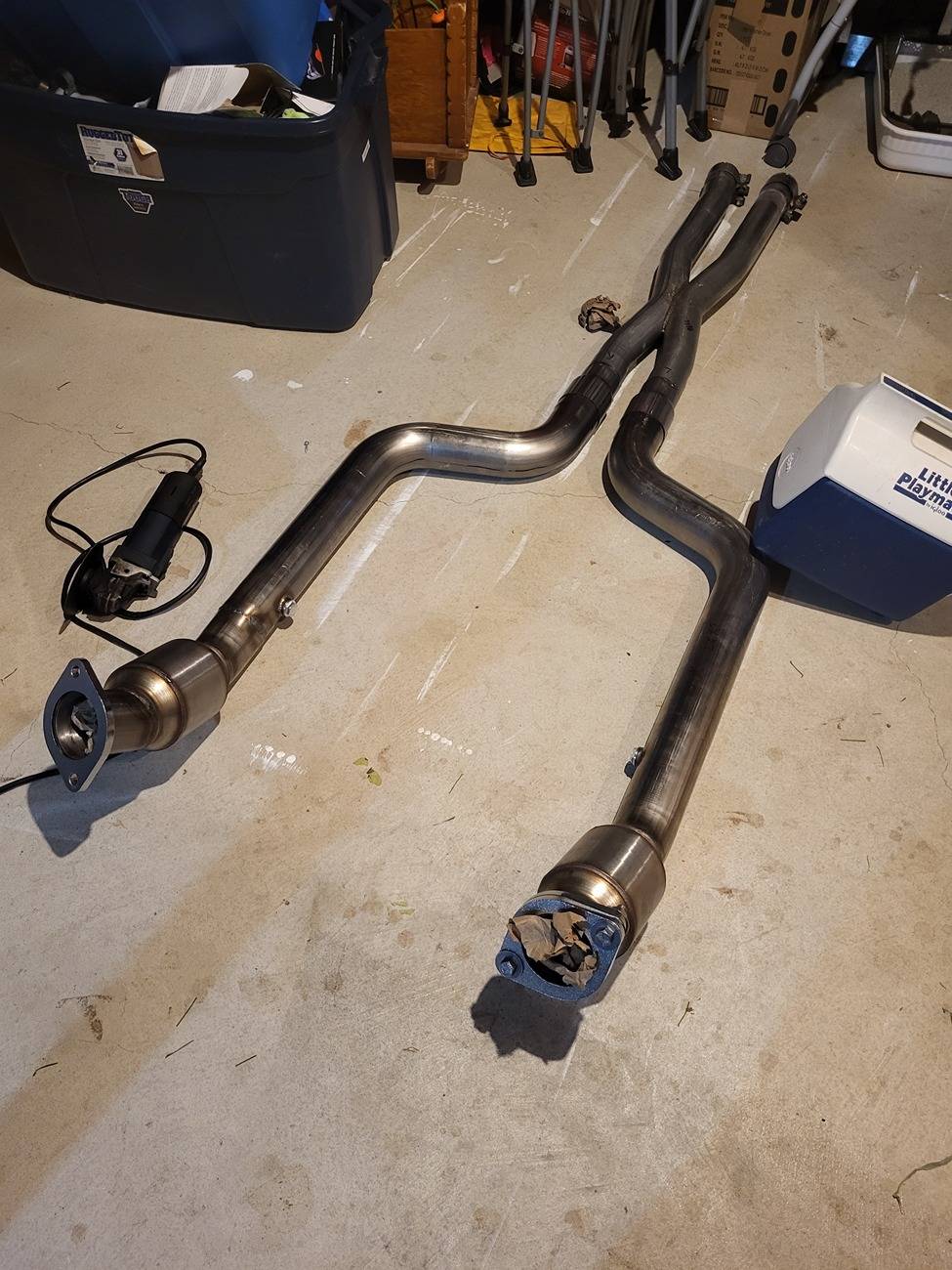

I got a 21 gt pp1, I’m planning on boosting next year I’m doing OPG and crank sprocket this winter. I only have 93 available near me in NH going ess or whipped with biggest wheel 8 psi so will probably be around 650ish wheel HP. My issue is I have factory active exhaust with a H pipe and I love the way it sounds it’s perfect for me not to loud to start up in quite mode, plenty loud when I want it to be. I would love to keep factory headers and cats but everything I have been reading is it will destroy the cats and potential melt them and cause engine issues. Now I don’t take the car to the track I’m not going 1/2 mile pulls. I’ve been researching exhaust like crazy and I think if I have to go long tube cat less to try and maintain the current sound I would swap the h pipe and get a borla resonated h pipe I think it’s 60661. Does anyone have experience with these or running factory headers with 8psi boost ?

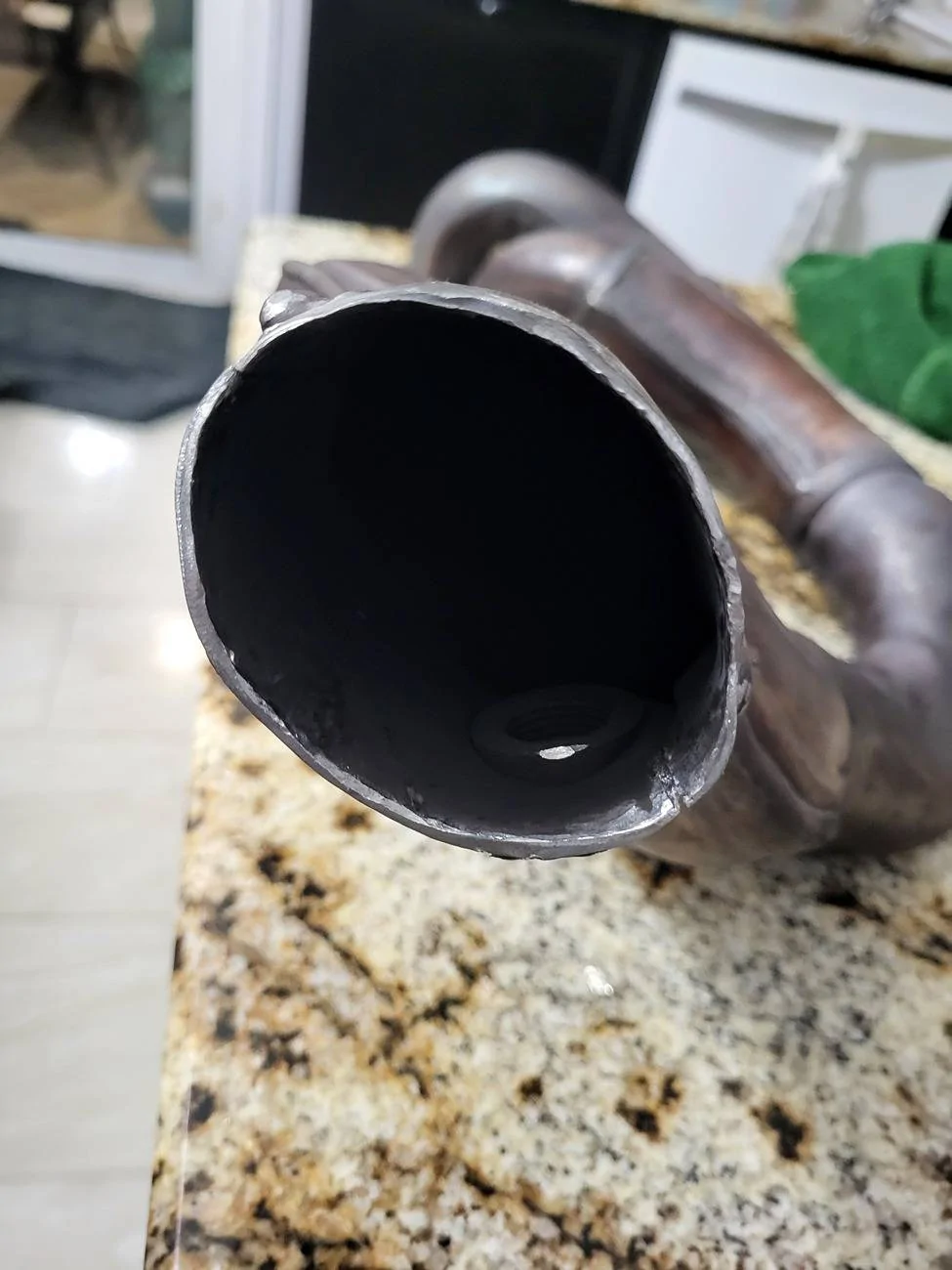

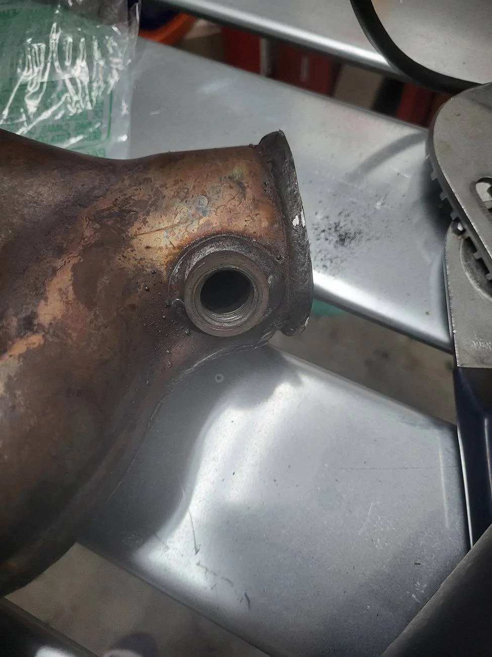

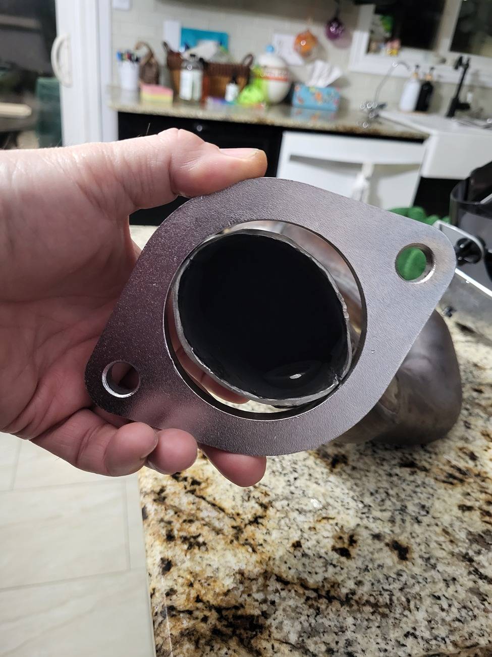

Here is where I am now. About to pull the drivers side header so I can chop off the cat and round the outlet. Next is fitting the drivers side pipe, and then get the tacked welds tigged
And...

There is no way I can see doing this with the header on the car.
