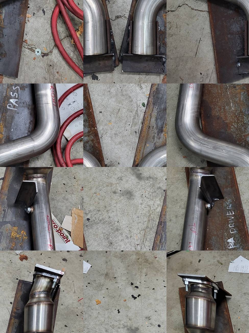

I just posted what I'm doing. 2m Fabricator pipes with Gsport gensi cats spiced it. I tried to post pictures on my reply but it won't work.
Try again
