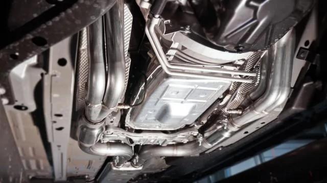

Hey guys
So I've been thinking about getting SW longtubes for a while now, but, I still need cats. Can't go for the high flow, ones because I'm not allowed to put in an aftermarket cat due to regulations etc.
Will a muffler shop be able to essentially cut a part of the headers out so I can switch between a straight pipe and stock cats using just clamps?
Cheers!

All headers use some sort of bolt-on connection, whether it's clamp or ball & socket. So a shop can build you a pipe using the OEM cats to match that fitting depending on which headers you get.

Yeah I was just wondering because the stock cats are on a bit of an angle iirc. And they will sit much lower, right before the midpipe probably

Well that will be an issue then, maybe turn them sideways so the angle is towards the middle of the car instead of up? That will require a bit more bending, but essentially you will have pipe come off the header angled towards the middle of the car, then back towards the outside of the car to match the cat inlet angle.

Just had a quick lots at some pictures. I'm not sure if there's enough clearance for the huge stock cats to fit...

Yeah, definitely an issue if you need the stock cats. I'd probably just forget the longtubes, get some MAK cat delete pipes, and then weld a flange to the stock cat so you can bolt it back up to the driver's side after you cut it off to weld the flange for the MAK pipe. That way there's no issues with them inspecting, and when you get back home you can just reinstall the delete pipes.

As for the cats fitting.. I feel like it might rub. Is it required to have two sets of cats?

I believe he's in Switzerland and they are require to have the factory cats.

Maybe they could be re positioned to where the resonator is? would need some long o2 extensions and stuff though. Not sure if its worthwhile.

The cats need to be close to the cylinders. They need the heat to function. That far away might cause codes, or clog them.
