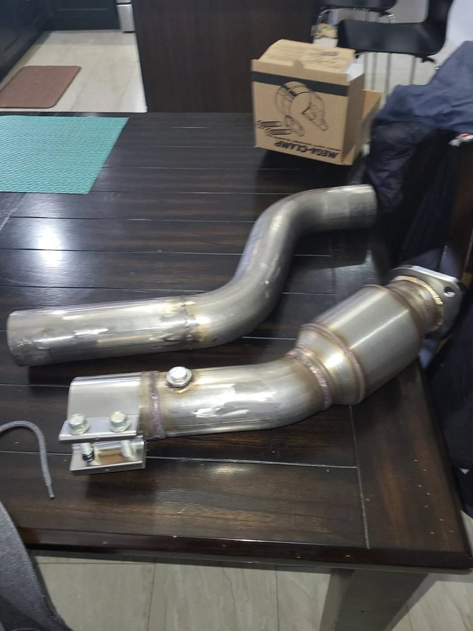

....And in conclusion. I cut the back section off of the drivers side pipe, flared a small piece of chopped of 3" pipe and used it as a union. I welded 1 end to the union to the pipe. Put a clamp on the other end. This let me move the pipe to match the passenger side and get the spacing to match the X pipe. And now we wait until spring...
