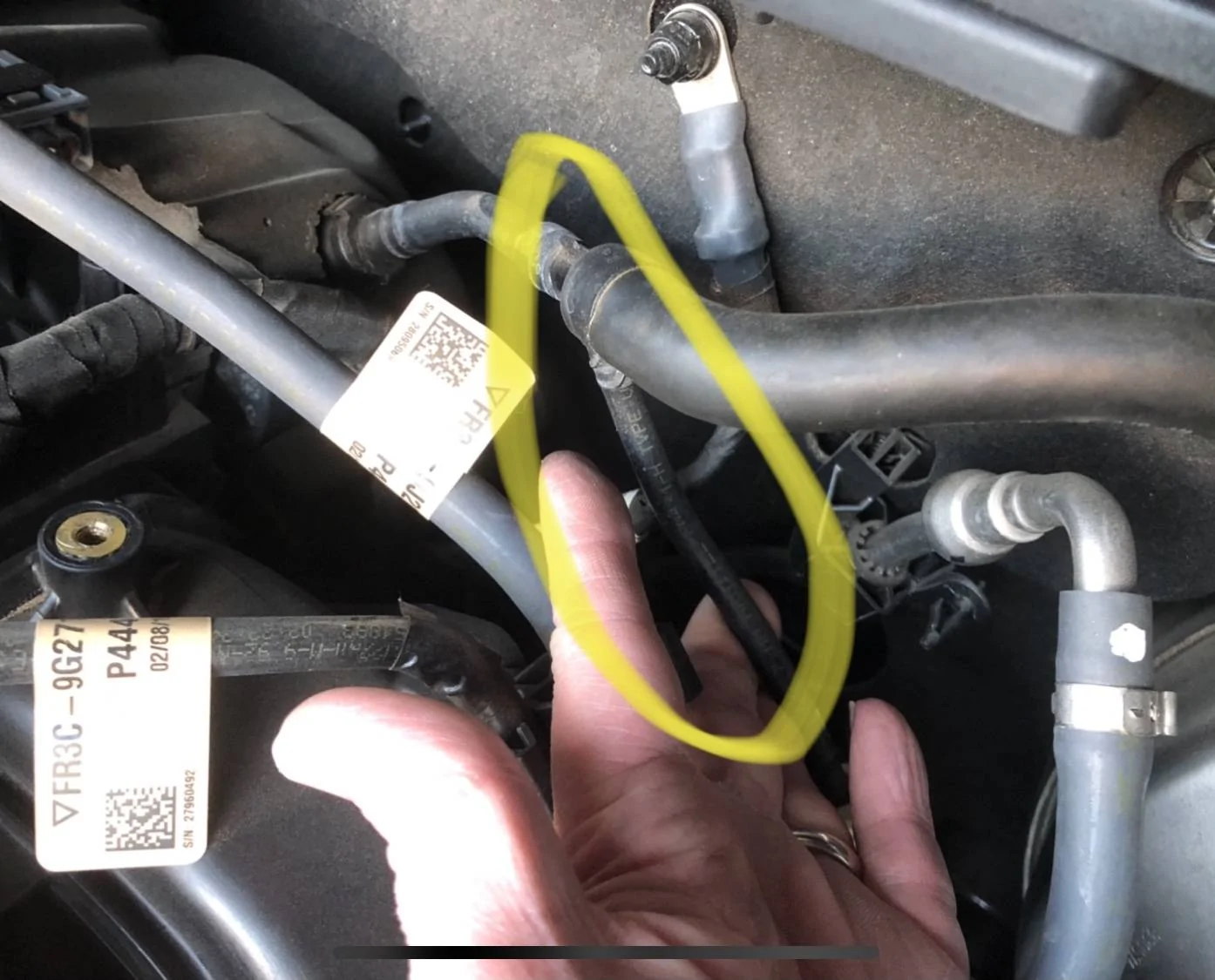

Where did you “T” into for boost reference? The line circled (below) or did you get the Turbosmart Boost Reference adapter?

That looks like the brake booster vacuum line. If it is then no you can not T in there. The brake booster only sees vacuum not boost.

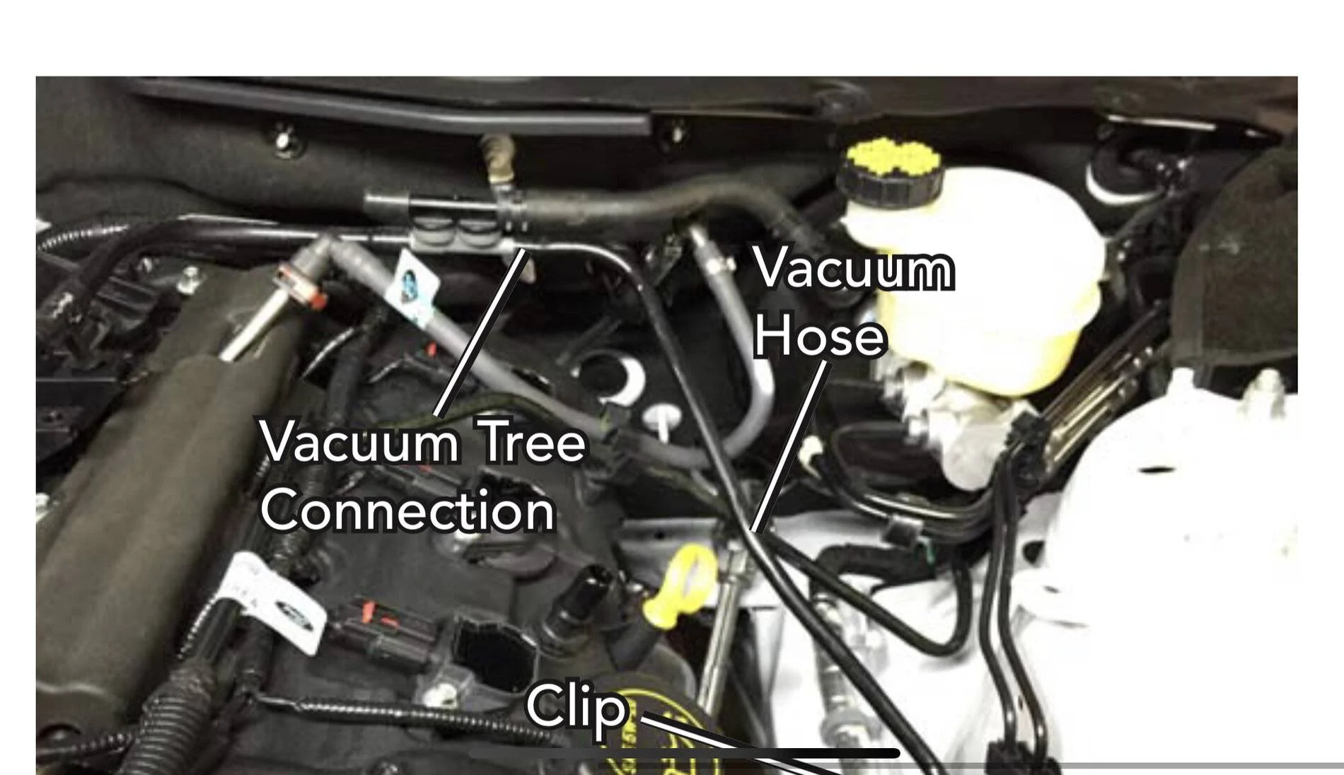

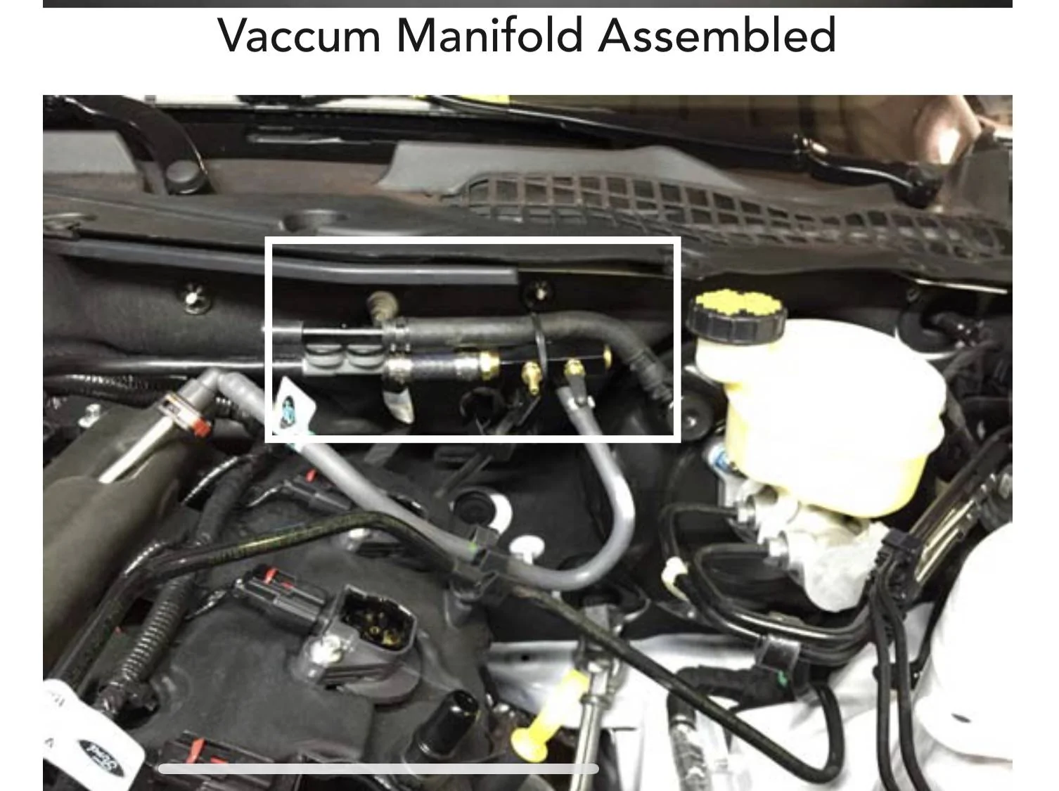

odd. The is pic below is of my Procharged 3.7. Procharger has the vacuum block for boost reference coming from the line hooked to the brake booster. That’s why I thought it might be the same on the Ecoboost.

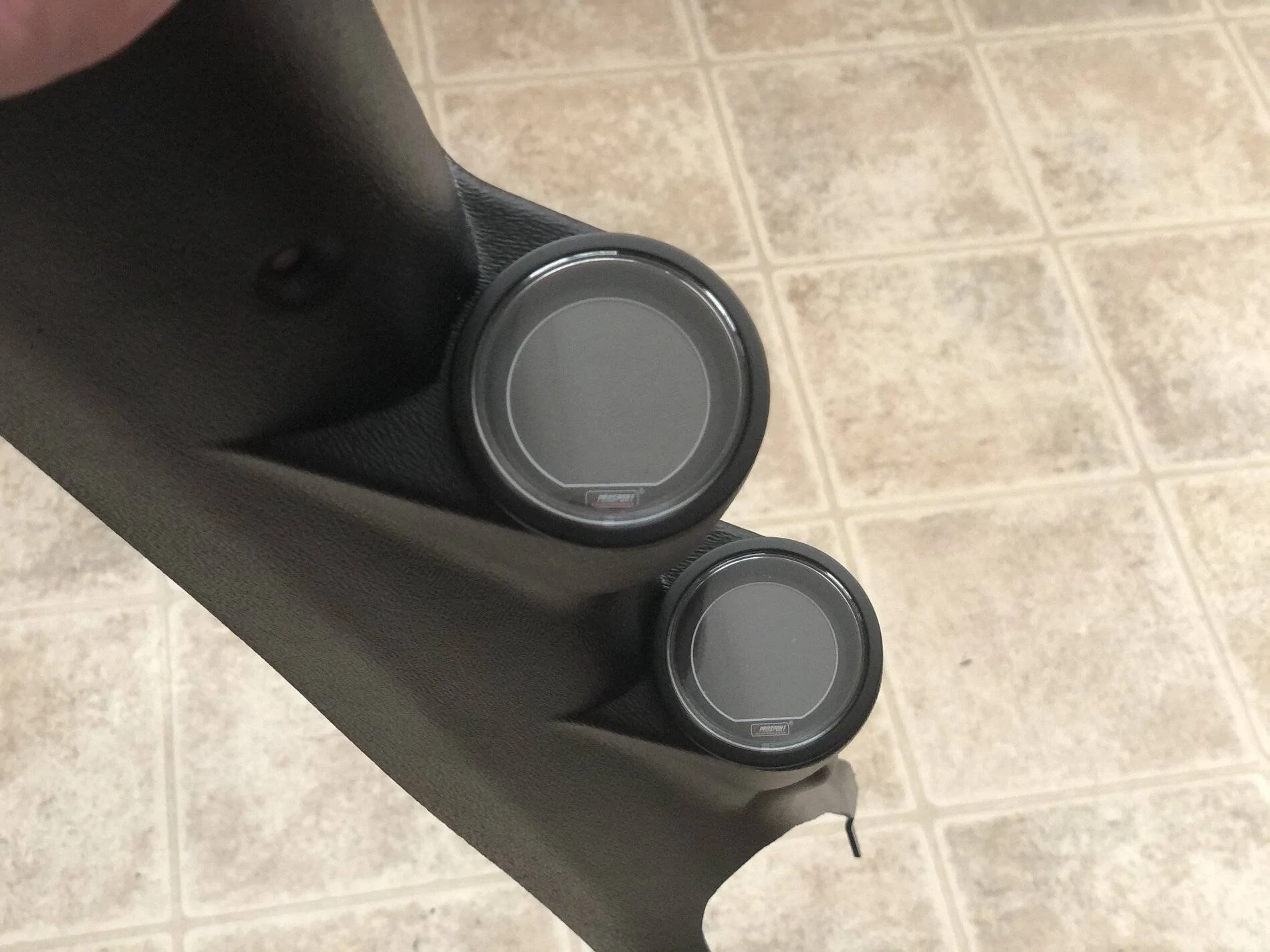

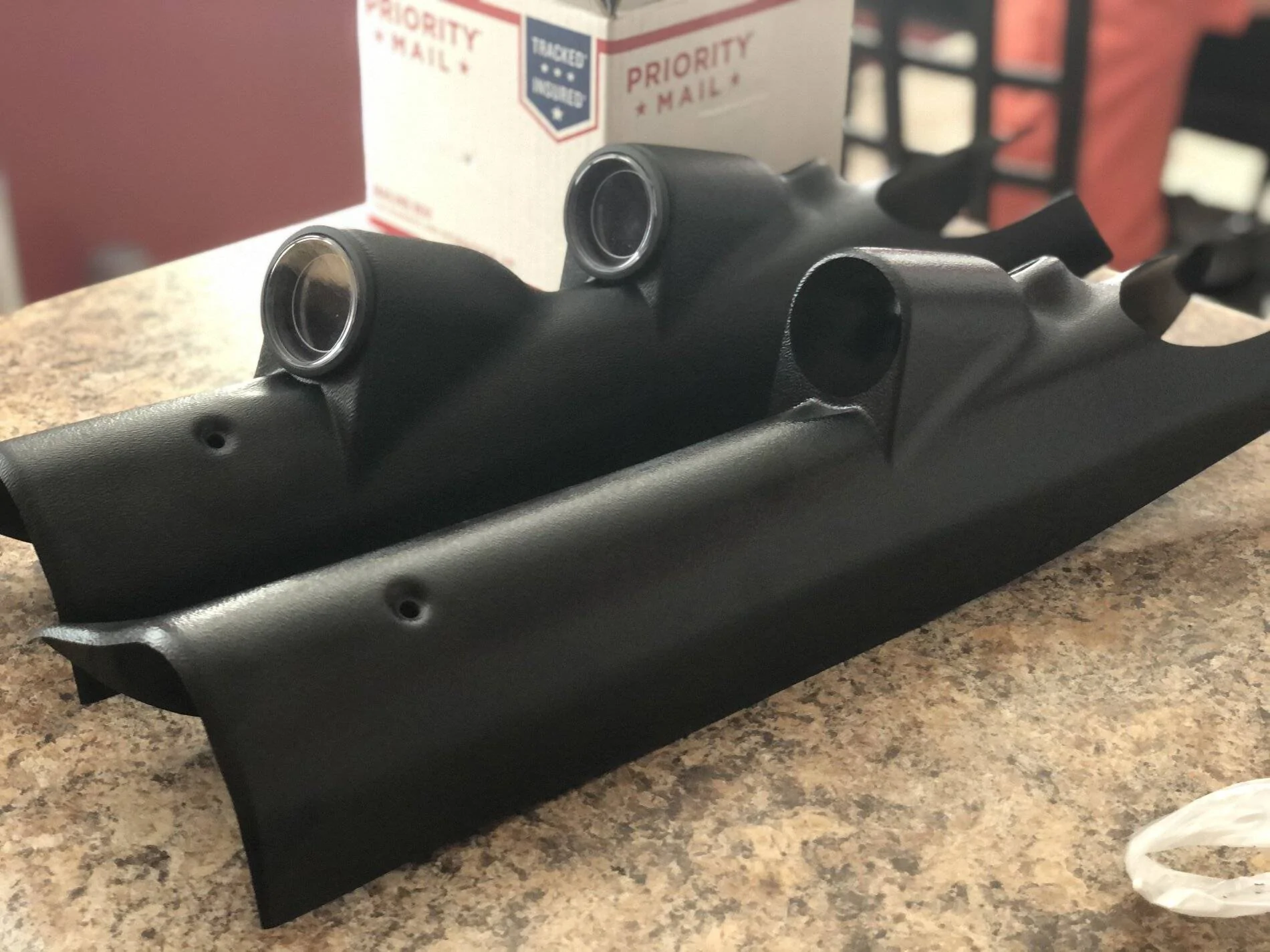

This is for my wife’s Ecoboost. She just wants them for show. I’m putting a digital boost and digital oil pressure on her pillar, at her request. I’ll be adding a single pillar pod for my water meth kit controller/boost gauge for my Procharged V6. It’s all preference.

The vacuum tree port for the booster only gets vacuum not boost. That’s why I said if it is the brake booster hose it will not work. That is not the brake booster port being used. in both pictures it is not the booster port.
