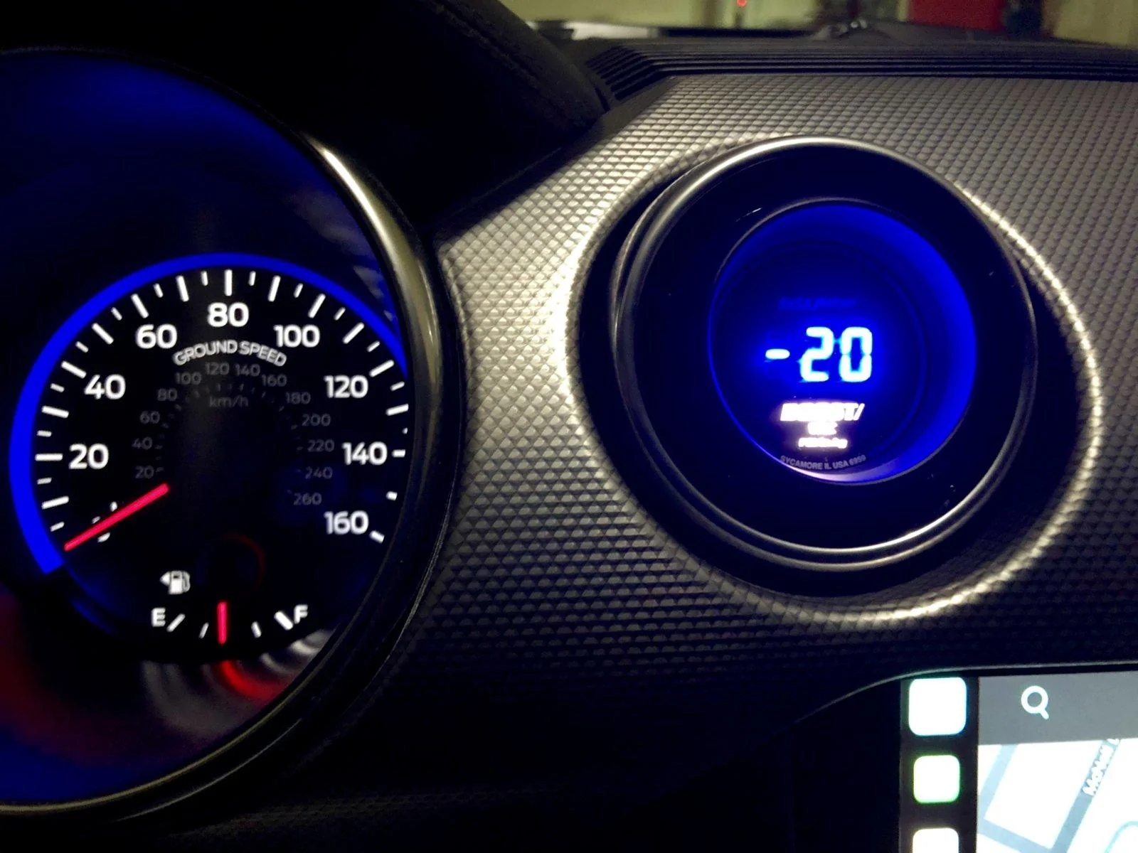

What electrical boost gauge are you using?
Thats the attometer digital cobalt series boost gauge, it's 52mm or 2-1/16" if you measure it in inches, the standard gauge size pretty much. It works pretty damn good and easy to install, only need to run a switched 12v to kick panel, ground, and dimmer to headlight switch. The MAP sensor itself is plug and play
