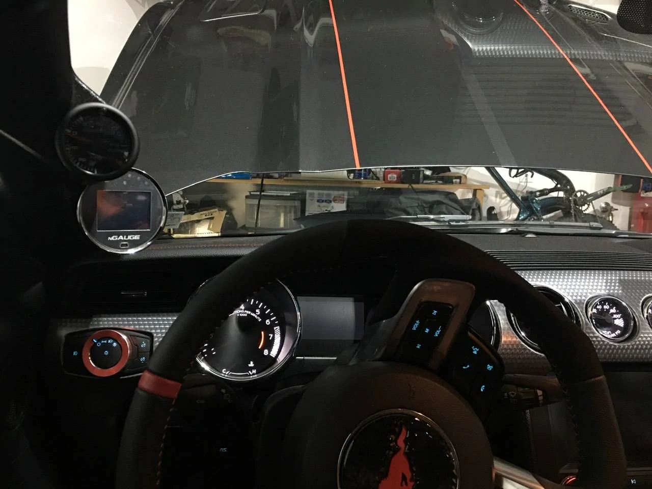

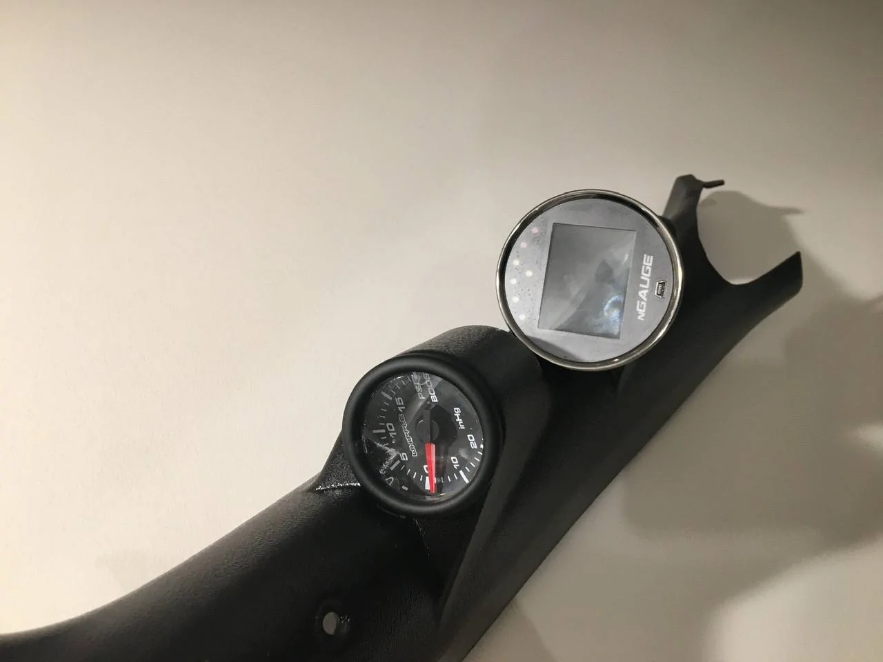

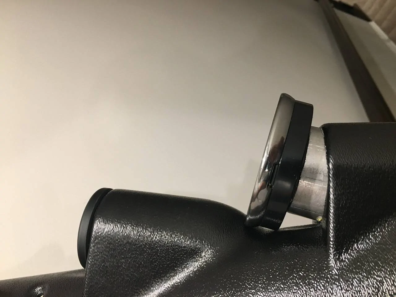

I chose a double pilar pod from autometer and put the whipple mechanical boost gauge in the top and made a custom adapter for the nGauge on the bottom slot. Both are eye level for quick glance.
Going to use the auometer led dimmer source that supplies a pwm output specifically for gauges.

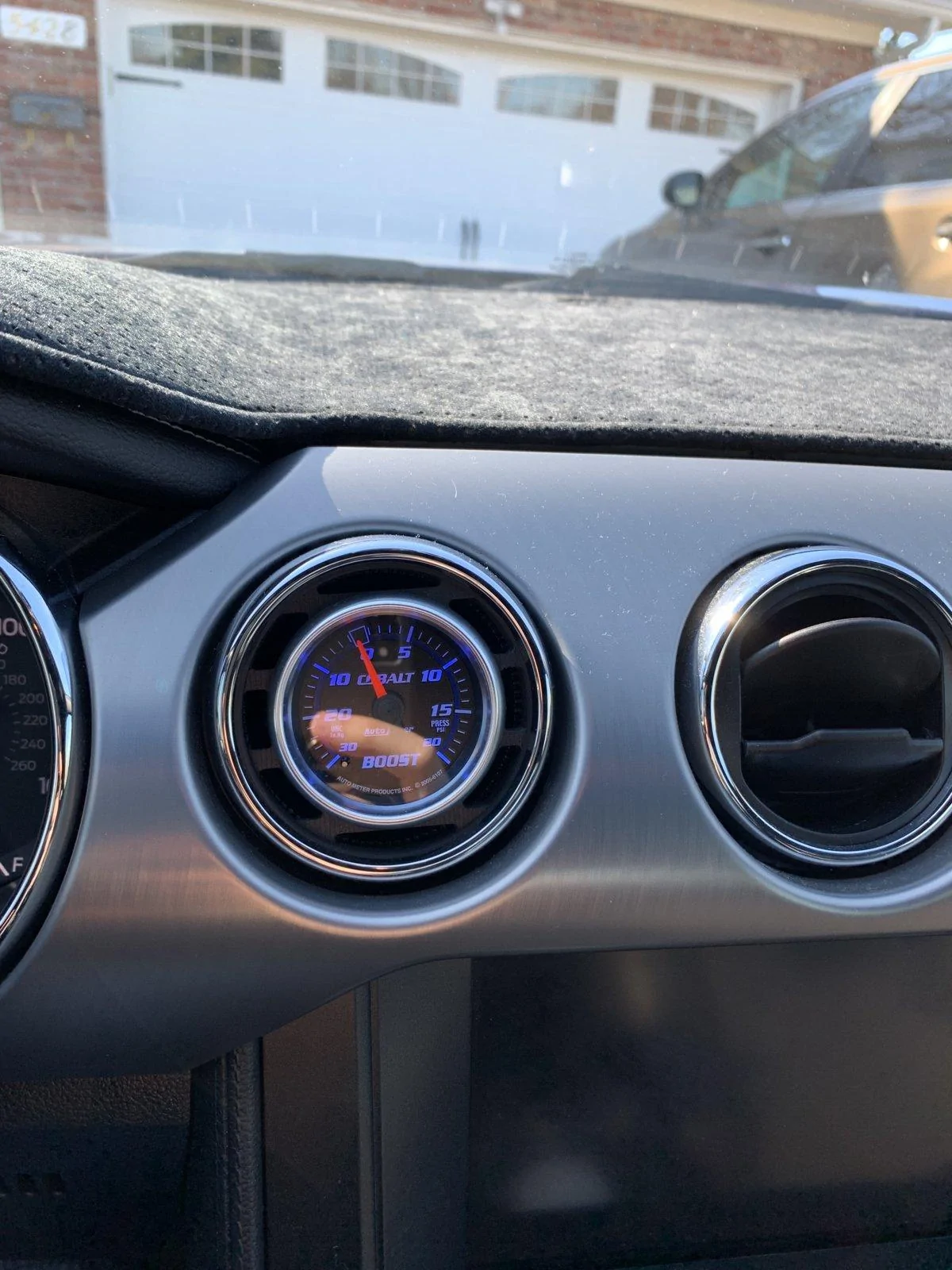

Same as @Kona 18 for me but with a mechanical Cobalt gauge. I designed/printed my own gauge holder to I could have it angle towards me for better viewing.
Looks awesome!! I have same gauge, but went w autometer pillar pod.. what wires did you tap into to get illumination with head lights on??
