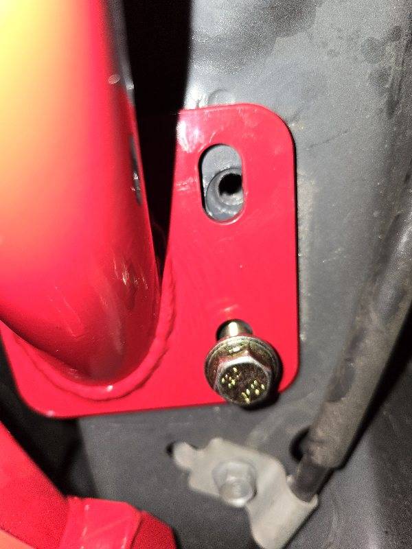

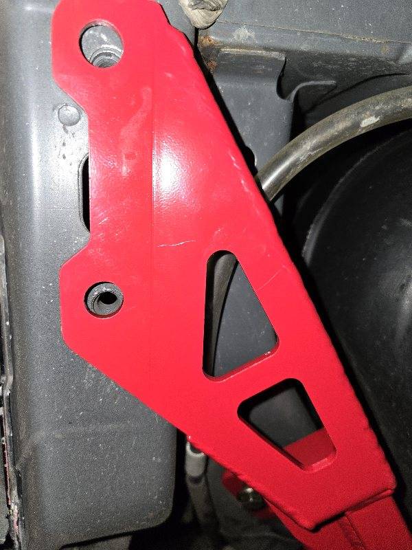

So i picked up the BMR rear bracing kit as well as the steeda alignment dowels. After fighting with my apparently horribly factory aligned IRS, and one cross threaded sub frame bolt later (took me an hour to carefully retap it) i managed to get all 4 subframe bolts in and centered.
The passenger side lock out however, one of the 2 little bolts doesn't line up.
Went to get my front braces on, again on the passenger side, neither of the smaller holes line up.
I know my irs is perfect now with the alignment dowels, so I have no idea what Else it could be other than manufacturing errors.
The car only has 15k miles, no accidents, so no way the frame/chassis should have gotten tweaked.

On the braces, did you keep the braces loose at both ends and try starting all the bolts first?
No but i can try that today. Had to call it quits at 11pm yesterday after this project kicking my ass lol.
My wife had a good laugh at my "two hours at most" install haha.
Im just really concerned at how much that rethreaded hole with hold. I messed it up pretty bad before i decided to fix it. I torqued to 115 and called it there. I'm probably always gonna worry about it ripping out now 😂

I feel you there. I didnt cross thread mine but i sure could have. Front driver side didnt want to line up at all. I had to leave all the others very loose and put my foot on the rear driver tire and really shift the car over to get it in.

Well for one thing it's not the car as they are drilled and welded in a fixture or jig. This is an easy fix for you. If you are keeping the suspension pieces, I would carefully mark the hole locations then file and elongate the holes in the new brackets to align with the factory holes. Install new washers to secure the bolts and you should be good to go.

I just finished this exact project last night. Initially it looked like I had the same problem. Went back and had all bolts loose, allowing play on the subframe long bolt, and all went well. Biggest headache was the alignment dowels.

As mentioned above, anytime you have an install like this, it is best to start threading the bolts in and keep them all loose until it's aligned. And then snug everything down.
Now, the BMR parts could still be out of tolerance, but you won't know until you do the above.
Also, ad mentioned above, you could elongate the holes on the parts and add a washer (if needed) to get them to fit. Looks like BMR has already taken this liberty to some extent by looking at your pics.

Ya i came across your post yesterday lol. I got it all together though. I ended up taking the small gold dowel thing off the back bolt for the front bmr brace and got everything all lined up.

Been their done that. Those specific braces are like 2 degrees off on lower portion angle. BMR gave me replacements, still the same issue as you. I used carbide bits and honed to get bolts to fit without stress. Been running them for two years no issue. I think if I had a chance to do it over, I would try Steeda or another suspension company parts. But, I replaced my front lower steeda sub frame k brace with BMR due to steeda rear two bolt ends hung way to far down and I was afraid of popping then when driving over high speed bumps etc. But, on the BMR k brace, I did have to hone out the Rear two brace bolts to get the bolts to install without induced stress.
