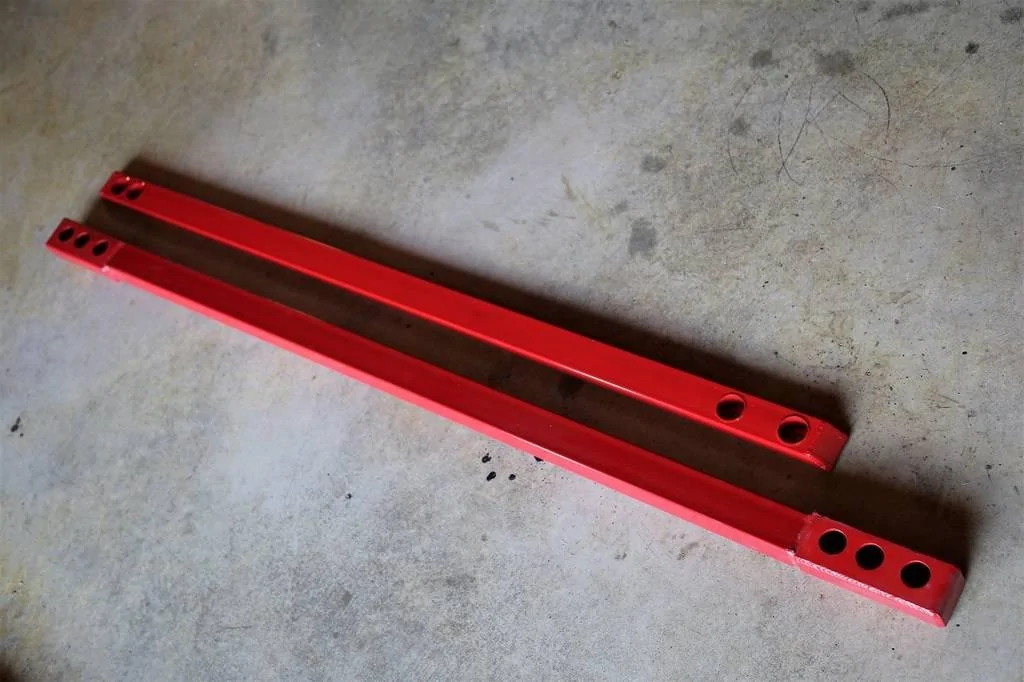

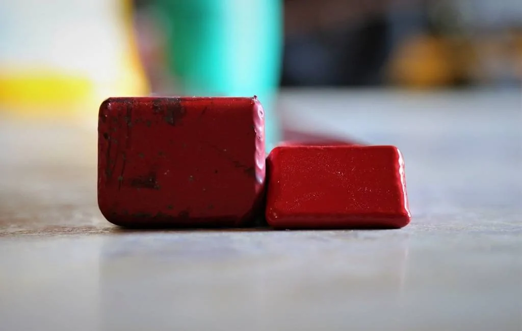

Ordered a set of these last week and they came today. If it matters, I have the first generation BMR rail on the car and have been very happy with them. They are the epitome of robust and normally, I wouldn't have it any other way. Some might argue that they are overly beefy.
After swapping out the factory 35's for some 30's I lost a measured 3/4" in diameter and as such the ride height went down 3/8". I only recently noticed what that meant in terms of clearance when I pull my car up/over/down my floor mounted low rise lift. The larger, boxed ends on the first gen BMR rails were scrubbing the rubber mat atop the lift. No biggie, hopefully they will work for somebody else, as I'll be installing the lower profile rails when I get a chance. Just holding them in your hand you get a clear feel as to how light these new pieces are in comparison to the old. As always, the welds and construction are first rate.

They are compatible with any S550 but for anything else it'd be cut/weld. I'm talking to a local guy that has a GT that would like to try them but if he decides he doesn't want them I have a couple of projects that are in need of some square tubing...

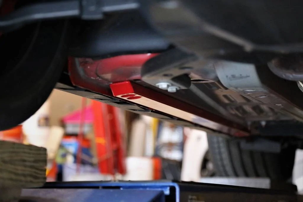

Had an opportunity to get a few things done today including adding the latest "Super Low Profile" jacking rails from BMR. I've had the standard chassis jacking rails from BMR (CJR001) since my car was new and have been very happy with them. But once I lowered the car with some different rolling stock I noticed that the boxed ends of the rails were making contact with the top of my low profile scissor lift each time I drove over it. I needed to gain some clearance back, especially if I'm to use the FP springs which lower the car almost 3/4". It'll be close.
The latest rails, CJR002, are a little shorter than the CJR001 rails and the profile is much shorter as well.

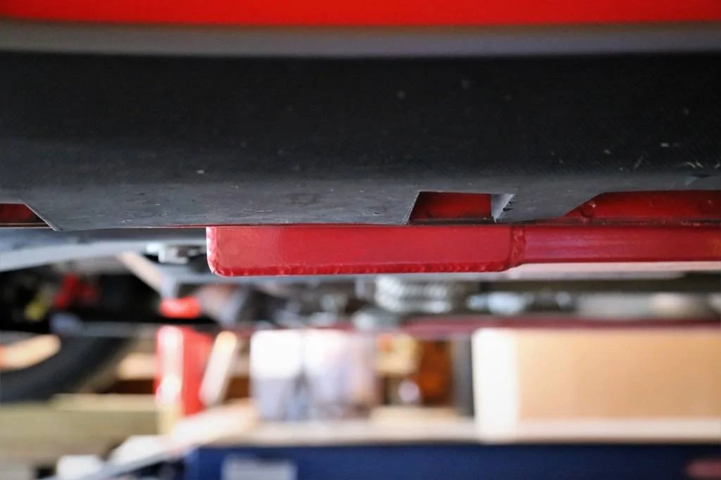

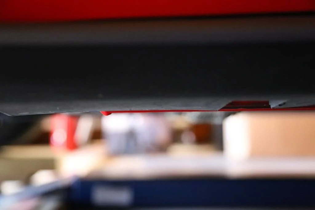

The CJR001 rails hang down a bit below the pinch rail.

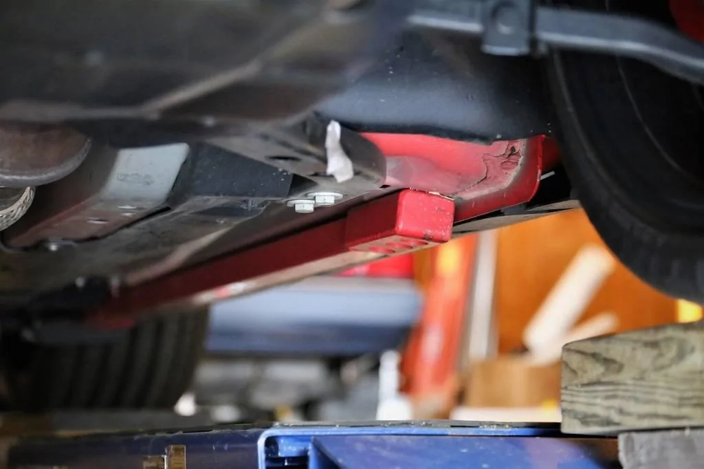

With the passenger side swapped to the new low profile rail and the older, CJR001 still in place on the driver side, a comparison...

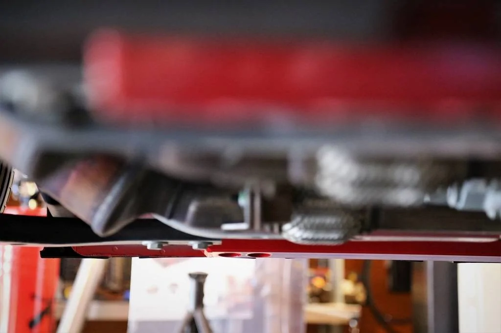

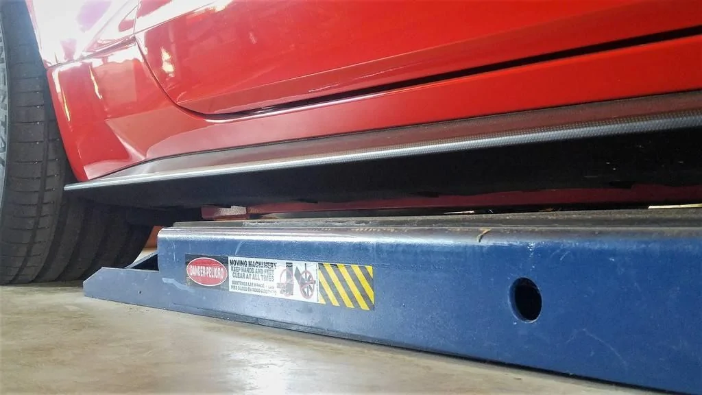

Aside from the small plate welded on the end, the full length of the new rails are from 1/16" to 1/8" lower than the pinch rail, exactly what I was looking for. Thanks again for offering even more choice Kelly. I'm very happy with more clearance and less weight that the CJR002 rails offer.
