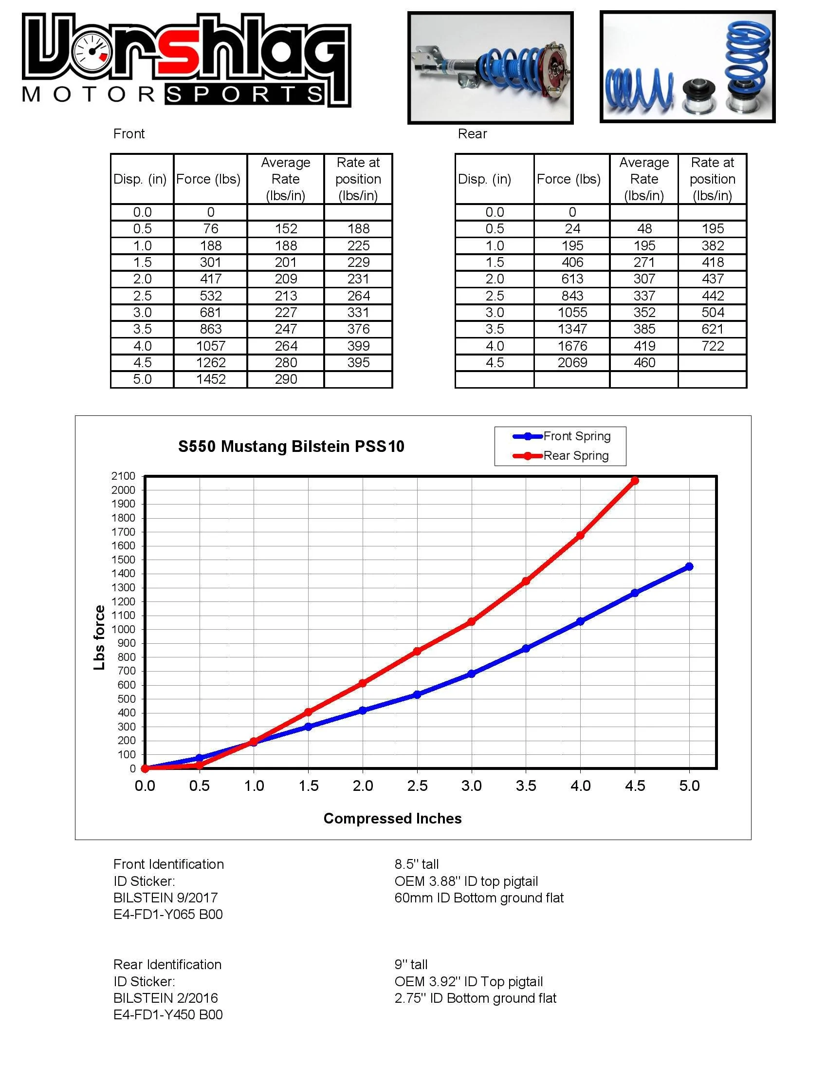

It appears that Vorshlag did test the spring rates, with the results below.
“We rated the springs from this Bilstein PSS10 coilover kit on our digital spring rater. These have rates of about 375# front and a progressive 500-725# rear. The front is stiffer than the GT350R, but the rear starts softer and progresses up to a similar rate. This should make for a nice, street friendly, occasional track set for 2015+ Mustangs.”
Yeah but the OP wasnt talking about the PSS10 coilover..

Appreciate the insight! The spring rates of the PSS10 are “about 375# front and a progressive 500-725# rear” per Vorshlag. What I am trying to decipher is which is the better purchase (value) B6 with springs of choice or PSS10s. As they carry a very similar price point.
