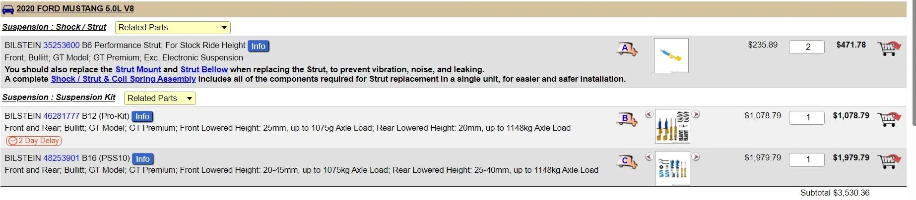

The b16 we again don't know spring rates. And despite being adjustable it's likely valved harder. Unless you're just itching to drop 2k to find out, stick with the known entity.
I don't think its fair to assume its valved harder, we literally have nothing to base that on. Steeda only publishes spring rates anyway, its not like we know anything about those dampers either.
The B16's big advantage is that its 2 way adjustable, I don't see that offered much for this car.
Looking at the Bilstein offerings which I plan to go with at some point. Is the B6 setup with choice of springs a better option than the B16 coilovers they offer? Both end up pretty close in price which is interesting given that one is a coilover setup.
Buy B16 if you want to be able to adjust the setup, buy B12/B6+springs if you don't. It entirely depends on what you want/need. In my case I'd never do B16 because I'm not likely to ever adjust it much, I want a setup that is a known upgrade over stock and that's it. If you want to be able to dial in a very specific feel then the B16 is more your speed.
Unless you're reading something I'm not it's a single adjuster. That effects the bleed in both directions.
Anything valved for 350 is almost guaranteed to be valved harder than one built for 200.
I see that now, I took adjustable rebound and compression to mean two way adjustable.
in a sane world (eg. Motorcycles) that is the case. In cars, marketing has fewer scruples. Or doesn't know what the words mean.
