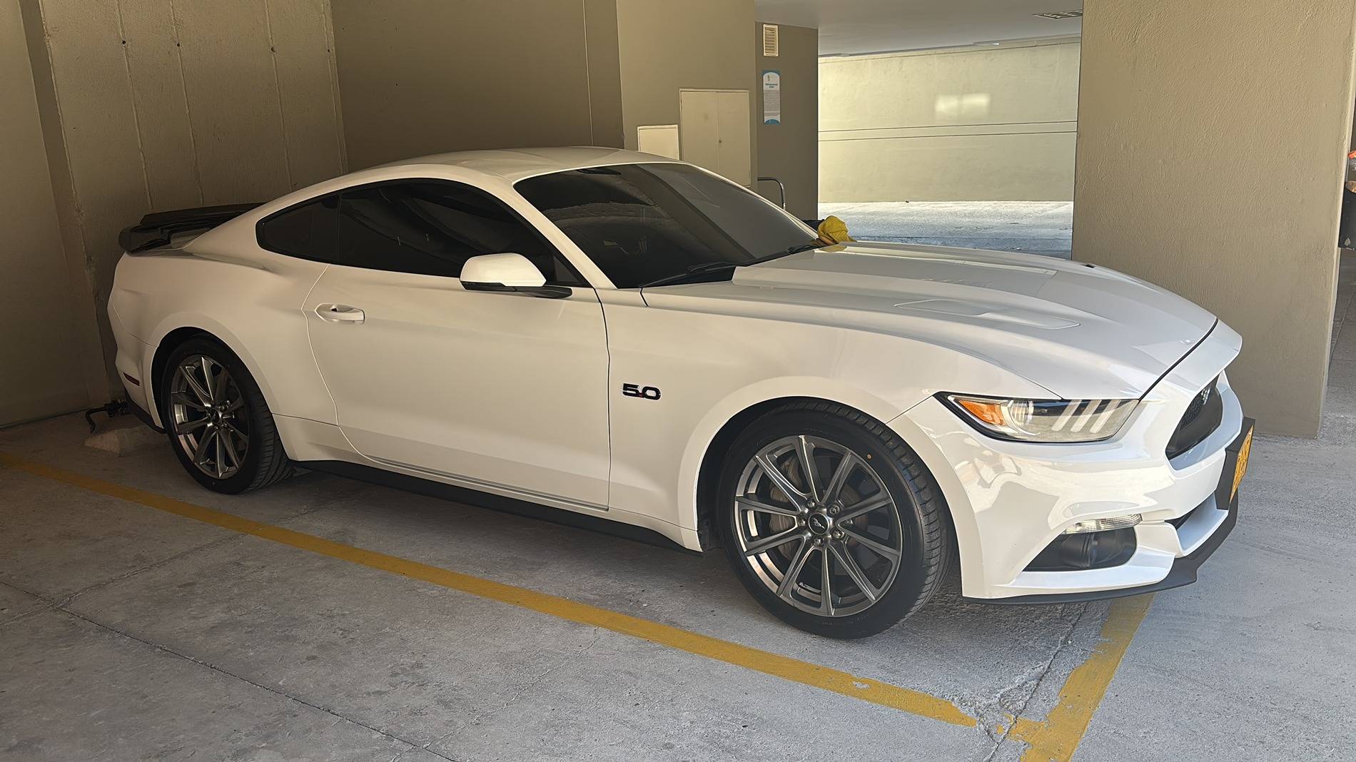

Why GT350 springs and not R springs? Is it the height difference?
Right. The GT350 is 10mm drop 211lbs/857lbs and GT350R is more. This is how my 2017 sits with the GT350 springs and 255/40r19 squared. In the rear I barely see a difference.. and the shop said they clocked the bushings. Its good bc the roads are very difficult here. I'm thinking about doing 275/40r19 squared to bring it up with 8mm sidewall and fill the wheel wells more.
edit: I think the drop isn't much in the rear because the GT350 came with staggered wheels and are a little taller in the back.
