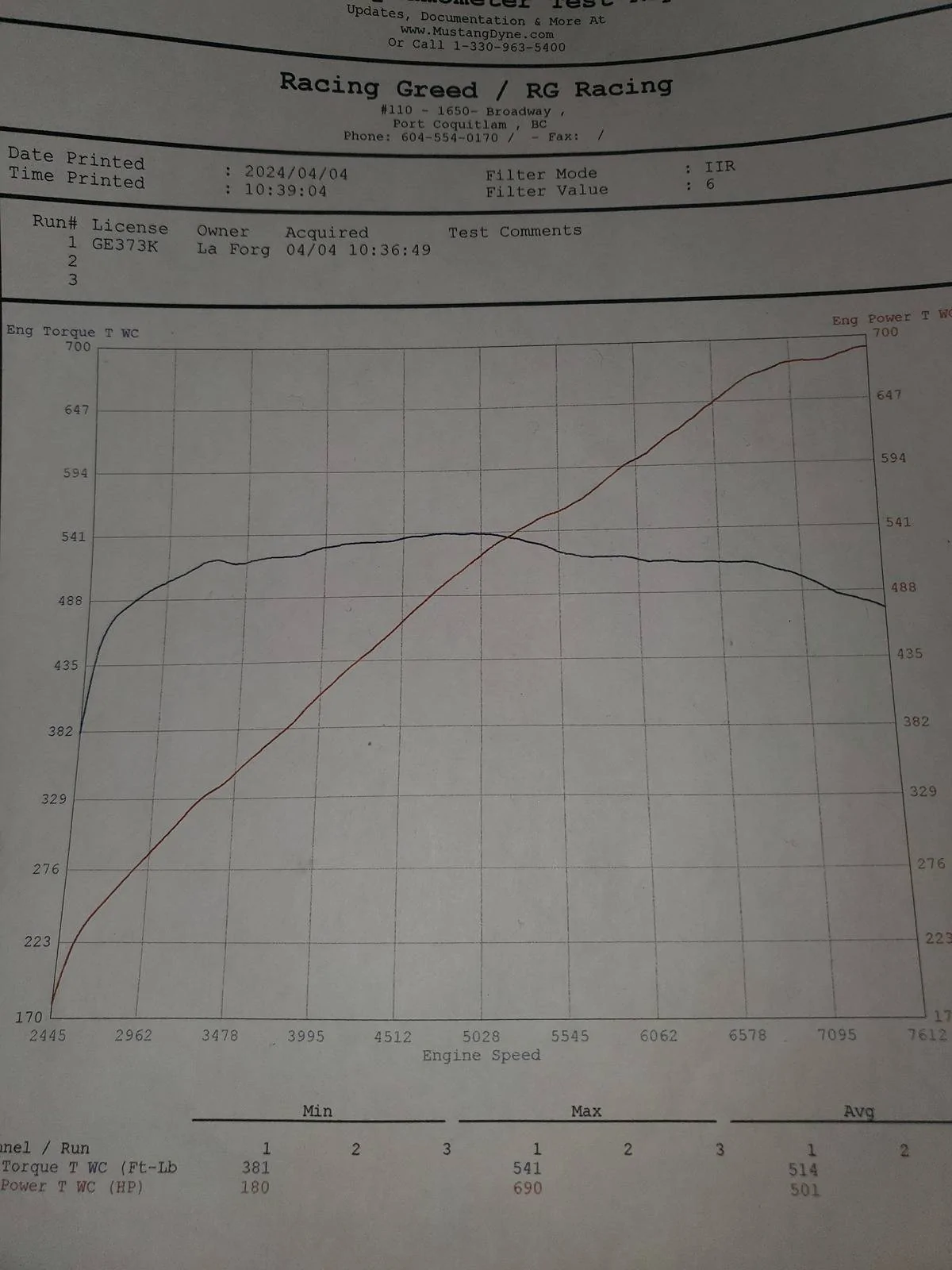

Just wanted to update my issues with tuning Whipple Gen 3 2017 6R80 Car.
As said earlier I had an idle misfire, some pedal hesitation, odd bucking on shifting in Sport mode. Also some extended cold start issues. Also was getting revisions that seemed to be for a totally different car. One revision locked my Trans in first Sport mode. Which I had to prove by putting in an old tune. Of course no apology not a peep from 'Lund Calibrator' who wouldn't ever tell me their name.
'Lund Calibrator said "don't use Paddles for shifting" only 5 percent of our customers use the paddles. Huh? Also said it couldn't be the Lund Racing tune. Lunds tunes are tried and true. I spent thousands of dollars jumping thru Lunds hoops during the 8 months of endless emails, revisions and stress.
Well I went and got a new tune. A base Whipple tune modified for fuel system, injectors etc.
From a shop up here in Canada.
Was hard to find anyone on the west coast to tune it cause of the Whipple I guess.
Anyhow this shop Post Haste Performance tuned it.
I no longer have any idle misfires, pedal lag, hiccups under load or bucking when using the paddles in my 6R80.
Drivability is substantially better than Lunds tune. Also gained 16 RWHP 6 RWTQ.
So all those months where Lund blamed my car and at the end started personal shit aimed at me saying I shouldn't use the Paddles and that I didn't know how to drive a blown Coyote is all BULLSHIT!!
My car runs fantastic now without any issues AT ALL!!
So take from this what you will. It's just my personal experience with Lund Racing.I haven't done any logging on this new tune but considering what I've been living with for close to a year I haven't found a reason to yet.
