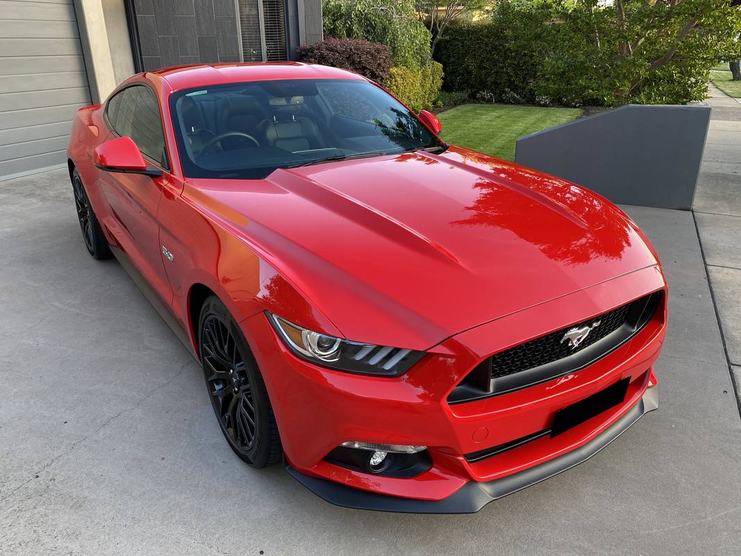

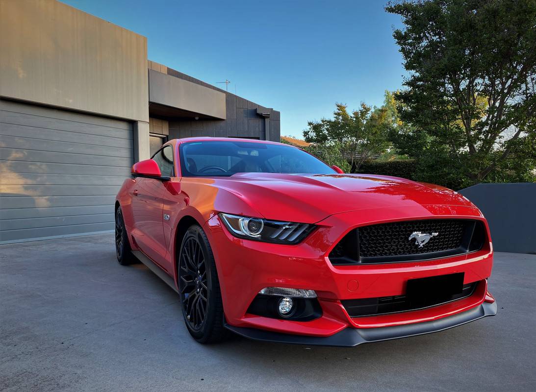

Collinite 845 is one of the best waxes ever created. I have used it on and off for a number of years, returning to it after a trying a variety of spray coatings. Collinite 845 will give 6-8 months of protection, although from my experience, for a garage queen you can expect longer.
I use a D/A polisher with a finishing pad to apply, although it can also be applied with a foam pad. The most important thing with this product is to apply it thinly, done so it will be a breeze to buff off. Also, in cold climates you may want to run the bottle under hot water to liquefy the wax, it will otherwise be gloopy. After about 12 hours, 845 can "sweat" as it cures, leaving a few streaks here and there. This is normal and will disappear after the first wash.
For me, I love the process of applying wax so longevity is not an issue. I also love how wax makes paint look, it just looks different to modern coatings. It's often described as a "warm glow", whatever it is, I love it. (The pics above are not edited or filtered so as to give you an idea of what it looks like.)

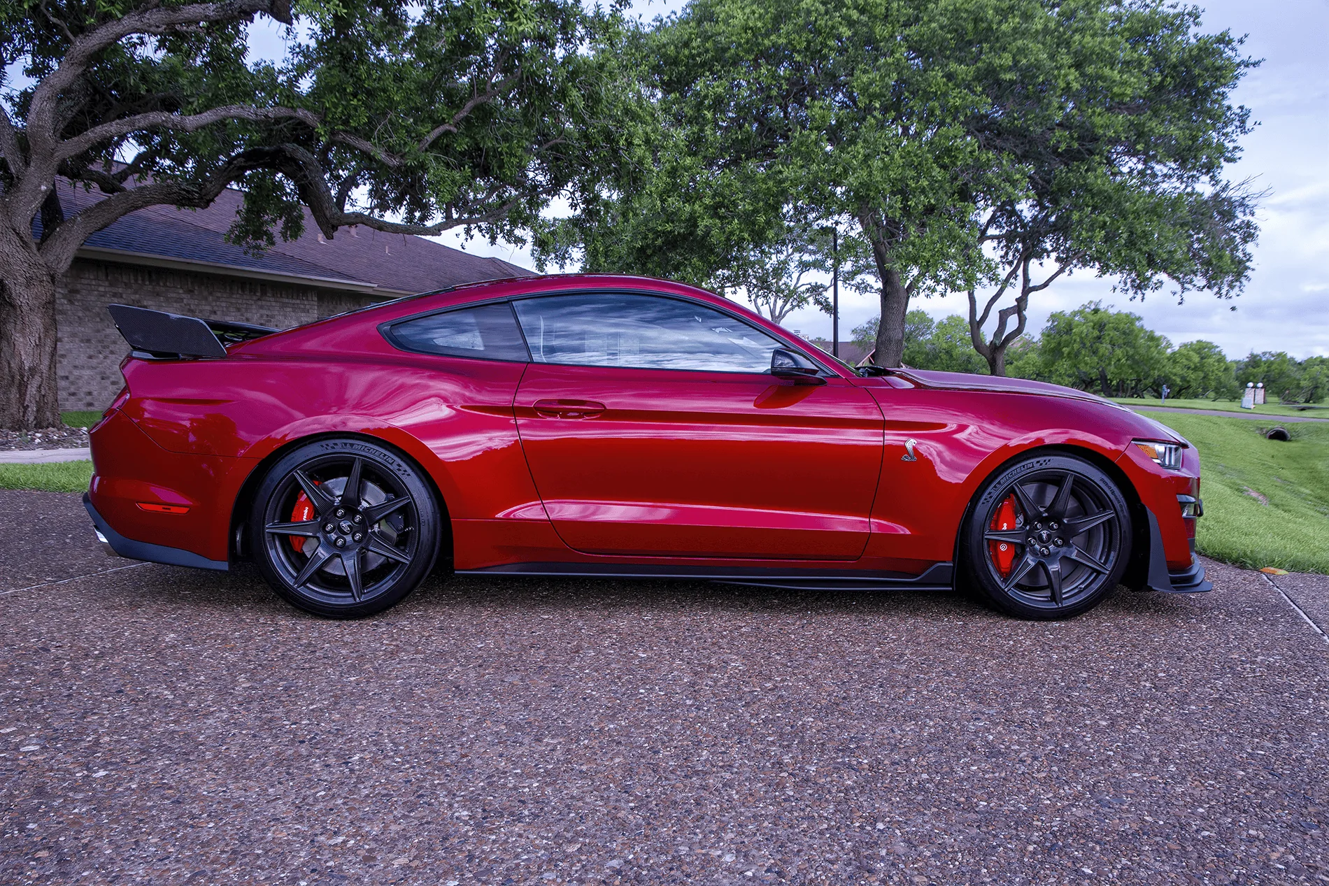

kilobravo
Aug 10, 2019
95
8,736
8,861
Corpus Christi, TX
kilobravo.com
KB
'16 CT6, '18 SD, '20 GT 500
..maintaining the finish takes little time.
I had to laugh at that one, Greg, no offense. I spent the better part of ten or eleven days masking, polishing, and ceramic coating my Mustang. :-) Maybe I'm just slow. <chuckling>
