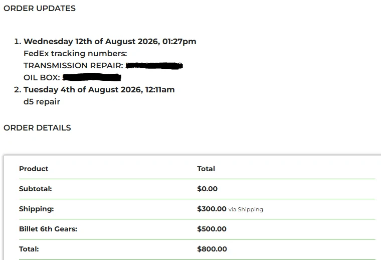

Well, it's finally getting shipped back to me. I still need to go pick up a new starter and a new rear tire....... :curse:

I received the transmission on Monday, they actually surprised me and sent the trans fluid as well. Currently waiting on a new starter to arrive. I reached out to the local dealership and they said it was going to be $677 for a new one........ F you..... I got online and ordered one and it should be here next week. The online starter with tax and shipping was $408.....

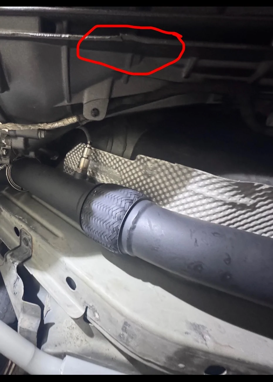

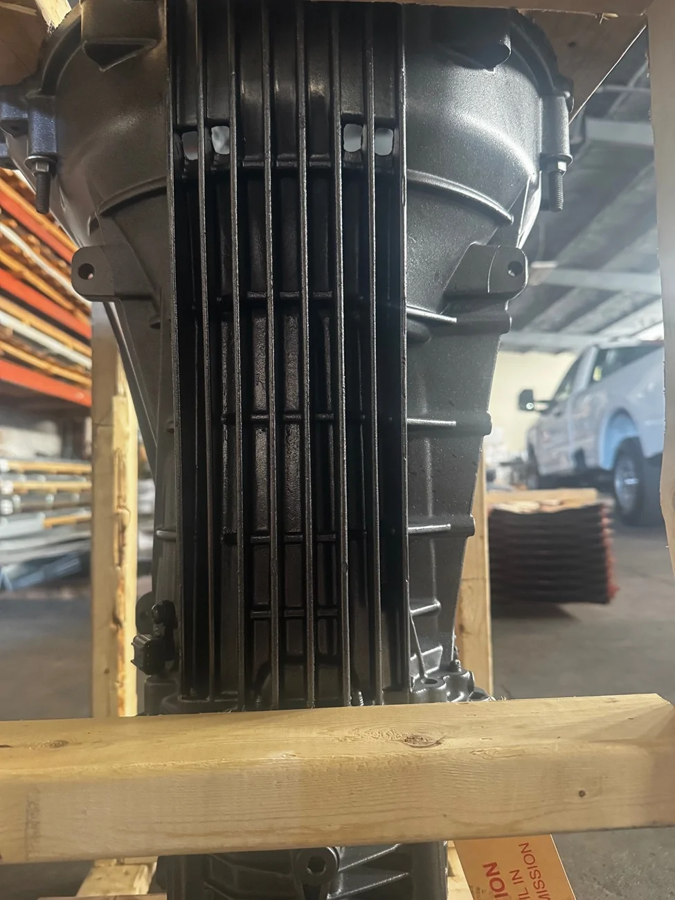

There is one thing I am curious about. It is not the same transmission that I sent them. In the pic with the red circle you can see the cooling fin was slightly damaged. That happen during the shipping to me when I first received it.
This trans does not have the same damage on it. I’ll have to ask and make sure I got the same Level 4 that I paid for.
How are you going to go about verifying that it has what you paid for inside of it?

They probably just built you a new one and used the one you sent in as a core. Thats how engines/trans usually work

I would put money on them sending you the correct transmission. I don't think Calimer is a shady outfit. When I had questions about mine, they got right back to me and reassured me that I had just what I ordered and let me know that if I needed anything different, they would send it right out to me My question was about the output shaft being 2" long and I thought it was only supose to be 3/4" long. I was wrong. Good luck with the rest of your build. I think Calimer always send the fluid with the transmissions. They sent mine with fluid.
Yup, standard practice. They usually have them all built up ready to go and take yours as the core. Same deal with RPM trans when I sent my C5 trans in. I got a new (to me) one all built and they took my core to use for a future build.

I'm about to ask; I do want to ensure I got what I paid for, but if this one has any issues, I'm going to have a local shop pull it apart in front of me so I can verify it has the parts in it that I paid for.
