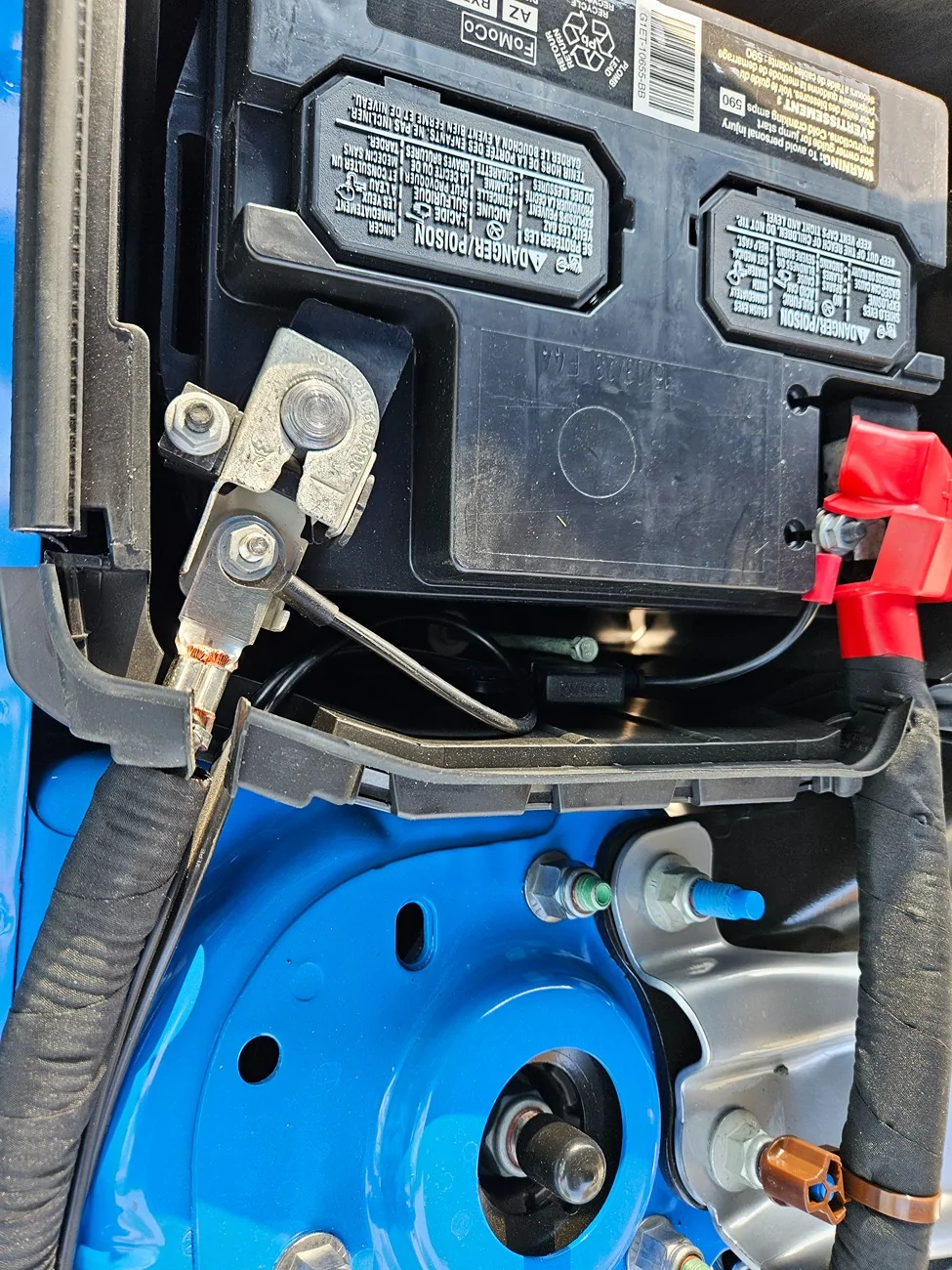

hello
I installed a Ctek CT5 TIME TO GO battery maintainer.
As instructed by Ctek, I connected the positive terminal to the battery and the negative terminal to the chassis (the shock absorber top bolt in my case).
I chose the Ctek connector that indicates the charge level. I connected it without opening the hood.

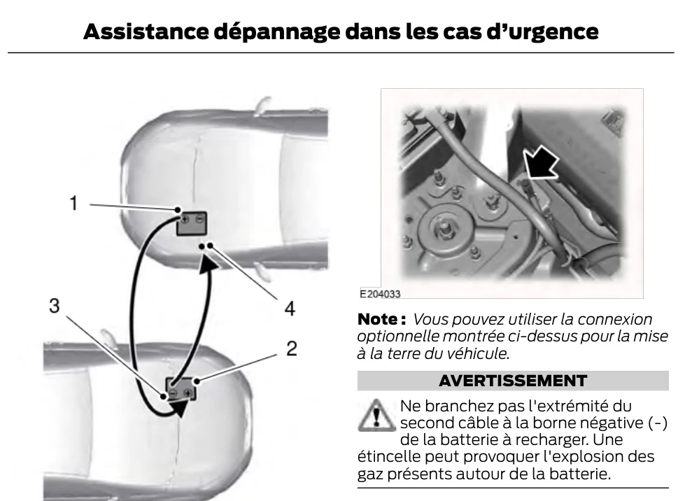

Little info found in the manual for the correct location of a ground for my Ctek or cable connection.
There is a small support where a mass is already connected to the passenger shock absorber bowl.

hello

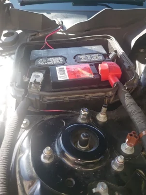

I used the short harness with the connector and put the eyelets directly on the battery.
