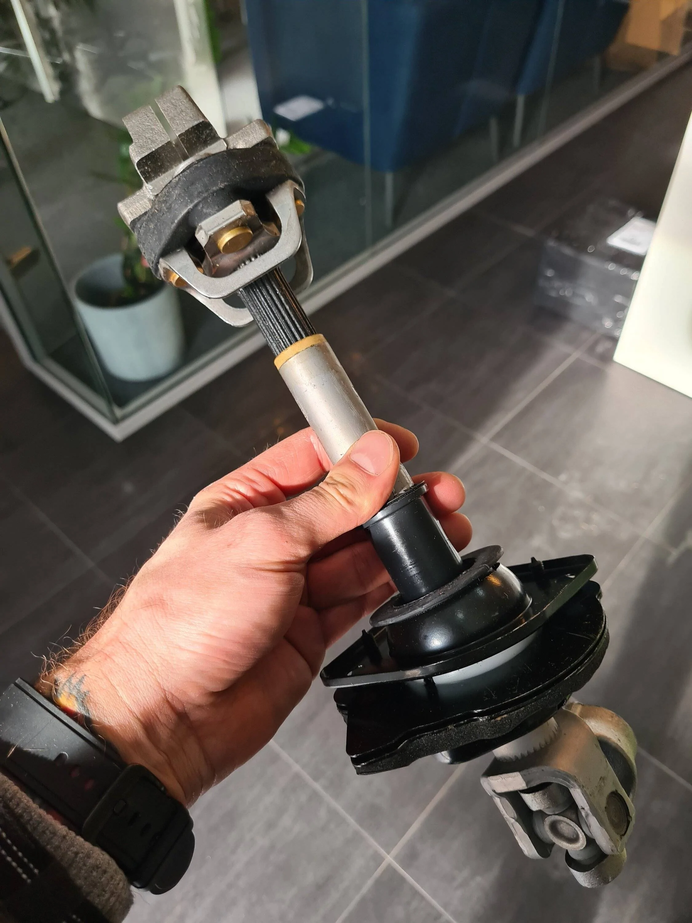

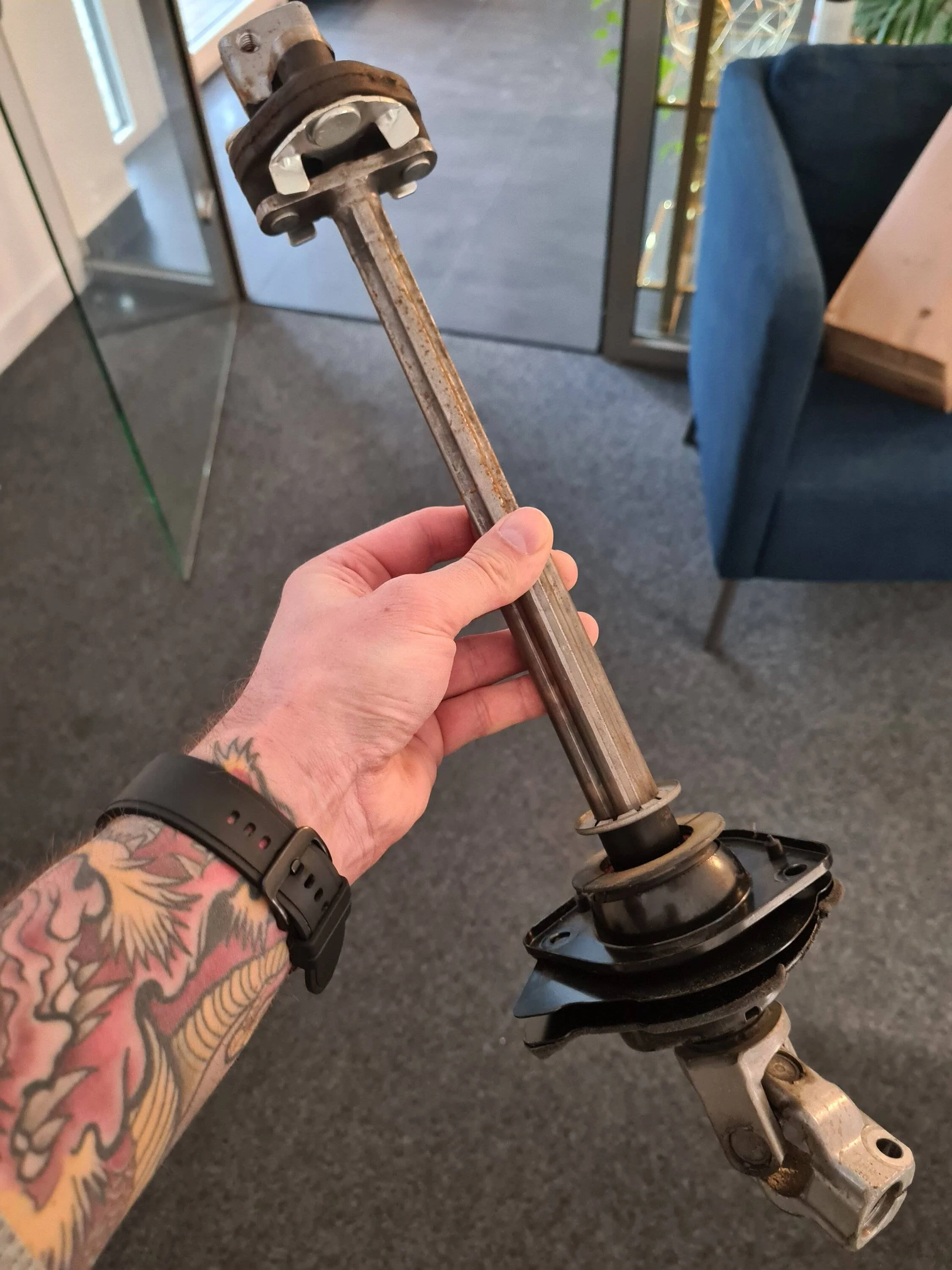

Small but rather important update from my side.
I finally managed to replace the steering shaft in my GT. Operation was succesfull, plug and play I'd say.
As per steering shafts comparison, the one from Shelby is bulkier, heavier and it looks much more rigid than the one from GT. Rubber parts are also considerably stiffer.
I attach pictures of both steering shafts for You to compare.
Now for the overall feelings from behind the wheel after replacement. Sad to say I have not observed any significant changes in steering feedback/precision whatsoever.
My conclusion is that it is possible to fix the sponginess of GT steering feel but with a proper epas calibration.
