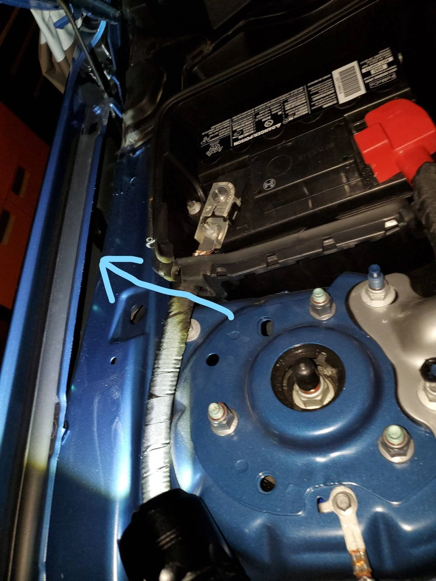

Mine was the one closest to the fender, the easiest to reach. But it was my first try, so I loosed it and tried to pull up HARD. It snapped apart, so I have the head of it but the lower half fell in a small gap where the fender meets the engine well
Any hope in hell of being able to find/ remove it from that area (see blue arrow in pic)?

You can get under there by removing the wheel well. You just have to remove the wheel then pop off a bunch of push pins.

I lost mine down that hole and fished them out by removing the wheel well lining as mentioned. very easy if you have the pry tool in the kit that Cpl0313 posted. Trying to get those dumb things out with a screwdriver is annoying.
They won't cause any problems if you don't find them though. They'll probably eventually just fall out on the road somewhere.

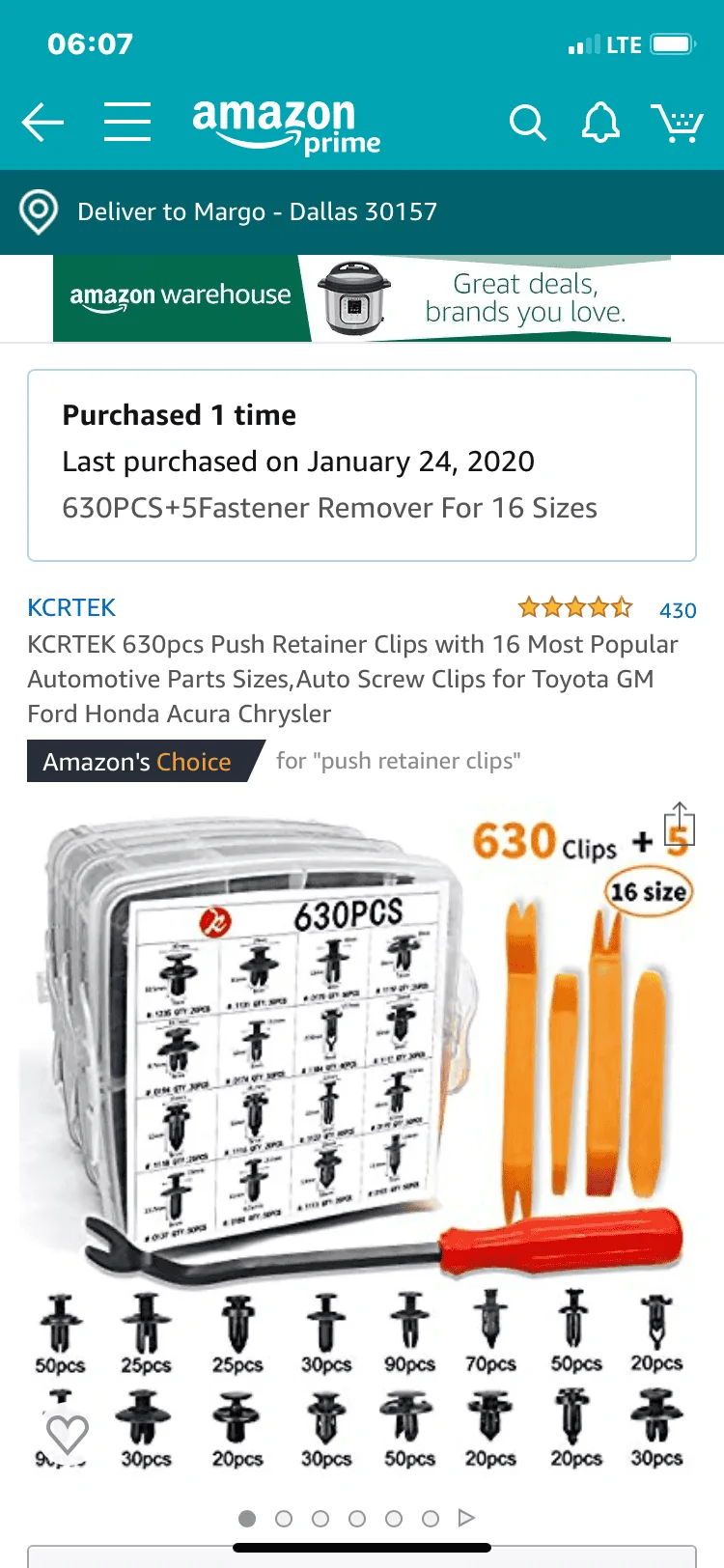

Just orders that 630 piece kit
Can’t tell you how much money I spend on pieces throughout the years. Thanks.
