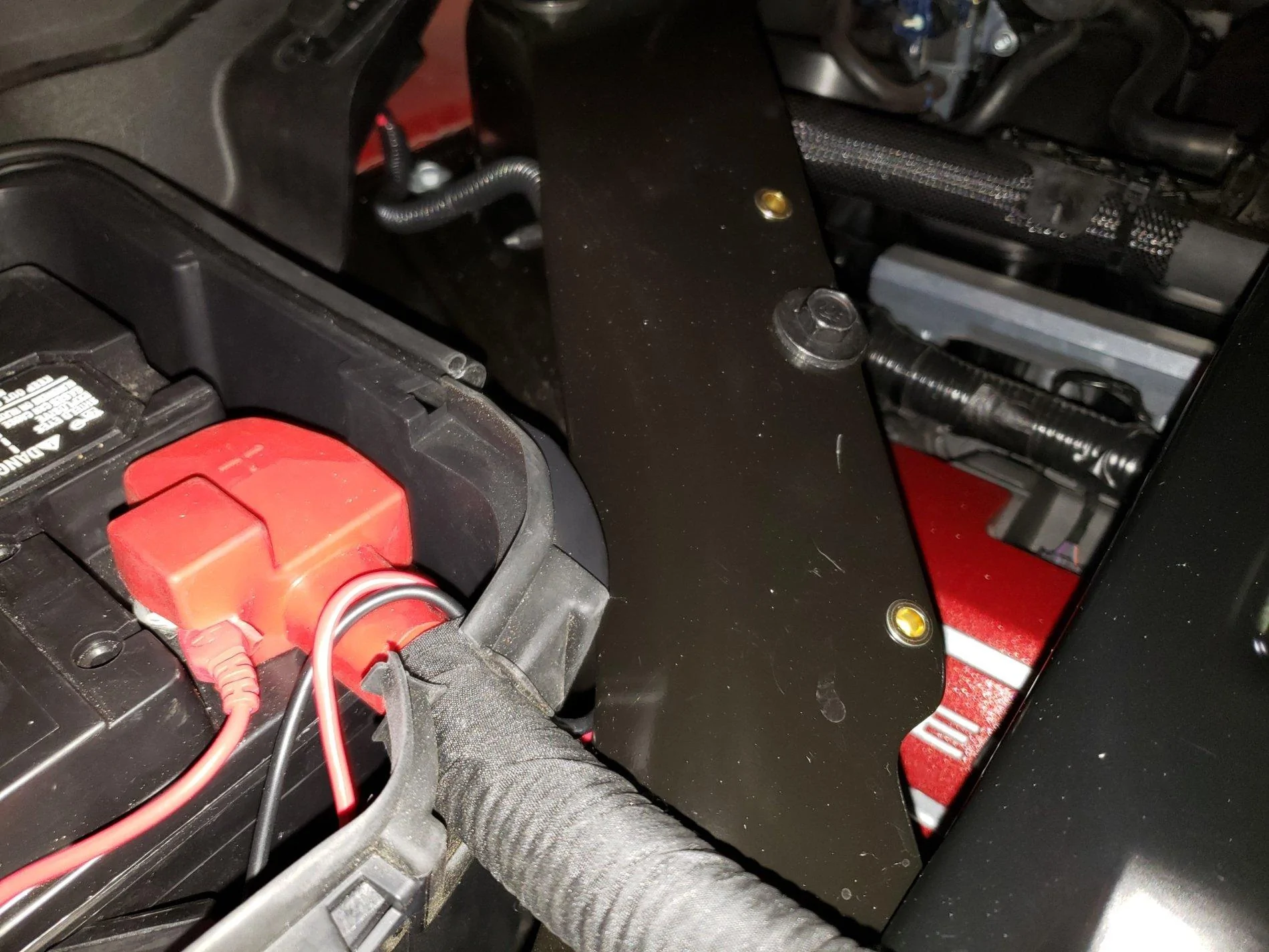

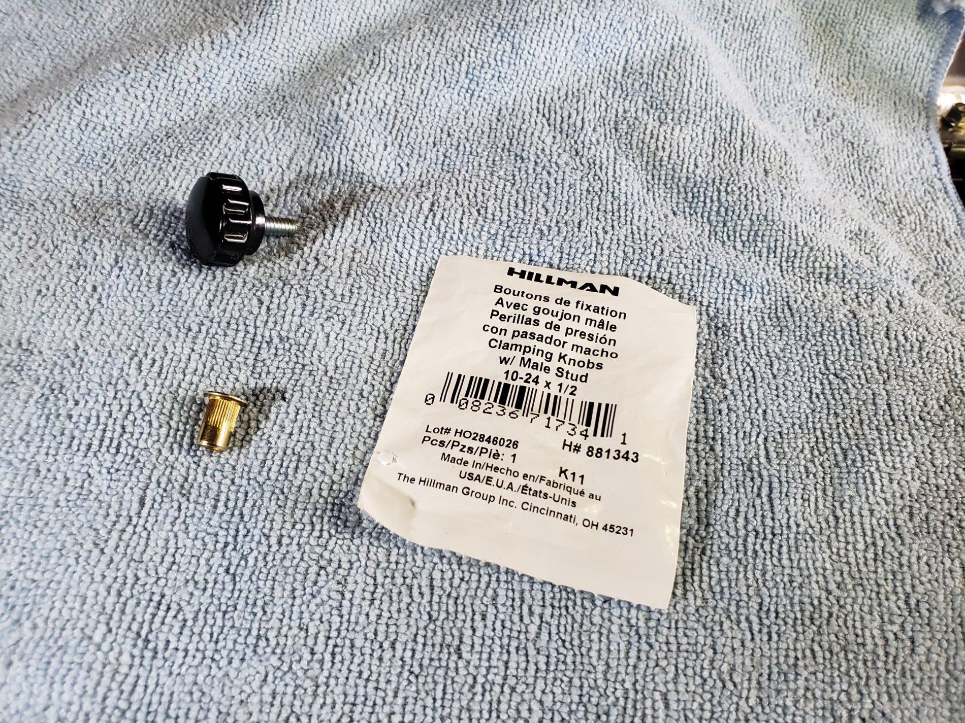

Don’t you need a special tool to install those nuts? Don’t they expand like a rivet?
Just hammer them in the holes. They have splines/ridges on them that bite into the hole edges. Looks like the photo also shows the installation tool to hammer them into the holes.
Where did you get the wingnut solution?
That's what the bolt with the flange nut is for. Thread the insert onto the bolt, hold the nut in place and back off the bolt. Effectively compressing the Rivnut like the proper tool would.

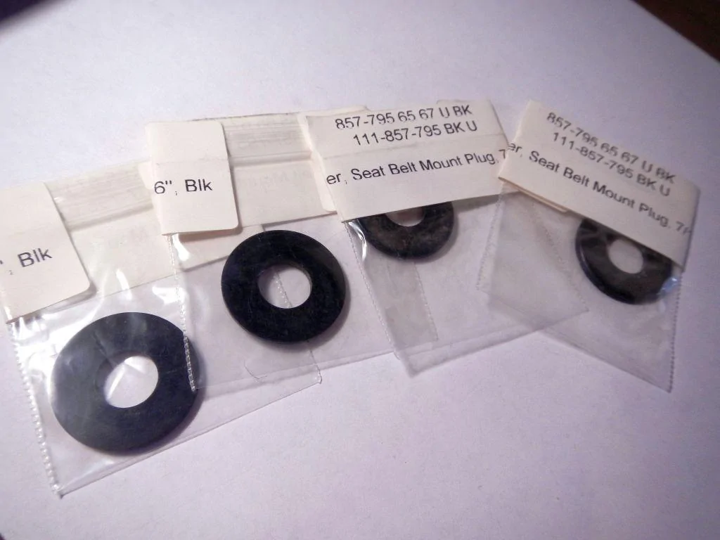

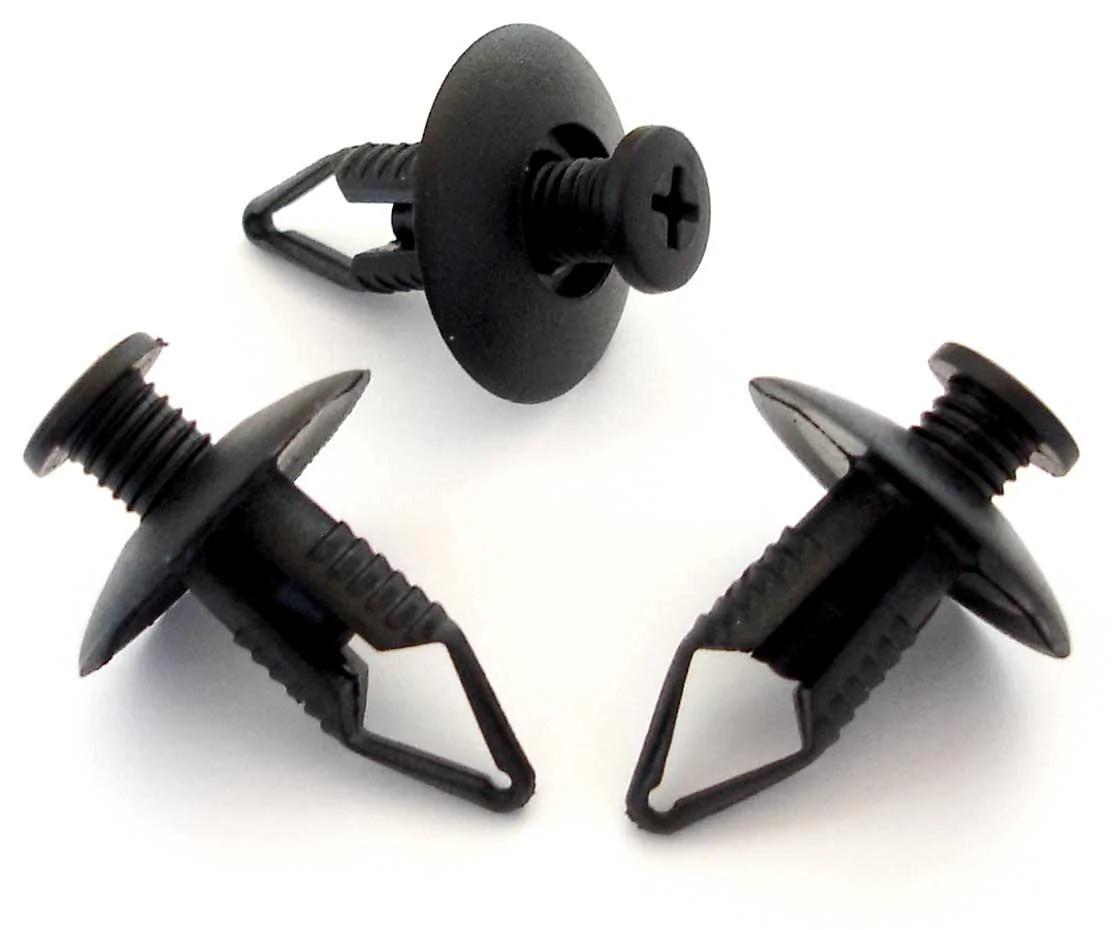

There must be another thread about these wayward little fasteners, but I haven't found it. Any road I'll revivify this one and it'll come to the top. I distinctly remember someone posting that what these need is a slim washer, since the base in contact with the battery cover doesn't cover the hole, and they tend to slip into the holes. I agreed. You want your fasteners to have firm contact with the surfaces you're trying to connect. After a few losses of the skittering plastic items, I practiced and got it down to where I was only losing one pushpin per mount, dismount, mount of the cover.
That accomplishhment was enough to spur my interest in the base-to-hole size problem. I have a number of those cabinets, some of them inherited already full, with little drawers to hold extra screws nuts, cotter pins and so forth. During a systematic review of the contents of one cabinet I came across a drawer of flat washers, among which were three sort-of-slim plastic washers that looked as if they might fill the bill. Sure enough, they did the hole-size-reducing job, so the base of the fasteners no longer could find their way through the cover's holes.
Of course during the try-outs and mountings, I managed to lose one more pushpin—and one of the washers. OH NO! Yes I did. Now I had one too few washers. Rats! Looking more closely at the washers that remained, I saw they bore a part number. Google told me it was a VW part number for something to do with seatbelt mounting. And that a used VW parts store in SoCal would sell them to me for two bucks apiece. They came in the mail today. Definitely used, with surface blemishes from some kind of friction during that use. A couple were a bit dirty. I cleaned them with Windex, and preserved/lubricated them with ArmorAll. Looking good.
I'm doing a routine installation when—you guessed it—one pin escaped into the Bermuda Triangle of the engine compartment. No biggie; I had bought quite a few for just such happenstances. Two out of three in place and snug, now one of the washers, slippery from its ArmorAll bath escapes my trembly old fingers, similarly lubricated, and falls. Down. There. I could see it on what seems like a frame rail. No way to reach it without some kind of mechanical extension, Which was successful in dislodging the washer and allowing it to pass into oblivion. But I was ready with an extra washer, and now have the darned thing fastenered and washered the way I had daydreamed it.

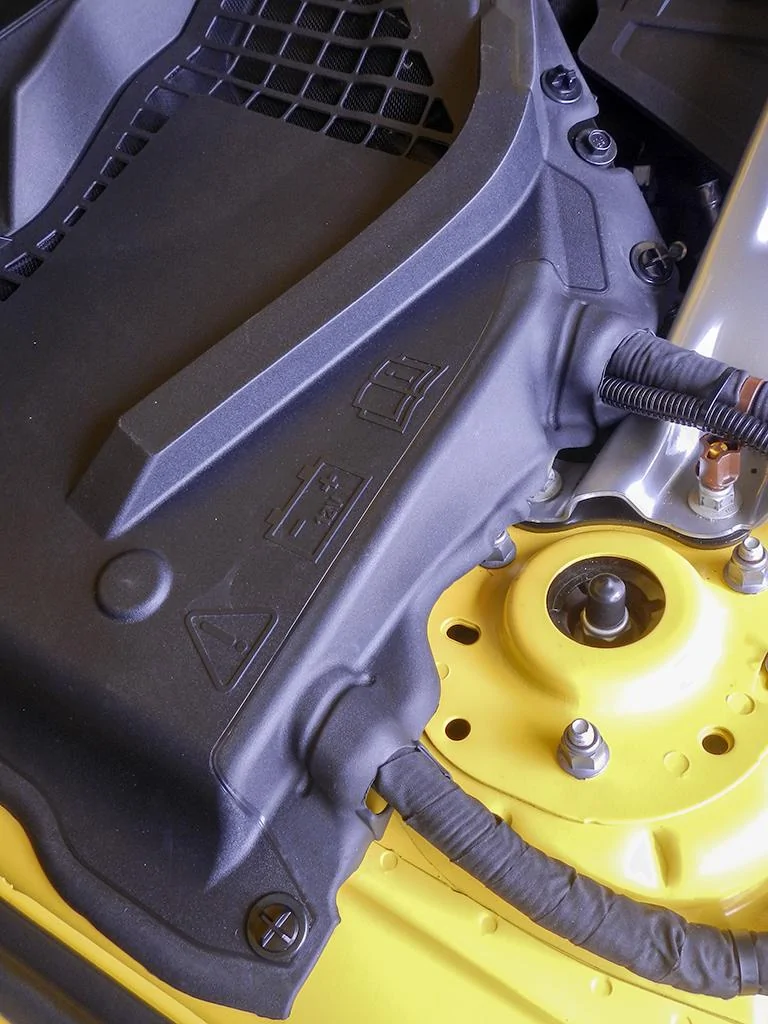

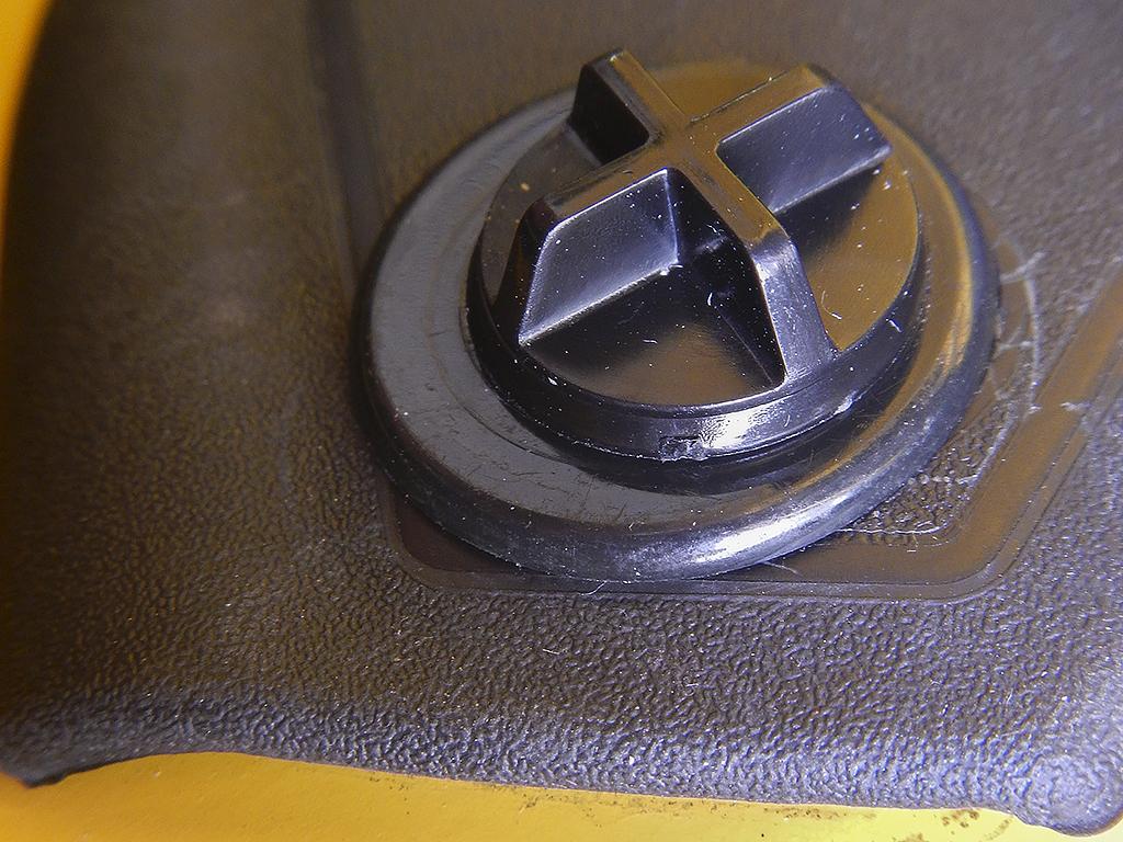

Photos show the final assembly before final adjustment to center the pins in the washers.
I'll have to take the cover off before leaving the car for service; unwarned technicians are even more likely to let the fasteners and washers escape.
I'm wondering if my ArmorAll treatment has rendered the gluing of a washer to a pushpin impossible?
VW parts place also offers the washers in white; would they look too terrible under a black pushpin and on a black cover? Would certainly increase the chances of service personnel noticing their presence.
