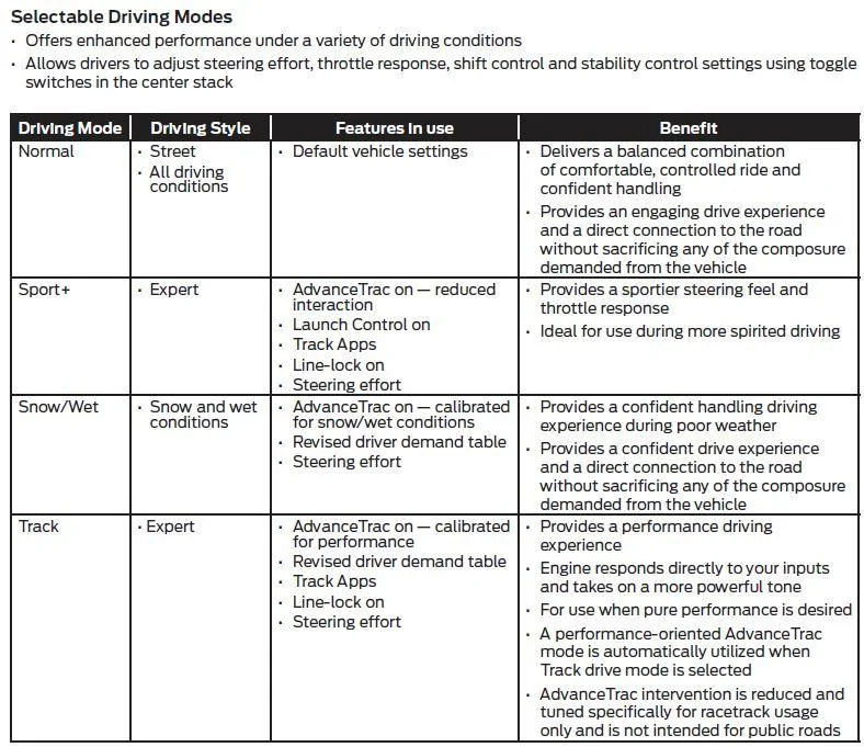

In most sports cars with various "driving Modes" Track Mode is NOT everything off. usually its something like traction off and Stability minimal, but will intervene to save you ass if needed. Usually everything off is the "everything off" modeBase S550 GT:
Default at every start-up:
- Traction Control On
- Stability Control On
Single tap: "Traction Control Off"
- Traction Control Off
Double Tap: "AdvancTrac Sport Mode"
- Traction Control Reduced
- Stability Control Reduced
Press & Hold: "AdvancTrac Off" (e.g. Track Mode)
- Stability Control Off
