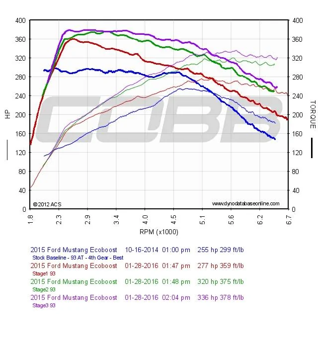

I think the dyno graphs below support @NoVaGT 's observation.
2015 Mustang EB (dark blue's stock): Peak torque's reached below 2K and remains flat until the small stock turbo runs out of breath past 4.5K RPM. Even a simple off-the-shelf tune dramatically increases the peak torque but still shows a dropoff toward the higher RPMs.

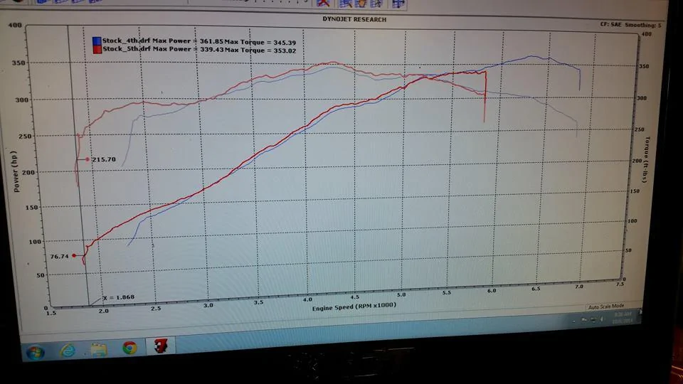

2015 Mustang GT (Stock): torque curve climbs slowly and peaks after 4K RPM, then it slowly climbs down. Its torque output at low RPM is lower than EB's so that's probably why EB feels "quicker" at that range especially with being almost 200 lbs lighter. Of course, it doesn't take much for the GT to catch up and surpass the EB.
This thread has many dyno graphs that also suggests 5.0's hit their max torque after 4K RPM: https://www.mustang6g.com/forums/threads/5-0-dyno-chart-compilation.49398/
