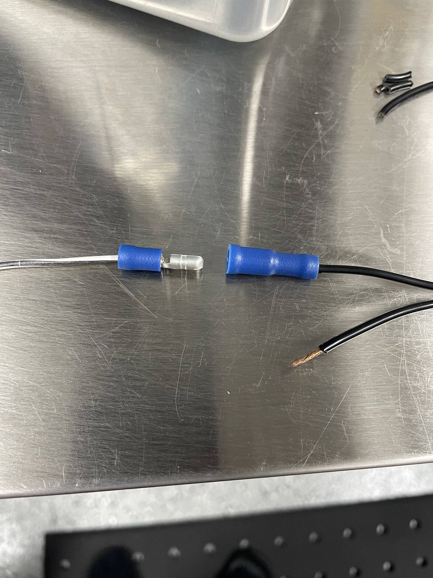

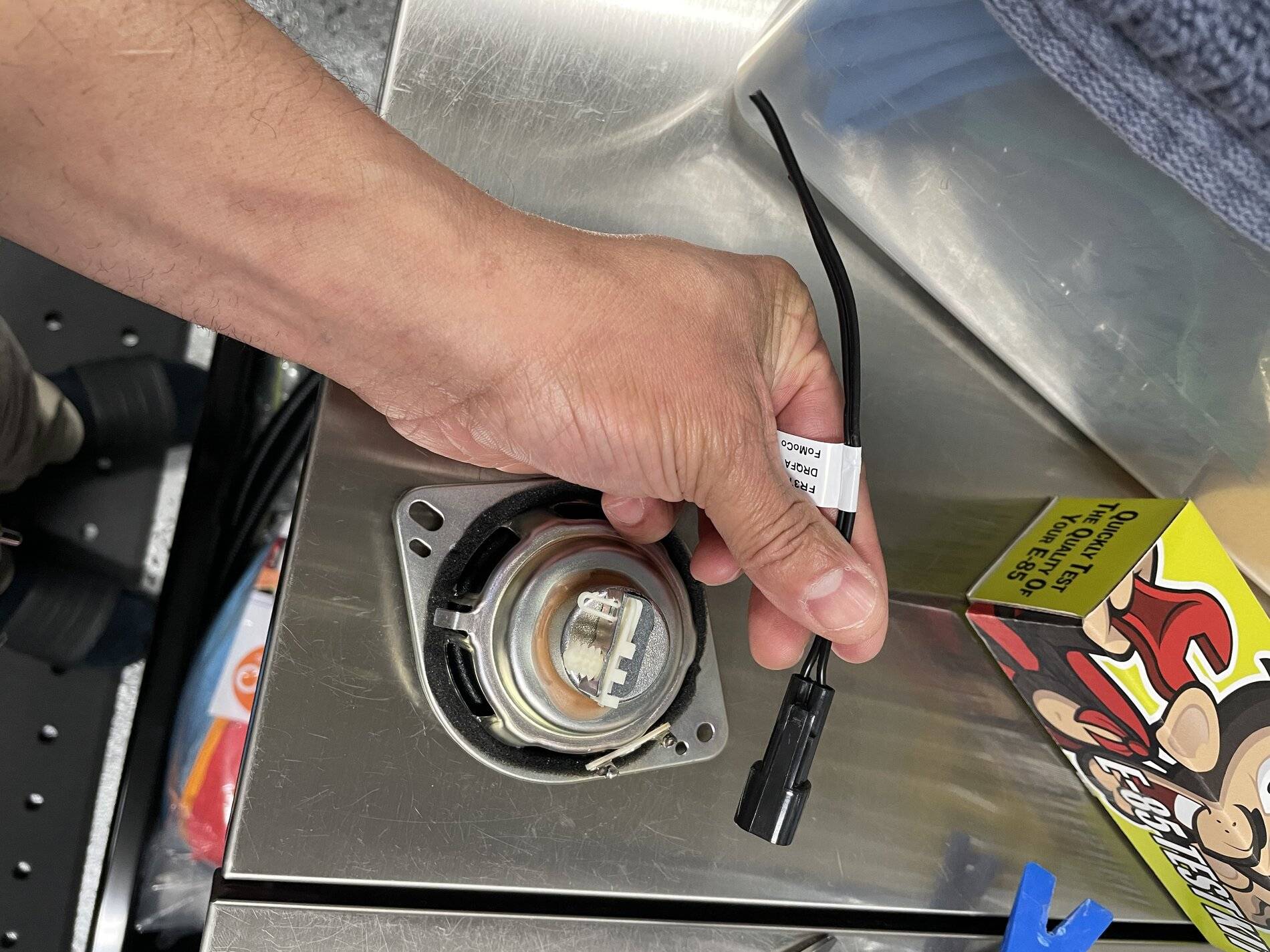

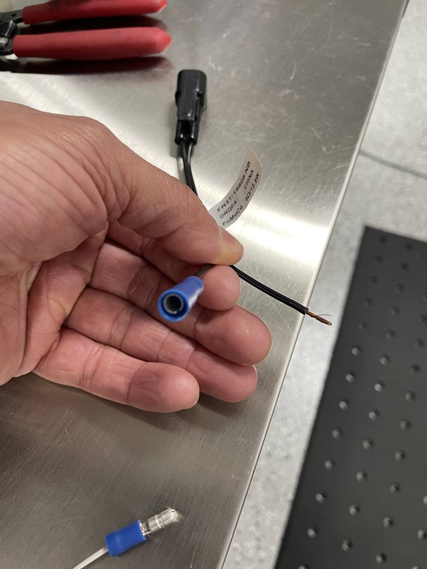

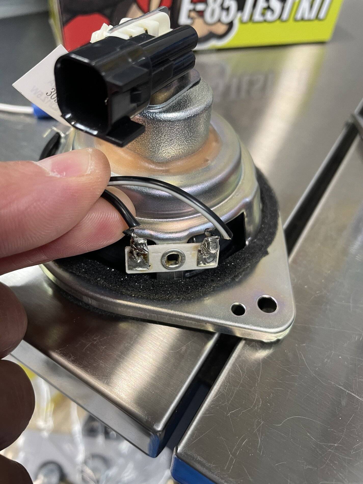

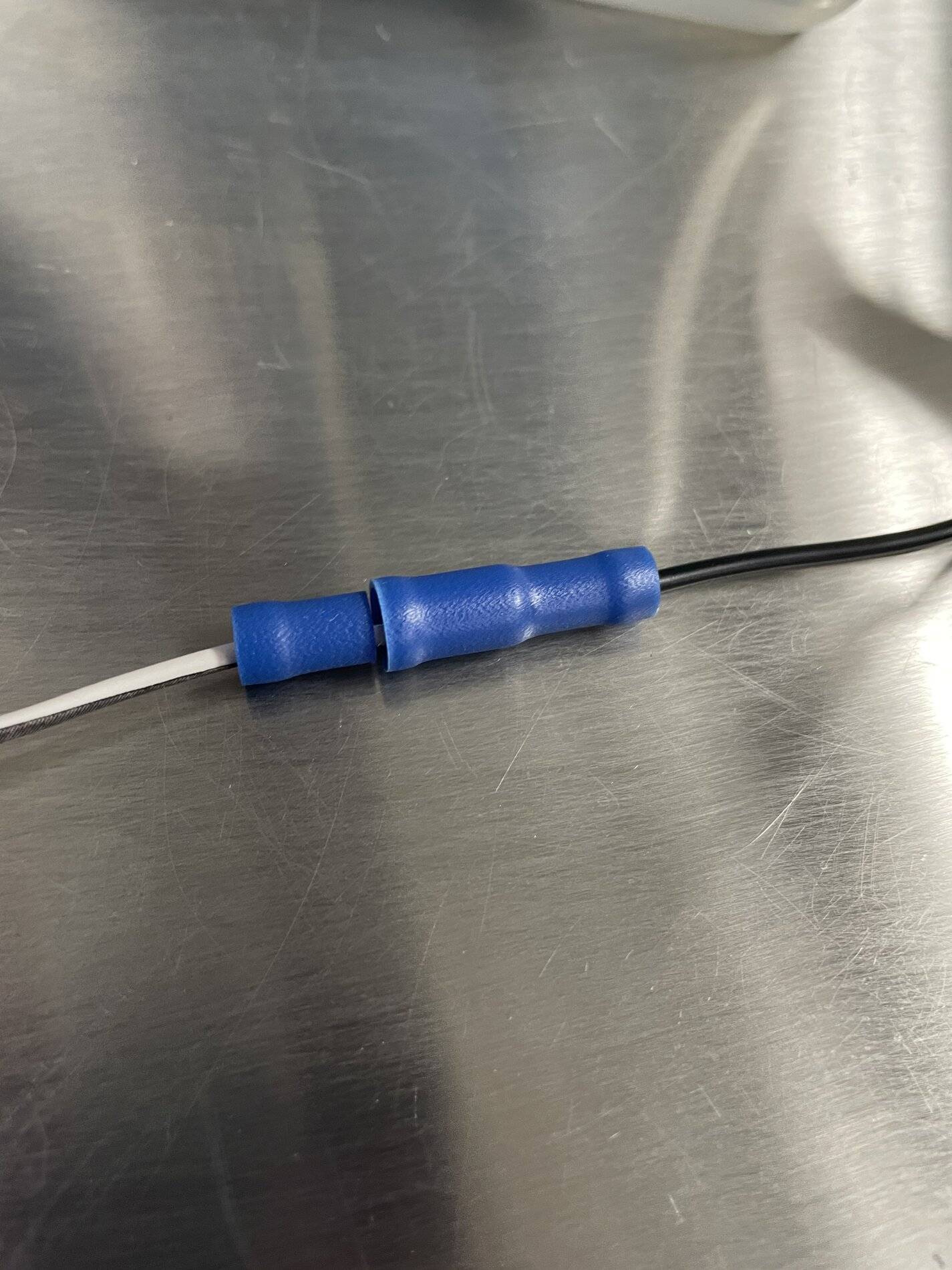

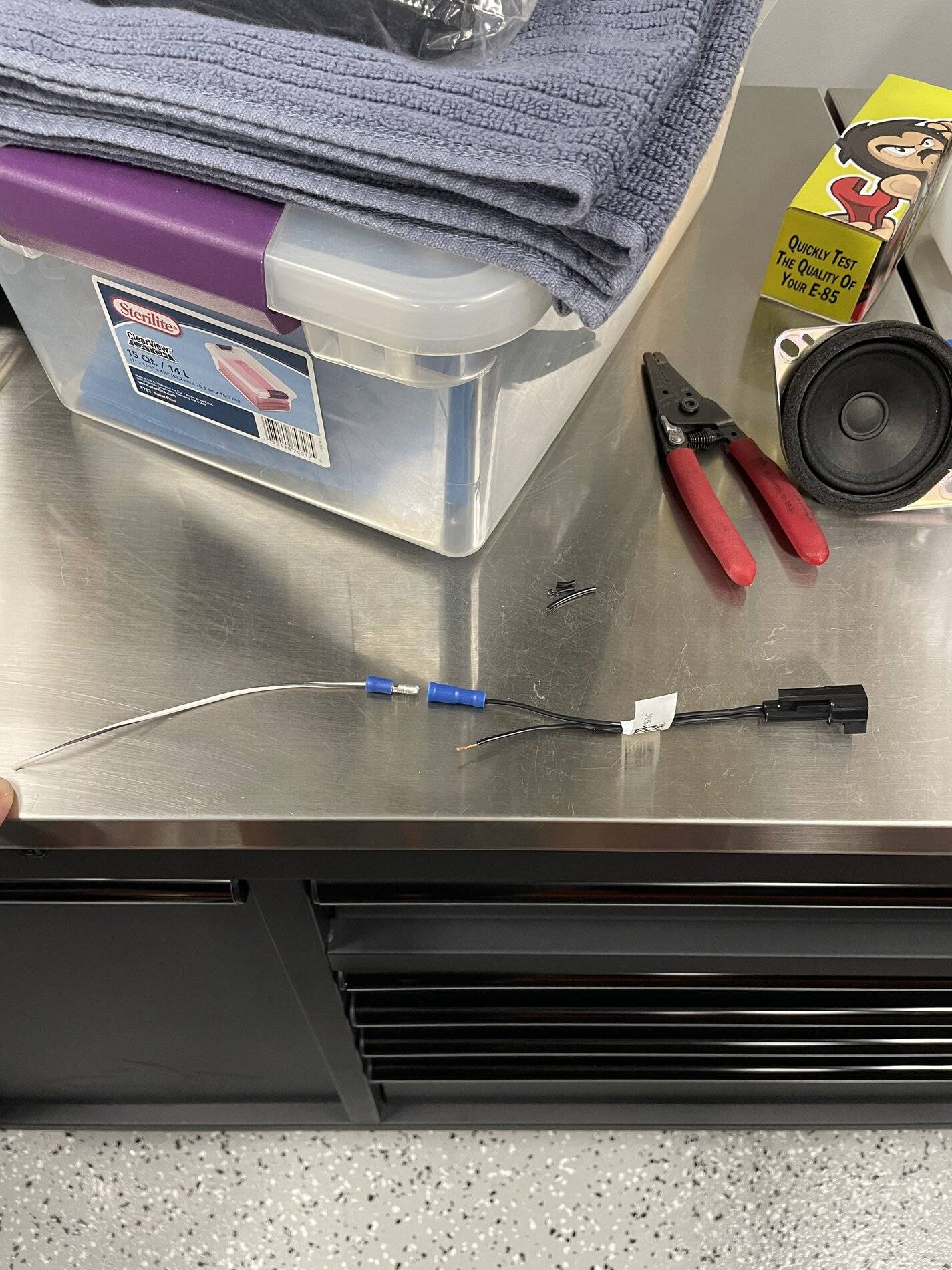

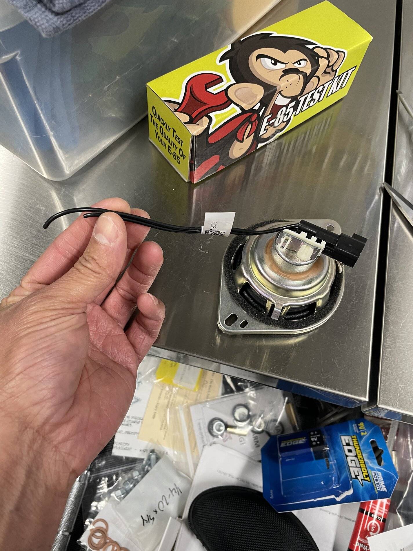

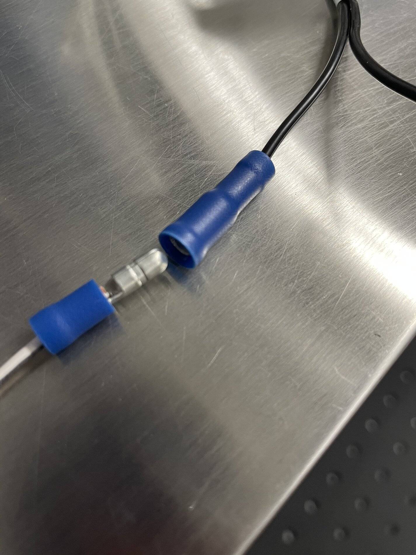

Ok, I went ahead and sacrificed my B&O center speaker for the good of mankind. Here’s another option. Get yourself some red 18-22 gauge male and female bullet connectors (two of each to make up both speaker leads). Crimp the male bullet connectors onto the ends of the B&O speaker plug and crimp the female bullet connectors onto the ends of two short pieces of wire (can buy a foot of black 18 or 22 gauge wire at your local hardware store). Solder the black extension wire to the new speaker terminals and you won’t have to try and locate those hard to find mini spade connectors. See mock up pics below for visual reference. Note: I am using blue bullet connectors and white wire for the example, but you will need red ones for the job.

Thanks a lot for your help, brother. But you actually gave me a better idea: Just solder the black wires to the new speaker, and problem solved, no? :) That way the new speaker can be disconnected from the connector the same way as the stock one. Having said that, I'd have to get some flux, since I don't have any. And the solder I have, supposedly with it, it's absolute crap.

Yep, you could certainly solder them to the new speaker. Thats the best way to do it anyways IMO. For those that don’t have soldering equipment though, the spade connectors (and/or bullet connectors, should need to extend the wiring), would be the best bet.
