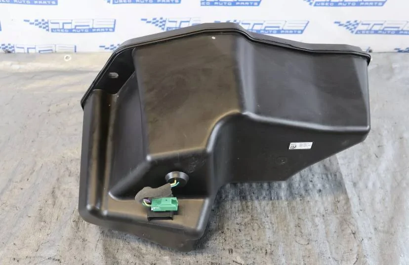

i’d be really surprised if the factory box was smaller than that. It seem to me it’s around that or even slightly larger.
Edit:

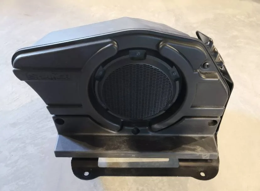

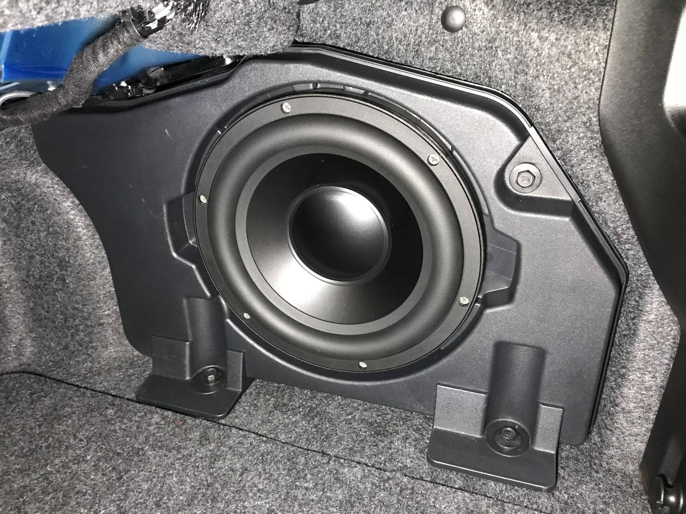

At least on my vert the box is bigger than the shaker. Shaker has an indent on th back for an amp, my 2020 doesn’t have this. B&O is obviously bigger inside you can see that here First two picss are the shaker, third is mine, fourth is random internet of B&O.
