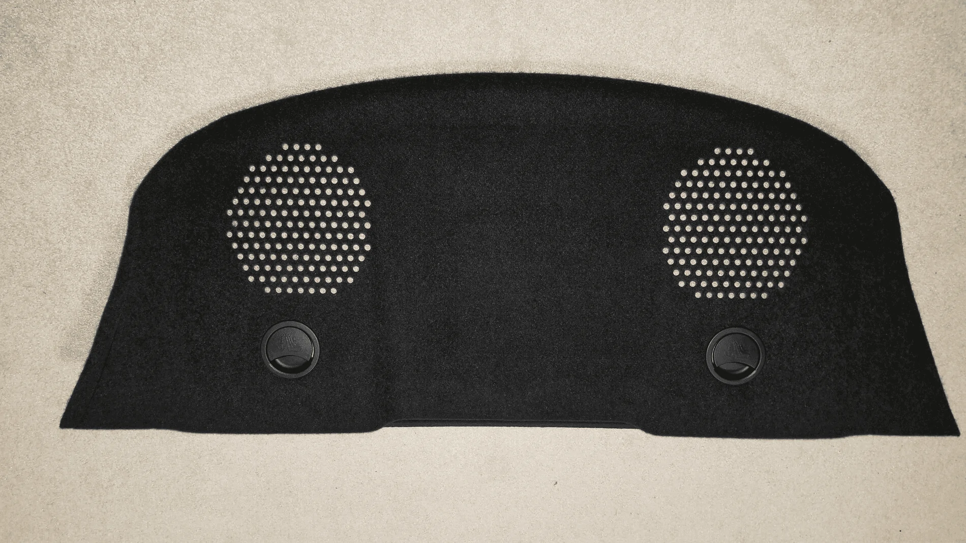

The rear deck material is likely muffling the sound too. Even better speakers may not do much for it.
Maybe doing something similar to this.
