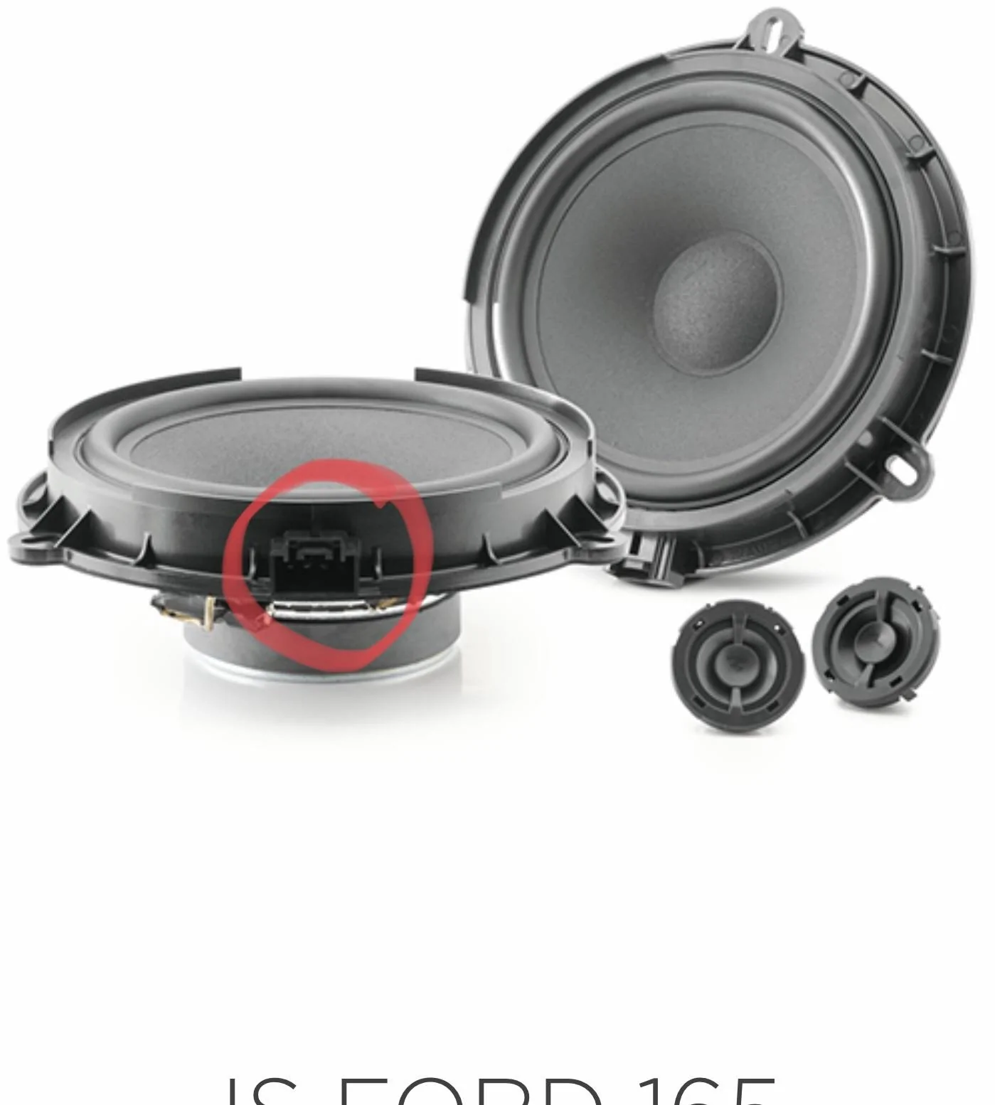

and the IC165 are really plug'n play?
so also the plugs?
can someone say from experience how the 165s sound?
OF5.0
Mar 28, 2019
458
265
Pittsburgh
Scott
2022 Shelby GT500 CFTP
so also the plugs?
It’s supposed to be plug and play. Here’s the photo from the link that I provided earlier:
