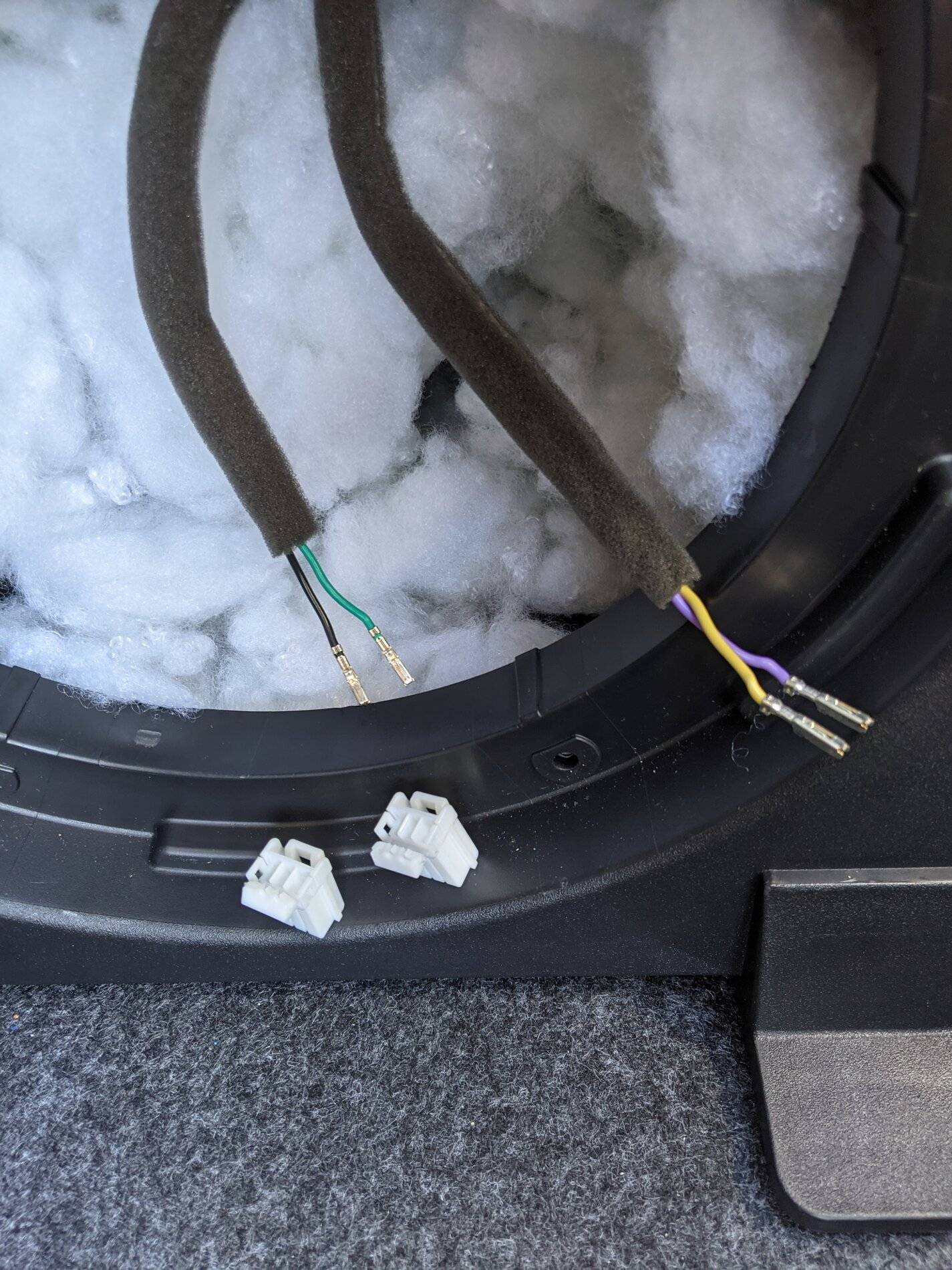

Yup! Each of the pairs in this photo has one positive, one negative wire.
In the left pair, the black wire is negative, the green is positive. In the right pair, the purple is negative and the yellow is positive. Use one pair for each set of terminals on the Pioneer sub.
It may be less confusing to say the black and purple wires are negative, the green and yellow wires are positive
That's how it's phrased in post #1, so I tried a different phrasing for those for whom that didn't stick. 🙂

Exactly that has been pointed out in the very first post in this thread along with a picture of the wires :)
I know that.
But I asked ChipG with intention. He might have a different conclusion about polarity.
I have noticed on my Pioneer sub, once connected in B&O system as described in the very first post here, that cone is kicking inwards on bass pulse. Is it possible that we have wrong connection "diagram" and consequentially driving our subs out of phase?
When I exchange the wires, loudspeaker cone starts kicking outwards.
Does anyone else noticed this phenomena?
