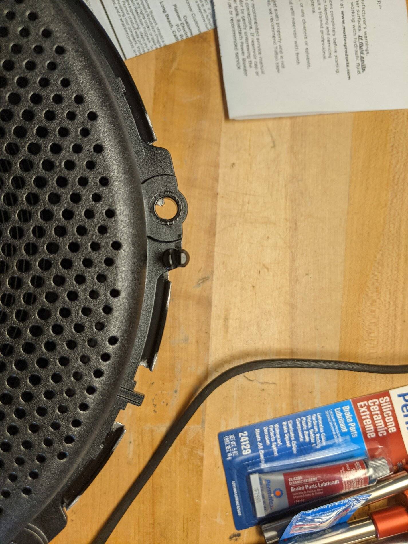

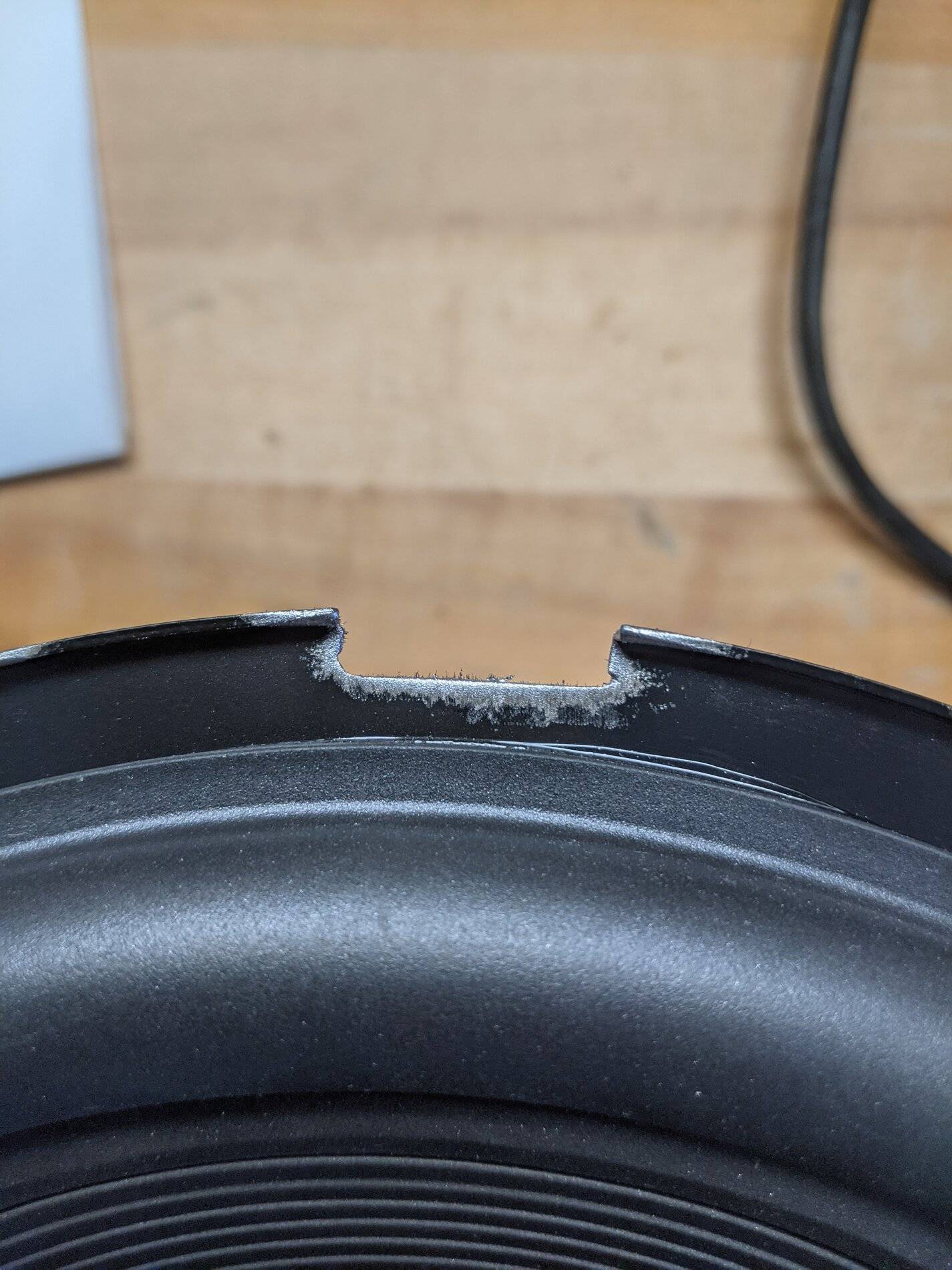

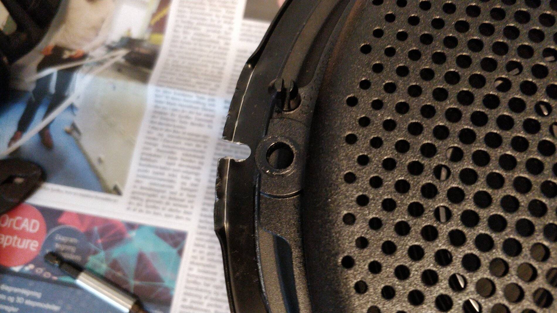

I then decided I didn't want to modify the enclosure, I would modify the Pioneer subwoofer instead. So first I used a dremel to cut a relief for the plastic pin at the top of the enclosure.

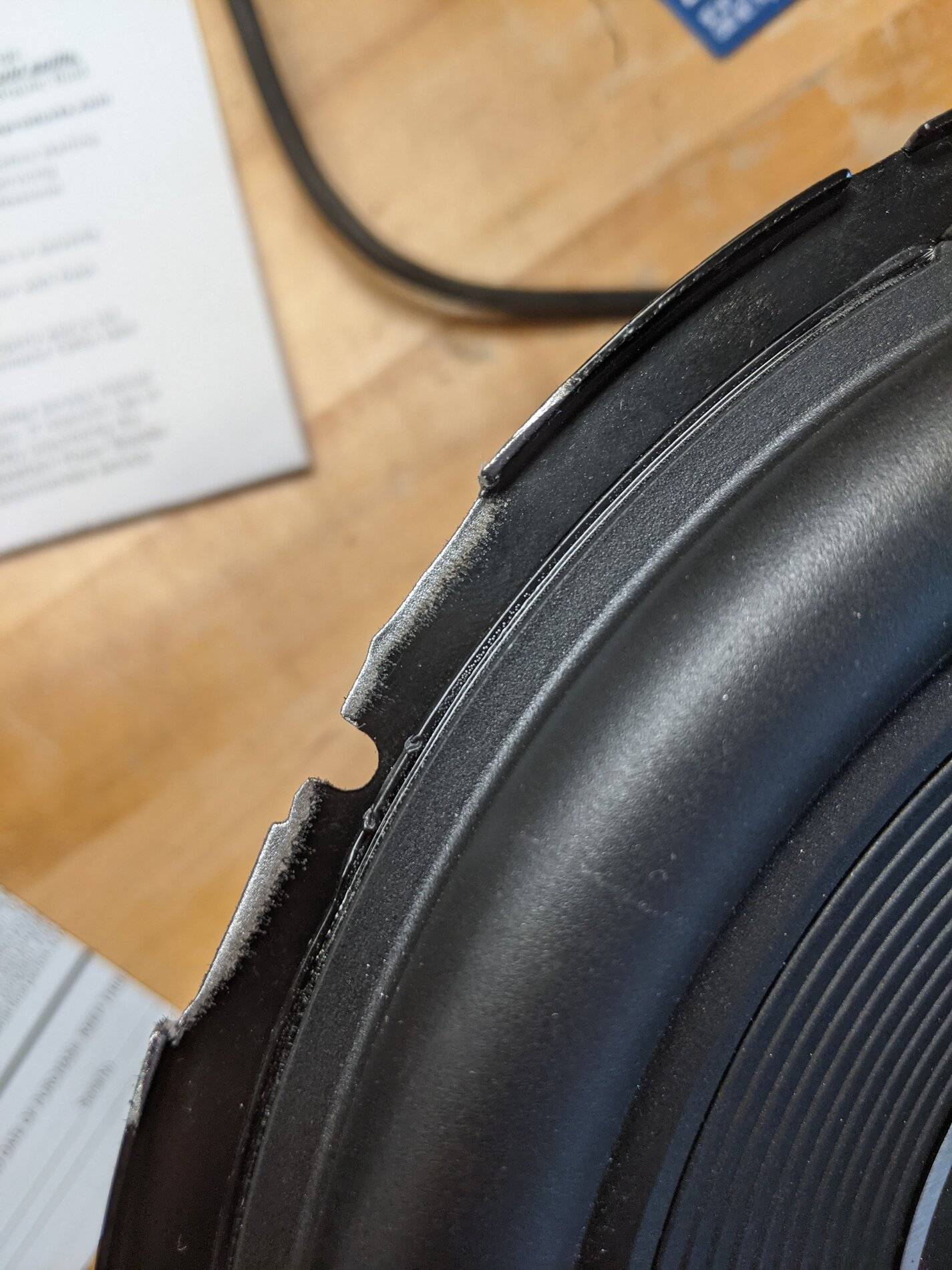

Then I cut the mounting holes, removing enough of the edge for the grille to mount flush, but leaving as much metal around the original hole as possible to give the screws some clamping surface.

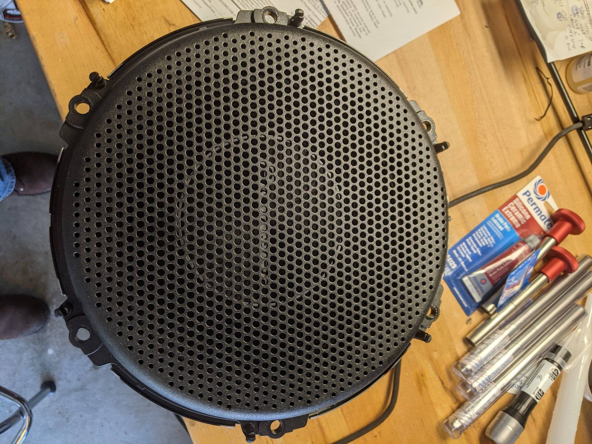

A test fit of the grille to the speaker and we're good to go (and yeah, the parts on the bench were for the brake work this weekend)!

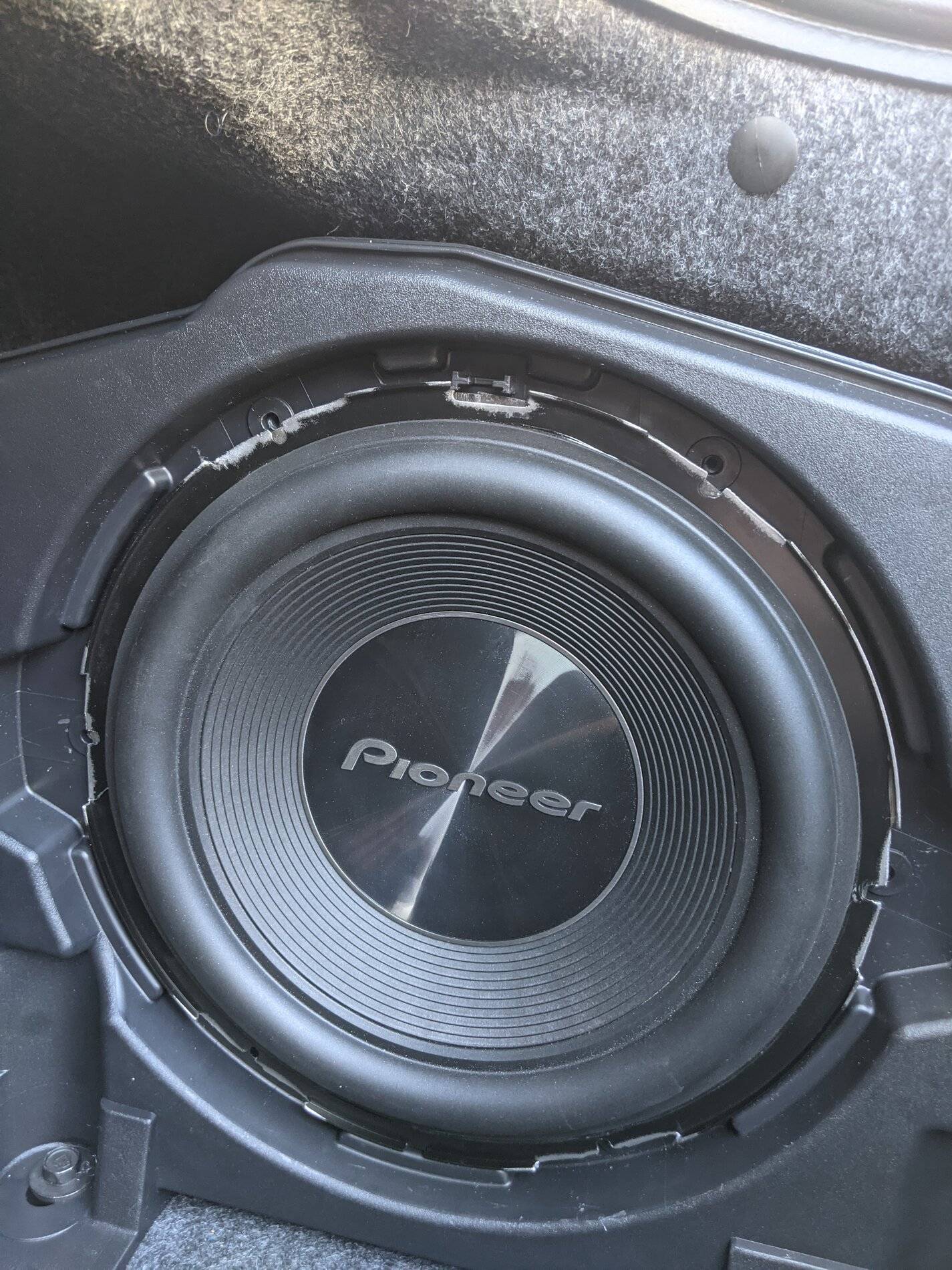

I ran the foam tape on the enclosure, wired the connectors, then fitted the speaker.

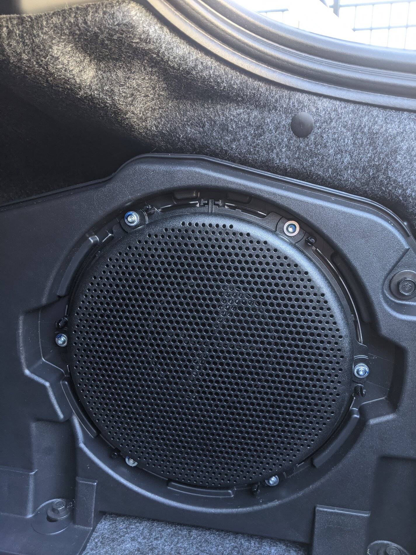

Stock screws through the stock grille in all holes, and everything fit perfect. I was also able to recover and glue back on all 3 broken plastic retaining clips.

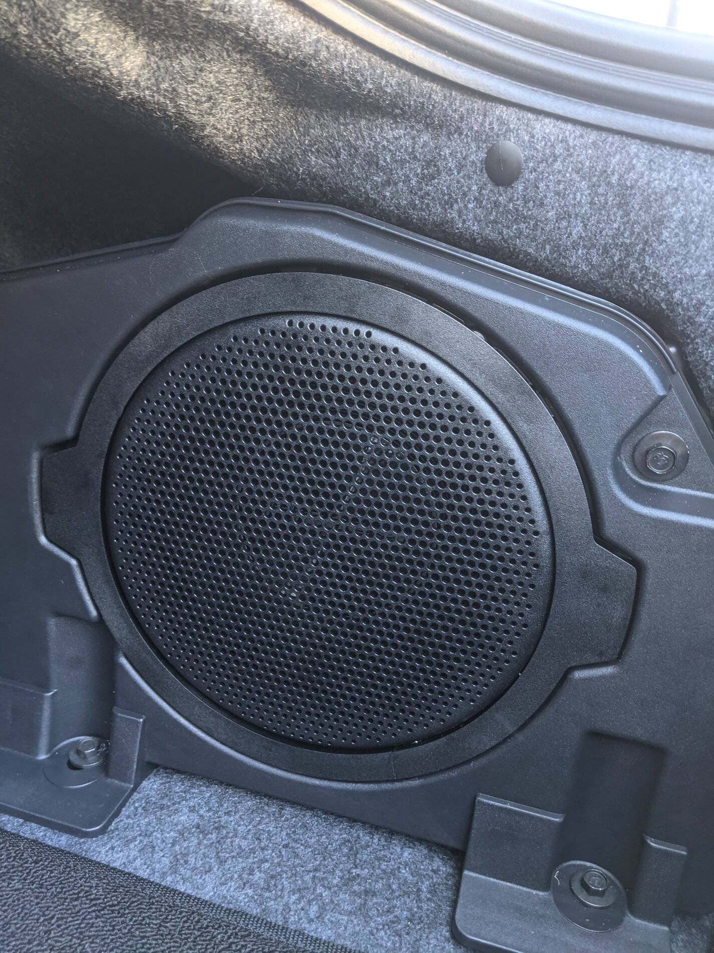

I repaired the trim ring as well - just one crack at the bottom, not even noticeable. Replaced the ring and done!

Result, sound is much improved. The bass is still a little boomier than I would like (due to the inability to customize crossover for the interior speakers, I'm guessing) but much better than the muddy mess from the stock subwoofer. Removing the center speaker also cleaned up the mids/highs. Overall, good results for under $100, not bad.

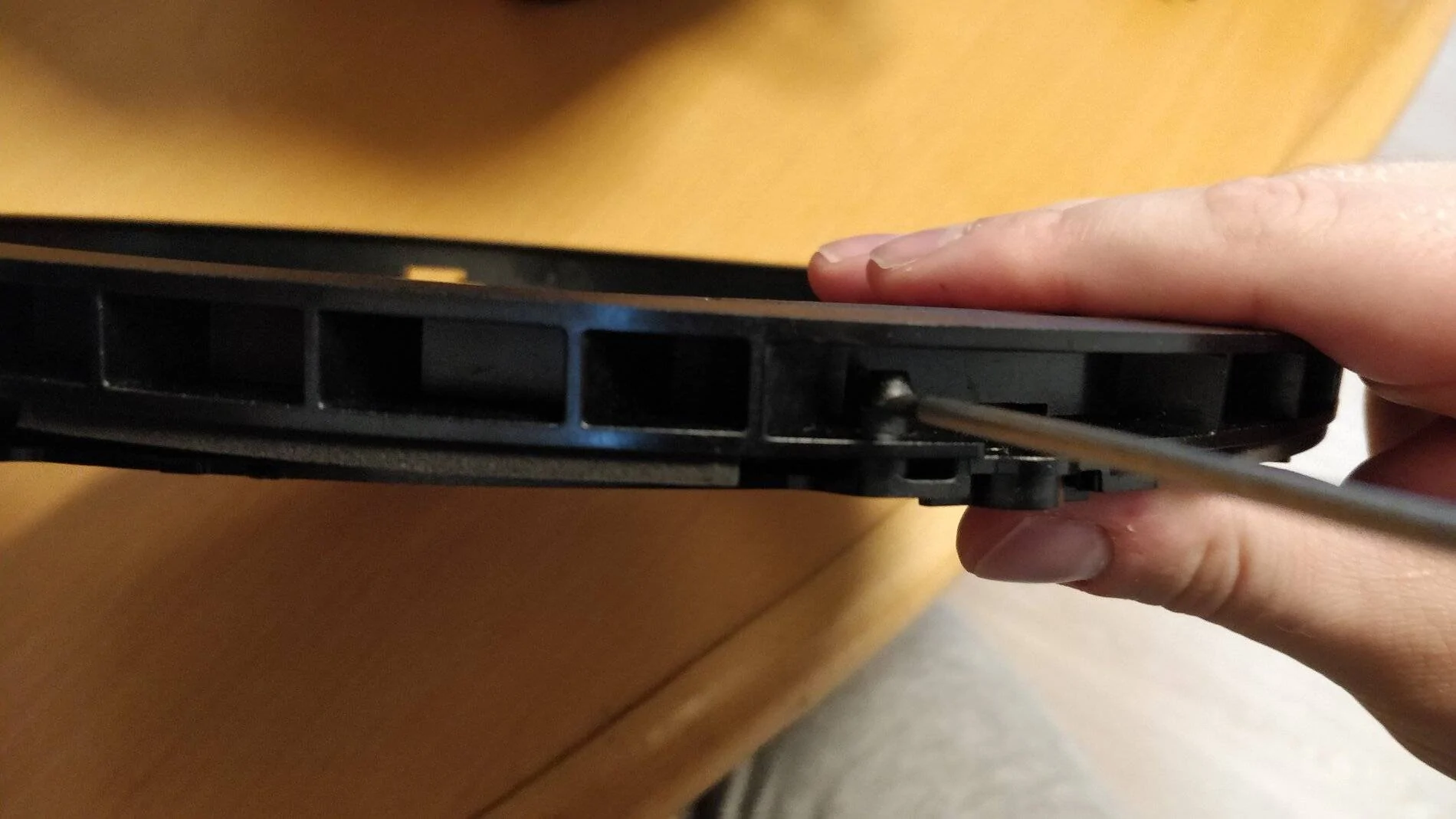

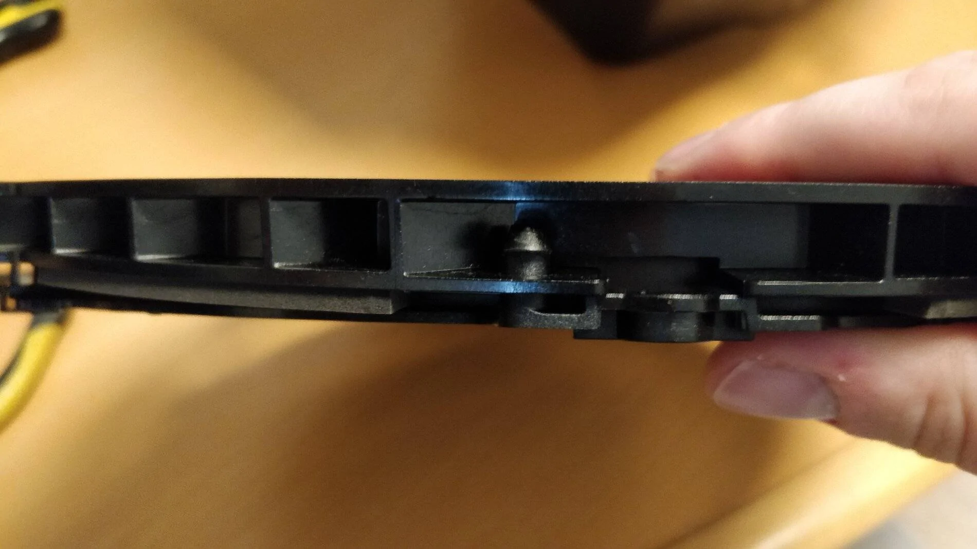

I can see that sadly too many experiences that frame and/or the tabs breaks.
Don't know if this photo series can help others in the future but hope so! :)
Here you can see how the tabs are pushed in to the frame. I found the best way to start was to look at it as a watch and start with the 3 and 9 positions since the frame has a bigger gab and it is easier to get into.
I don't have any fancy trim removal tools so I used 2 flat head screwdrivers - one to apply pressure upwards while using the other (a rather thin one) to poke the pin towards the center.
The pin is split in 2 and the outer one has an edge to catch onto the frame - this is the part that should be pushed towards the center
In the picture I have the Pioneer replacement speaker underneath - again I didn't have any fancy tools for metal work so I cut out the wholes with a metal cutting scissors and bent the frame down with a flat nose pliers.
I hope that helps out some people in the future :)

How did you get the grille off as a unit with the trim ring? The issue I had was I had to remove the trim ring to get to the screws to remove the grille and speaker. I had no access as you're showing in the pictures or I'd have been quite happy with the tip!
RasJeremy
Mar 23, 2020
282
605
Denmark
Ras
Mustang 5.0 2020
Oh I didn't! Sorry I didn't mention that.
I had the same issue as you with little to no space to get underneath the trim ring. I had to get that trim off to get access to the screws to get out the grill. This is why I mentioned starting at 3 and 9 positions because there was more room for prying it up - also using rather thin screwdrivers.
The pictures provided with the grill and trim are just to show how I did :)
I hope that clears it up. :like:

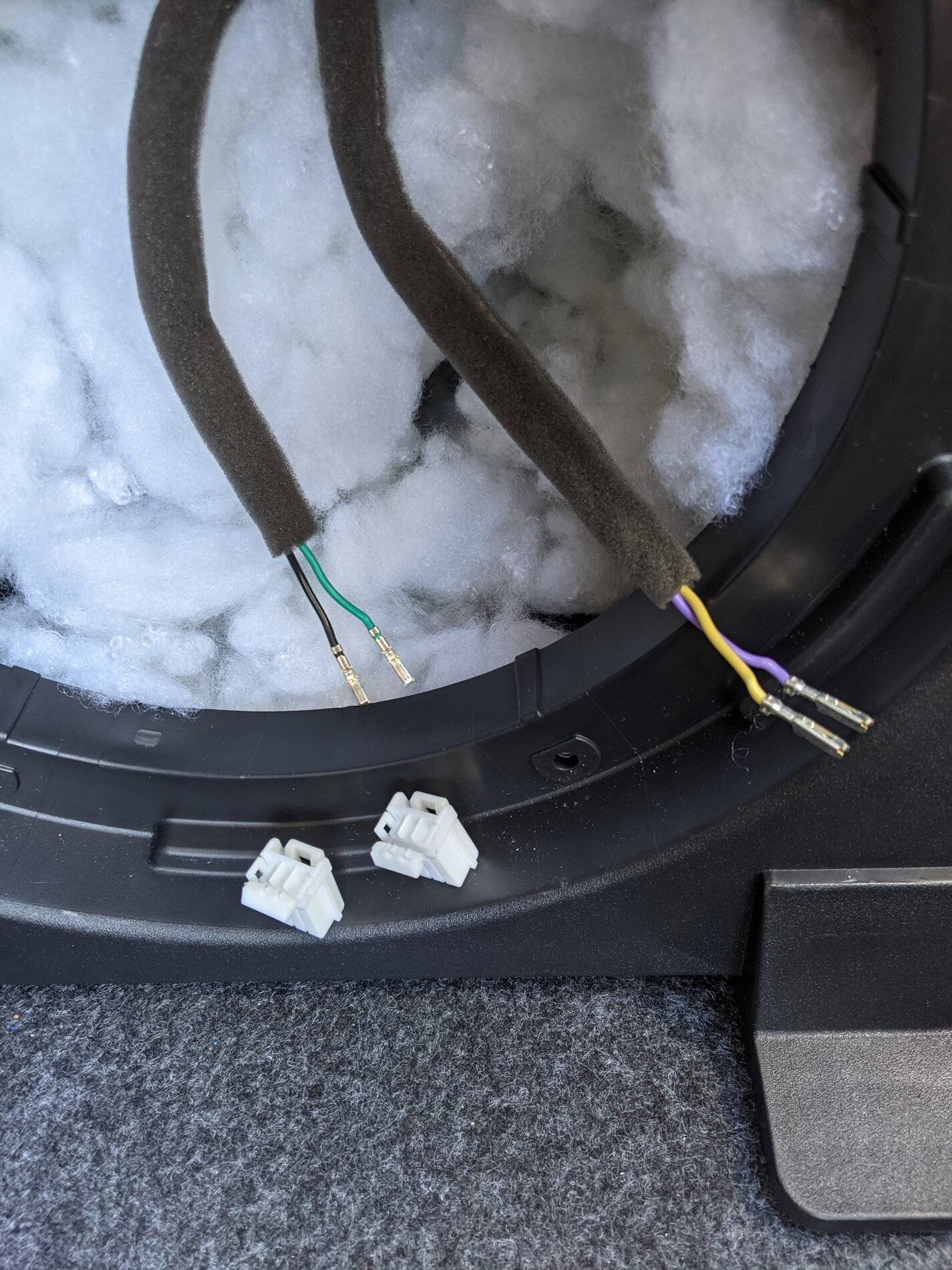

Can you tell us please, which wire here is positive [+] and which negative [-] for each coil?
Exactly that has been pointed out in the very first post in this thread along with a picture of the wires :)

Yup! Each of the pairs in this photo has one positive, one negative wire.
In the left pair, the black wire is negative, the green is positive. In the right pair, the purple is negative and the yellow is positive. Use one pair for each set of terminals on the Pioneer sub.
