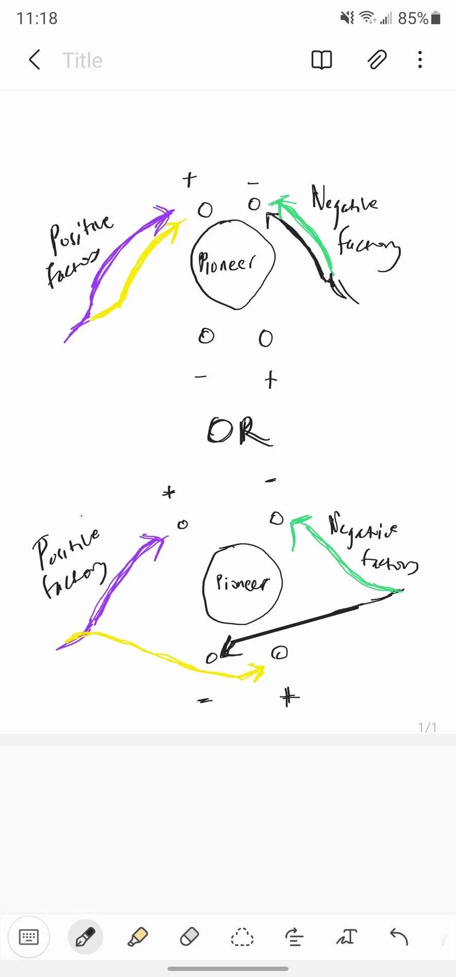

Can someone assist with the wiring for the Pioneer subwoofer please.
Do both factory positive wires go into the top Pioneer positive terminal and both factory negative wires go into the top Pioneer negative terminal (leaving the bottom Pioneer positive and negative terminals free)?
OR
Do the two factory positive wires go into the two Pioneer positive terminals and two factory negative wires go into the two Pioneer negative terminals?
OR
Something else?
I've attached an image representing my question diagrammatically
Thanks

the way ive always wired my double voice coil subs, (4 wires) into 2 ohms.
I take the two positives, and wind them into 1.
I take the two negatives, and I wind them into 1.
so 2 reds into 1 red lead
so 2 blacks into 1 black lead
then I run each lead into amp. 1 pos 1 neg.
thats 2 ohm.
correct me if I wrong. I didn't do this project, but thats how ive done it
I am admiring your artistic ability, 2nd chart is how I do it.

If wiring into an aftermarket amp that handles 2 ohms. Do as FreePenguin said above. If you are going to use the stock amp, then wire one positive to each of the positive terminals on the sub and one negative to each of the negative terminals on the sub.

I should of expressed more greatly that 2nd photo was for aftarmerket amp.
