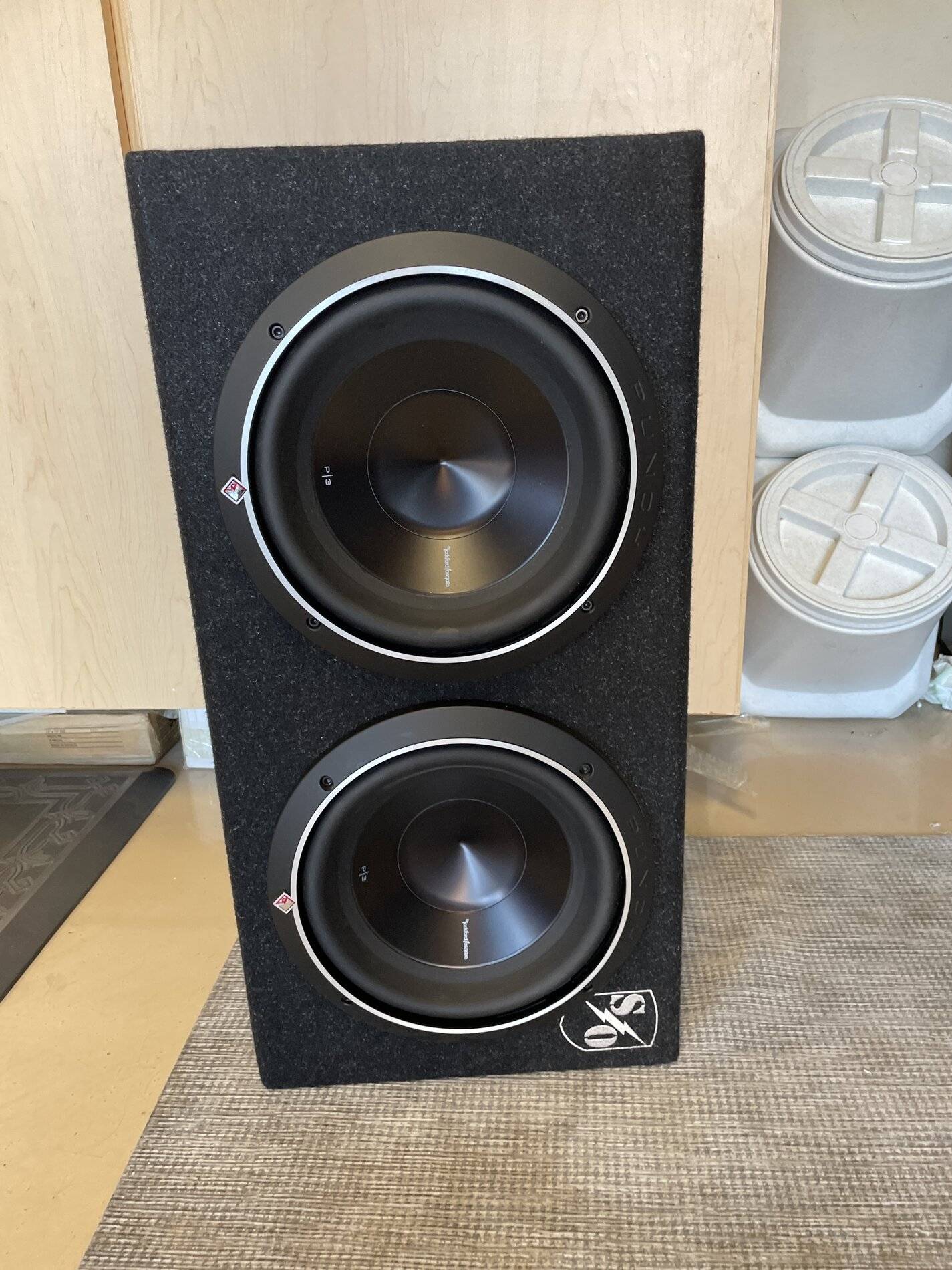

You are right. This is the box I have with two Rockford Fosgate P3’s in it being pushed by an Alpine 500w mono amp. I put it in the trunk and it really doesn’t use up a whole lot of space. But like I said I never put anything in the trunk of the car anyway.

Those Rockfords are supposed to be really nice subs. I am sure they will sound good. What is the depth and height of the enclosure?

The box is 28.5 x 19.7 x 12.9. Each enclosure volume is .76. Rockford calls for .59 so it is pretty close.
Like I said, I had these in the trunk of a Maxima with the Bose system which from factory doesn’t have any sub at all, and with these subs it sounded amazing.

I do believe it will sound great. I asked for the dimensions because of the fit in the Mustang trunk. In order to sit back against the back seats, the height has be 16" or less, otherwise, it will have to sit well back into the trunk.....but as you said, you aren't worried about trunk space, so that shouldn't matter. I am still waiting on my dynamat sound deadener, as the Mustang trunk tends to rattle quite a bit and I don't like being able to hear that when standing outside the car.
Ya it fits with plenty of room. I have already set in in to see how it fits, I didn’t take a picture though.
