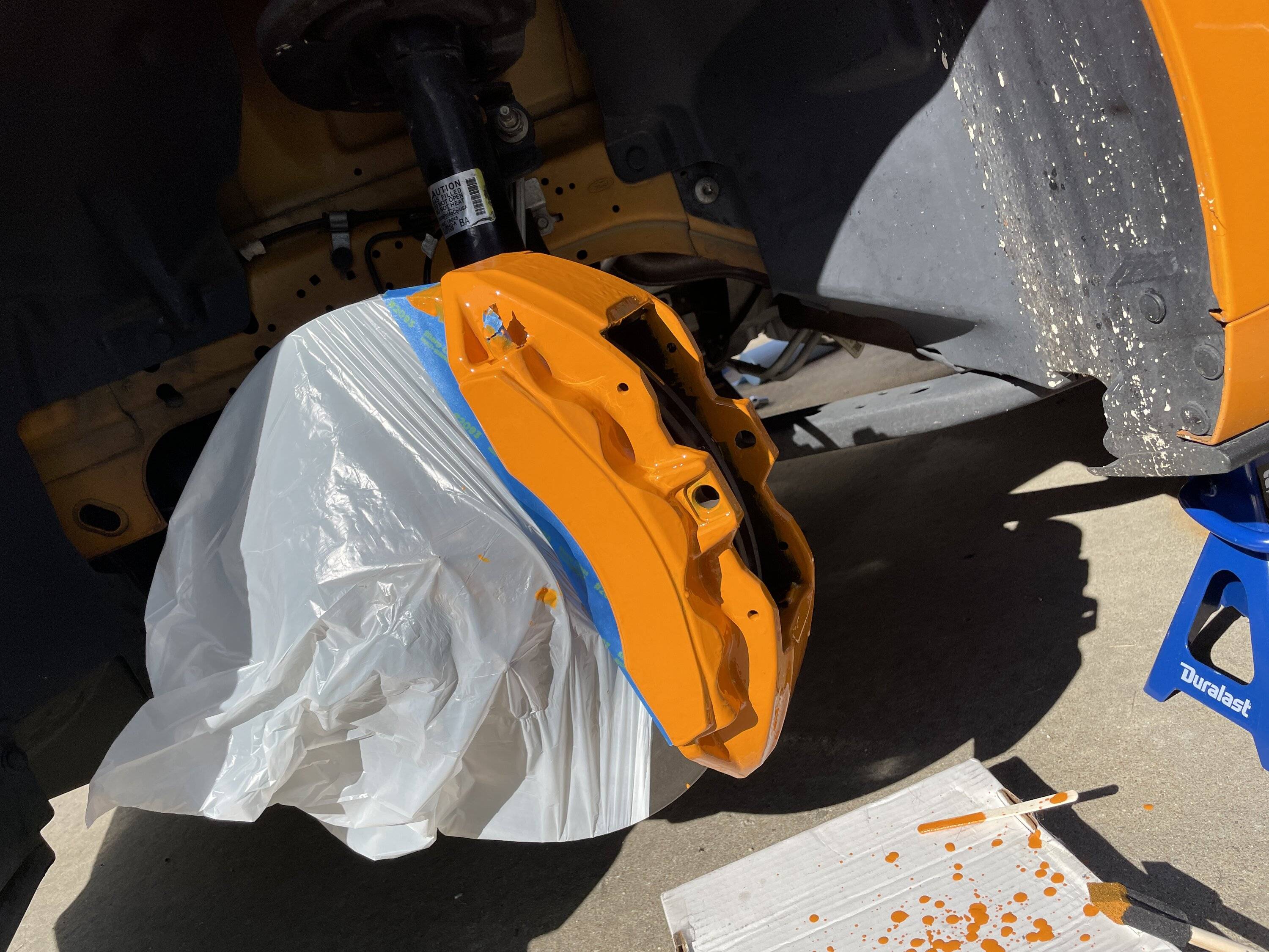

Another vote for the G2 paint kit since mine turned out pretty good. It's a high gloss, epoxy based paint, it also self levels somewhat as it dries and cures over 24 hours. It has to be applied in at least 4-5 coats to look good, and it's better to get some good brushes from a hobby store than what G2 provides. I didn't even remove my calipers to paint them but did at the very least removed the pads and hardware. Put a bag over the rotor and masking tape around where the caliper is so you're not getting paint on the rotors. The G2 paint kit costed me $130 for the body color match. Might’ve gone up a little bit in price now as everything has.
