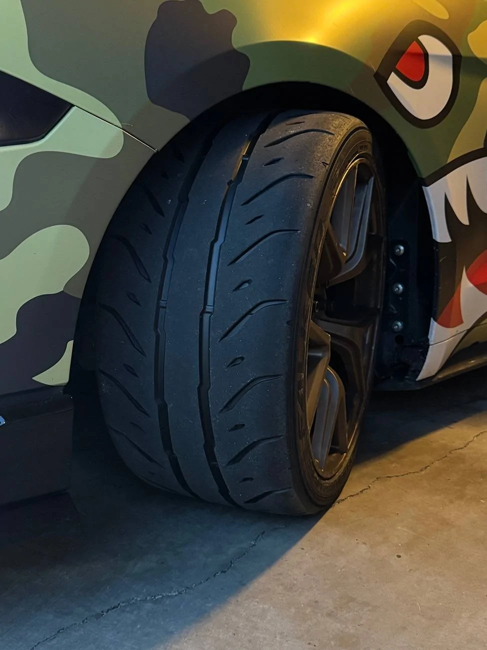

F/u question - the SC3s that came with the used set of wheels I got are 5 years old. They look like they've been well-used but plenty tread still on the two I have up front (I can take pics when I get home from work). I've got minimum spend on a cc to meet so I'll probably shell out for some new ones in a couple months, but wanted to ask those that know more than me and see if I should do it sooner.

5 years is a long time for tires. Once you scrub them in they start to dry out, and if they’re stored outside, temperature swings harden the tire.
honestly I’d probably ditch them.

I once drove a Porsche 911 on old tires and then beat my own time in a Jetta wagon with a broken rear swaybar. The trick: fresh tires vs 5 year old tires.

Guess I'll have some new Stones heading my way. Them things are expensive. I thought I looked maybe a month or two ago and they were in the $400s/tire, but they've absolutely rocketed up. Guess that'd be the tariffs hitting.

I lied. The Stones felt a bit too expensive at this point in time, so went with a set of RT660+s. Had a little more camber added to the front, running 2.5* up front and 2* in the rear. 0 toe. We’ll see what happens.
