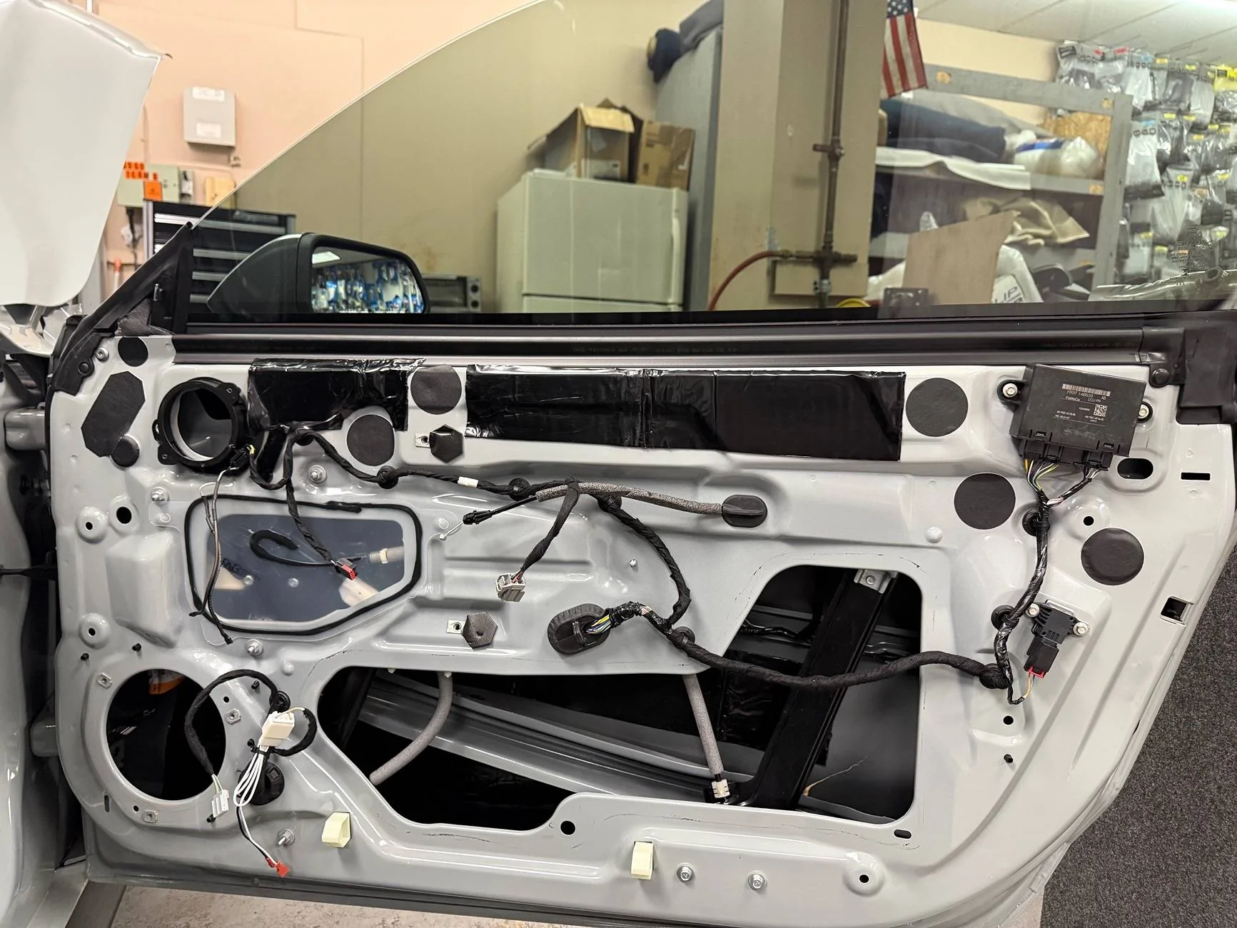

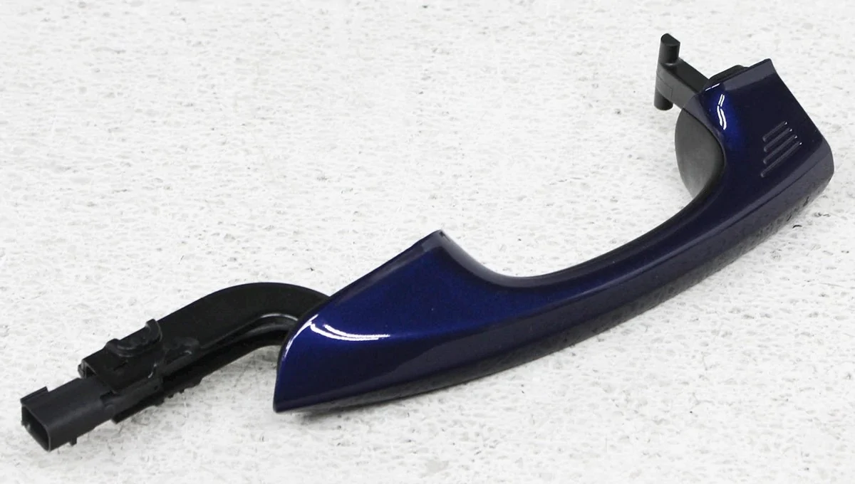

Attached are two photos.
One, the handle itself; it has both a inductive (fob sensing) and capacitive (hand sensing) coupler.
The second photo, look to where the handle would be. That's the Door Control Module (DCM).
The two highlight several door connections needed for keyless entry to work.

As to the rest, there are connections for entertainment, windows, mirrors and side impact sensors.

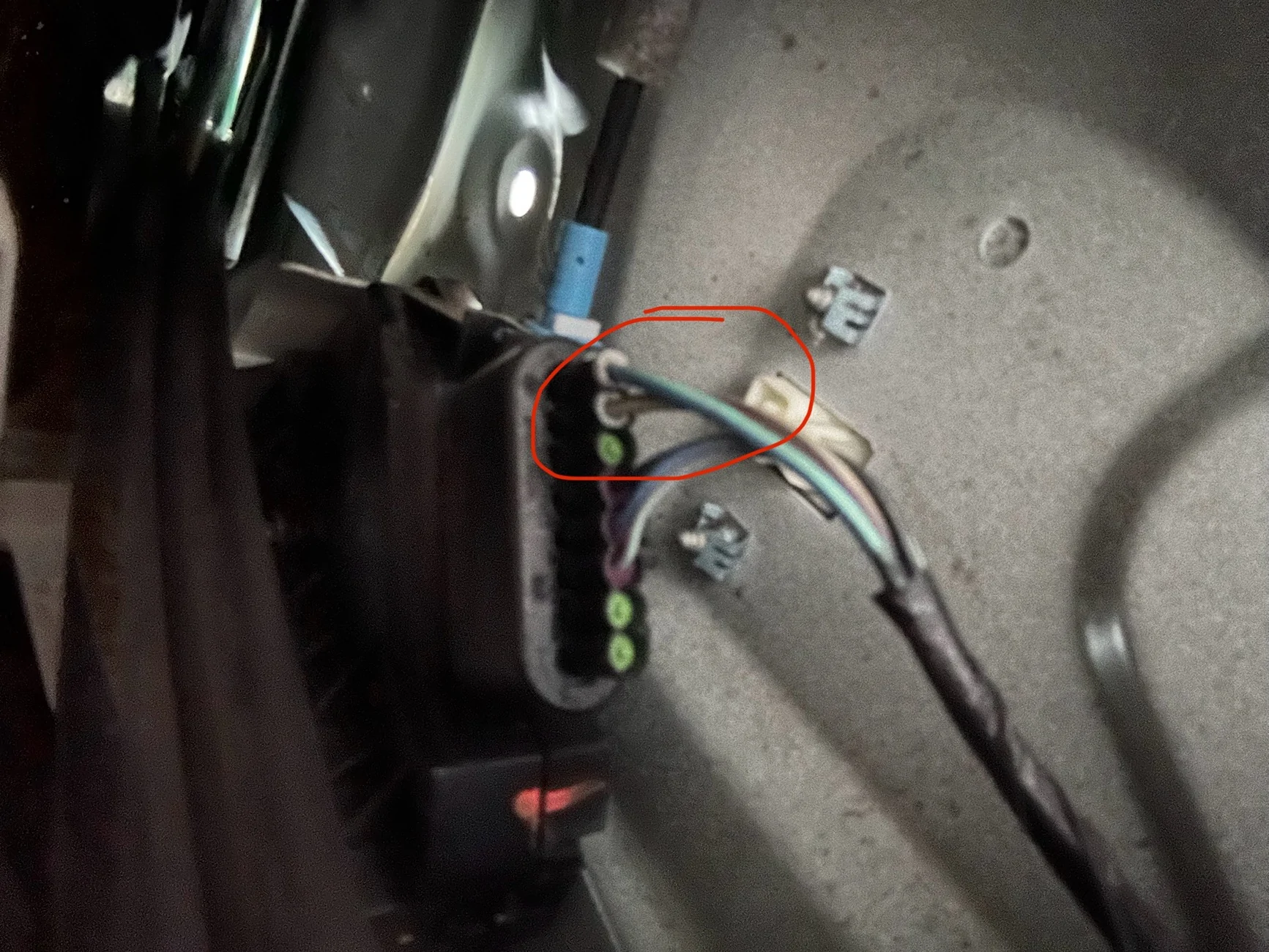

Oh my god! Where were you this weekend that document was exactly what I was looking for! For anyone else in my shoes in the future-I had a terminal loose in the unlocking circuit on the larger connector for the latch actuator. Pic included
