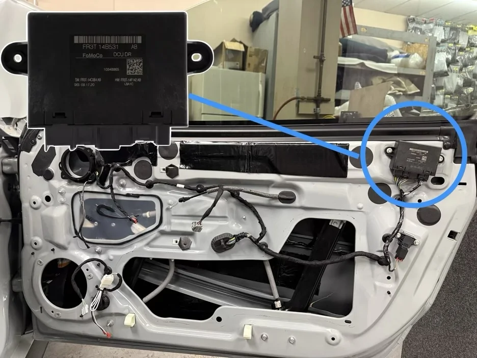

I suspect they left the handle/s disconnected during repairs. Or something happened inside the door during the accident that has not been fixed.

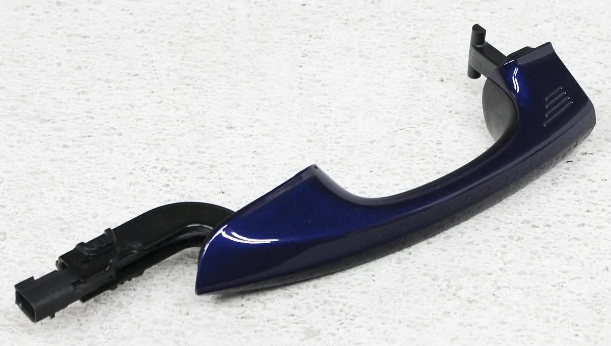

The door handle has two sensors:
- Inductive. When approaching the vehicle with a fob, once within about 3-6 ft / 1-2 m, the handle's inductive coupler will sense the fob. A Low-Frequency (LF) emitter in the handle will send a signal to the fob. The LF signal wakes the fob, and asks it to send a High Frequency (HF) reply, with a code, to the Remote Transceiver Module (RTM), located in the rear of the car
- Capacitive. When touching the inside edge of the door handle, a capacitive sensor will confirm presence. If the fob has sent the correct code to the car, the door will unlock
The door handle is plugged into the Door Control Module (DCM), which communicates with the Body Control Module (BCM). If the door handle is not attached, incorrectly attached or the modules are defective, none of these processes will work.

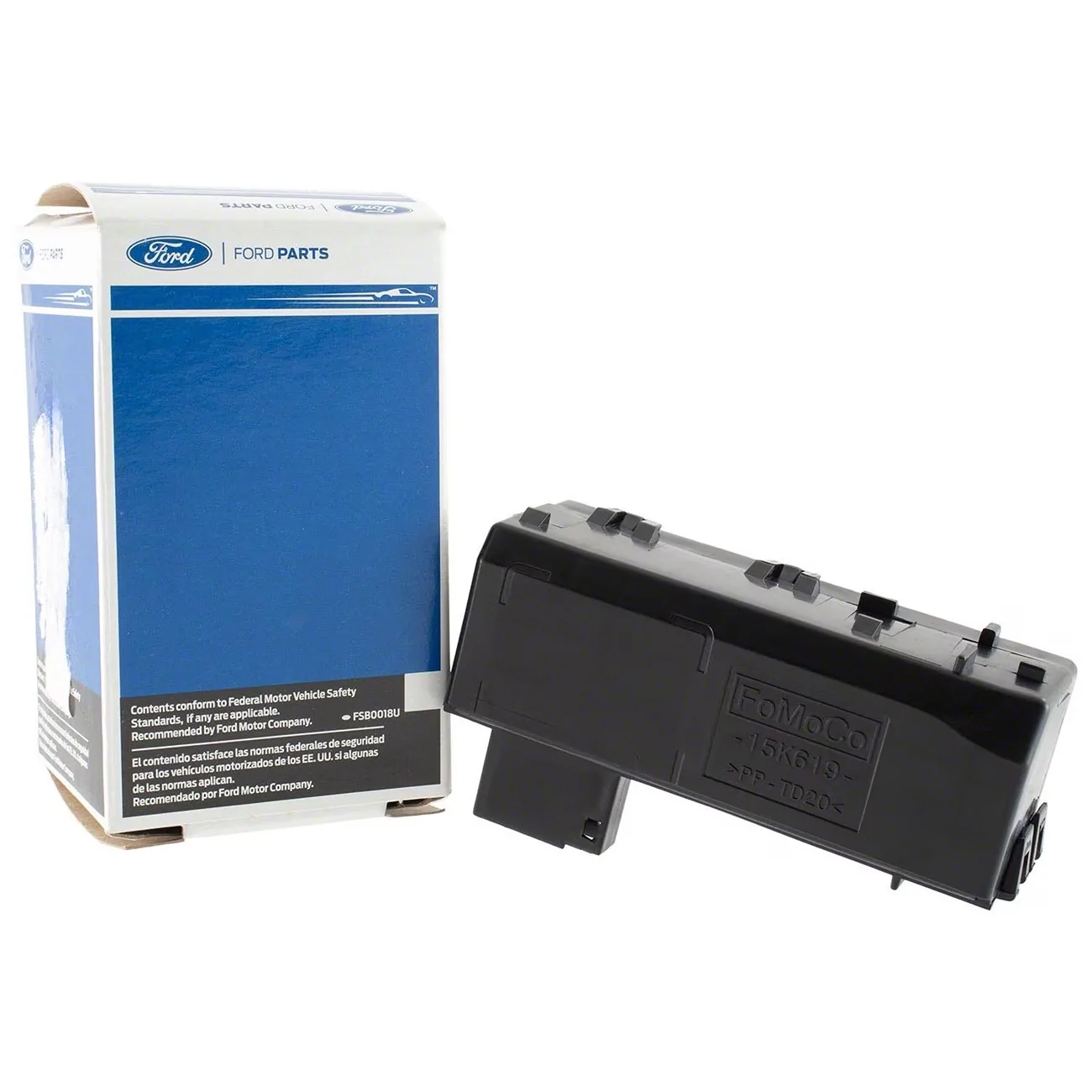

If both doors will not auto-unlock and you notice Tire Pressure Management System (TPMS) is not working, there could be a problem with the RTM. The RTM receives HF signals from the fob and the wheels (the wheels and fob use the same frequency). If looking at the interior, the back, the parcel shelf in the rear, the RTM is underneath that. I've tried to locate mine and could not. A few posts and the Ford docs say the RTM is in that general area.
Edit,
If the fob is working by manually pressing the button to lock/unlock, that clears the fob and the RTM. The problem is then with the doors and handles.

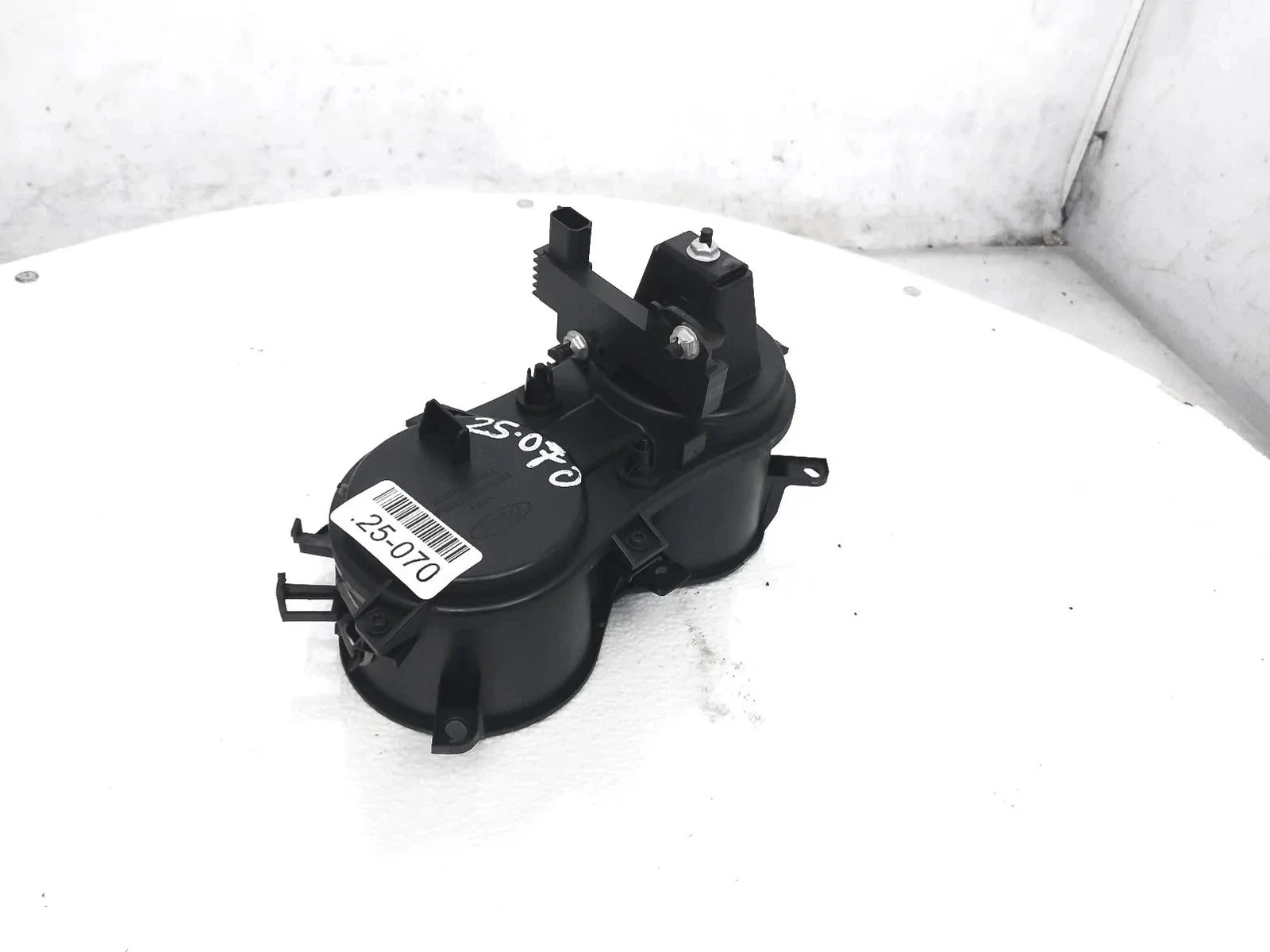

The port in the center console, that is involved with the Passive Anti-Theft System (PATS). I'm not aware of the port being associated with Intelligent Access (fob, door, etc.). PATS deals with the engine immobilizer and starting the vehicle. The sensor in the console confirms the presence of the fob, then unlocks the Powertrain Control Module (PCM). The center console port can also power and illuminate the key, confirming it's the correct one. This allows the car to be started in-case of a bad or missing fob battery.
