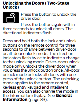

There is a setting in the information display that you can change. It is Vehicle - Locks - Remote Unlock. You could also do the below, pulled from the manual:
