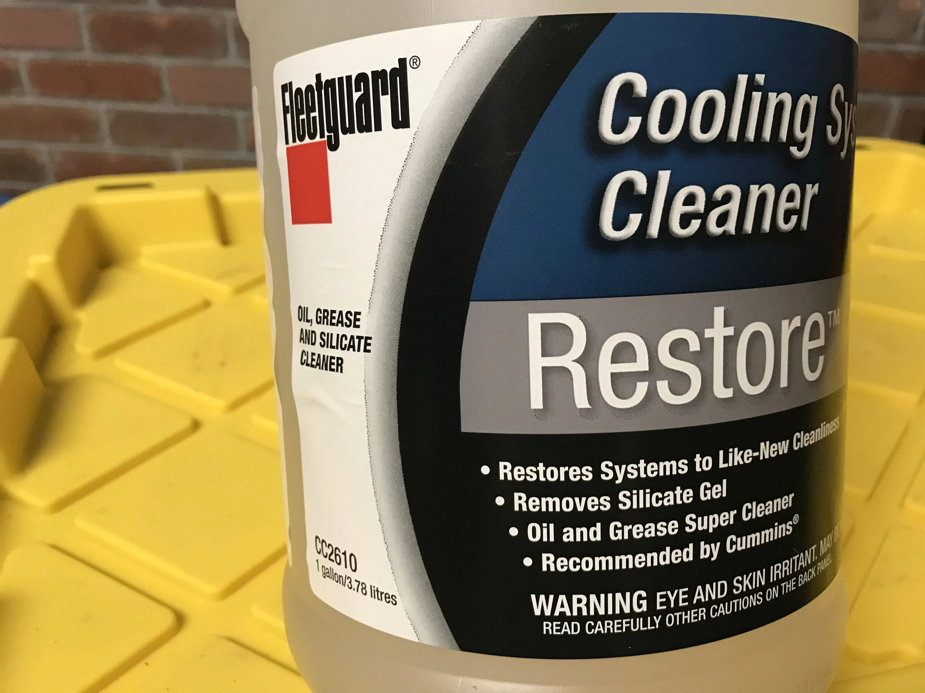

And how do I clean out the water passages?
I’d suggest cleaning after installing the engine.
Look into the product in the attached picture and decide what’s best, at 26k there’s probably no reason to worry about aggressively cleaning the coolant jacket.

Avoid using muriatic acid on all accounts………..
Muriatic Acid is hydrochloric acid and will etch away the protective natural oxide coating of aluminum.

There's no protective coating inside the cooling system
Aluminum has its own protective self-healing coating that forms similarly to 300 series stainless steel protective self-healing crystalline coating.
Acid etches off the natural protective oxide coating.
Acid washing should be avoided.
