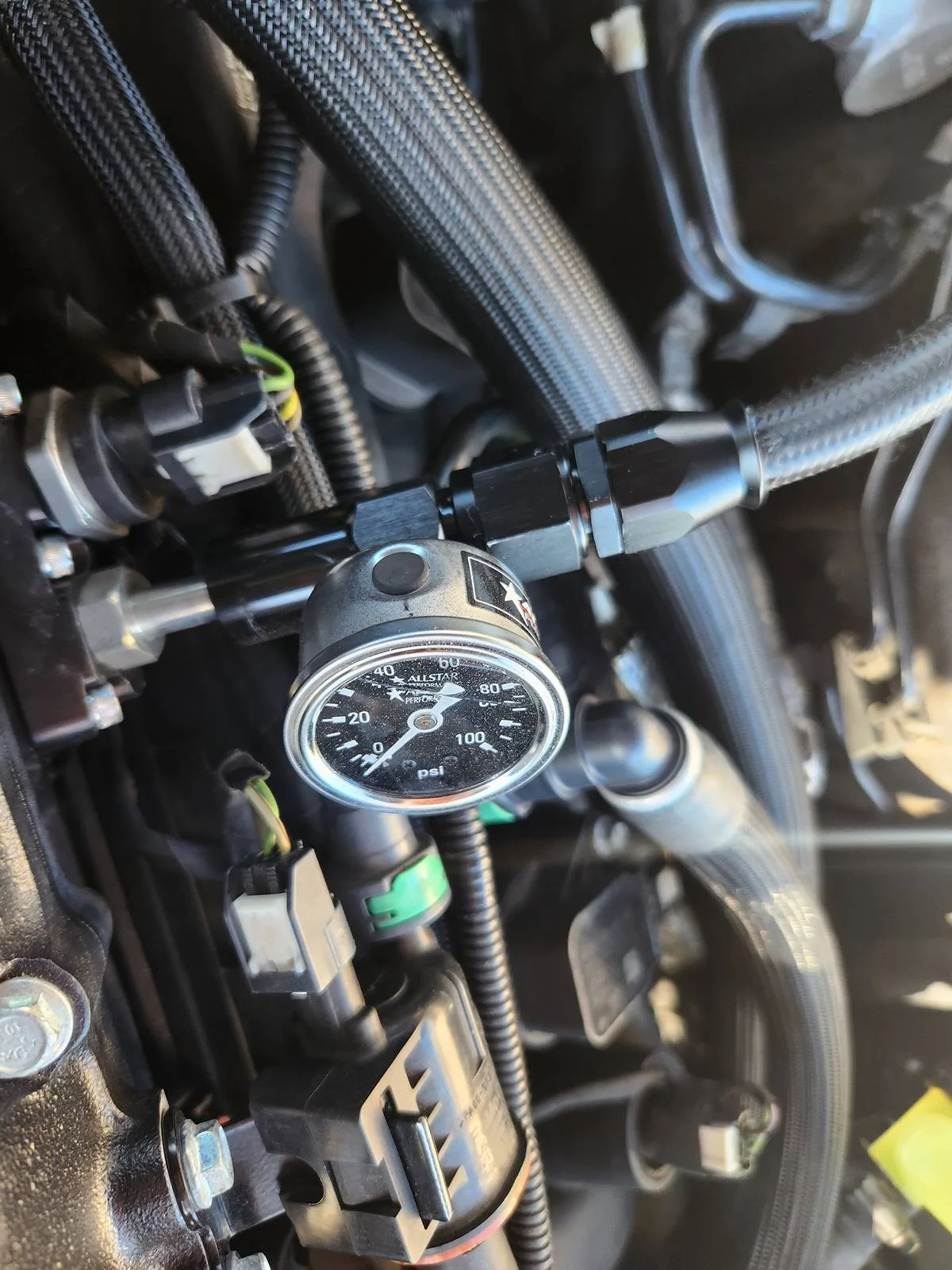

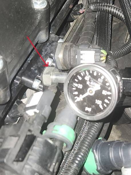

I ran down about 2 hours away from home today to Maryland International Raceway for the Racemotive 1/3 of a mile roll racing competition. On the way down I was following a friend of mine in an M8 Competition. That car is fast, and I have a leaking oil pan which is worse when beating on the car. Because of the smoke and smell increasing about a half hour into the ride down, I stopped being hard on the car. So drove an hour+ being easy on the car. Was leaving several hours later, following Havoc_5.0 (Phil) who ran in the races today. He was pulling his car on a trailer, going slow. I was doing 35mph on a winding country road and all of a sudden, the car died, I smell fuel and pull over. I pop the hood and the fitting from the fuel rail on the drivers side is off. I have no idea why or how this happened. I pop it back on, prime the pumps and the car fires right up, so we pour water all over the engine to dilute it, so I don't catch the car on fire. I drive a couple hours with no incidents and make it home. I have not had that fitting disconnected since putting the fuel system on the car about 6-7k miles ago. This fitting popping off, obviously, should never happen and I have a serious confidence issue with it, moving forward, because if it happens crossing a highway, or some other inopportune time, there is going to be a big problem. Any suggestions on how to insure this doesn't happen again?

Far,kkkkk That’s no fun Jason. Is it the fitting where the gauge is ?? Hard to see which one from the pics.
can you replace it with a AN type fitting rather than a push on quick release.
BTW. On my new build I’ve carrying 2 fire extinguishers for this very reason.

It was the push to connect fitting where the pressure gauge is. I did not think to take pic with it off, but all I did was literally push it back on and it ran flawlessly afterward, albeit, I didn't push the car at all. I have no confidence in it at this point. I absolutely will be getting a fire extinguisher today.

Yeah, I can't clamp that fitting. It's a push lock and it is a hard line connection made out of aluminum. No way to clamp it. It is SUPPOSED to require a fuel line disconnect tool to remove it. 🤷

Is the end that goes into the rail NPT or ORB type fitting?

Considering that the Arcane stage 2 doesn't have an external pressure regulator, that pressure gauge really isnt providing any benefit since you cannot change the pressure.
I'd get rid of the gauge, the fitting for it, and that silver push on/quick connect fitting, and then use a -6ORB to -8AN fitting (looks to me like your supply line is -8)

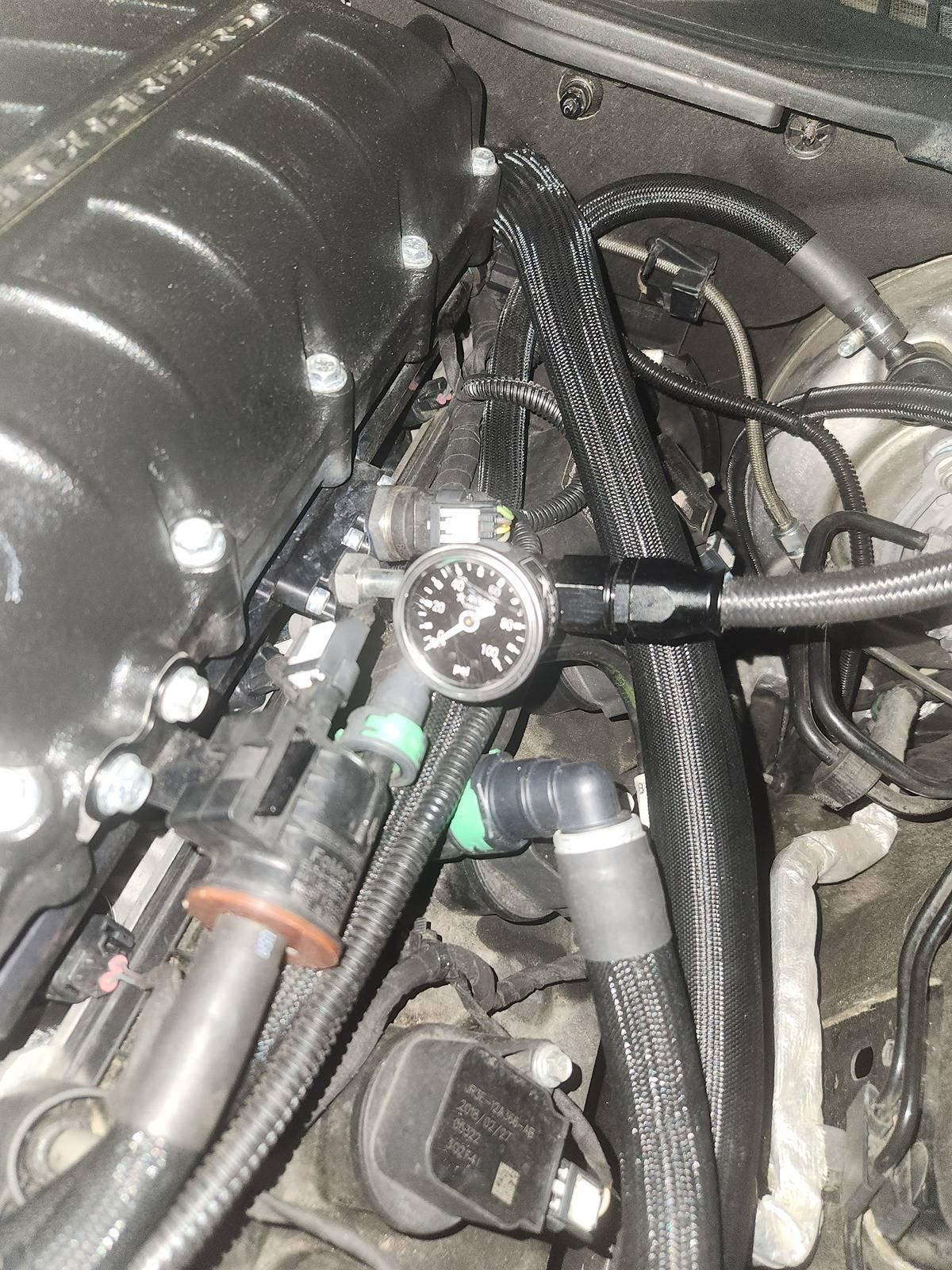

I guess I meant a remote pressure regulator, not one attached to the pump assembly, but cool that you can change the pressure on that one.
Anywho, you can use AN fittings instead of that silver quick connect fitting to prevent that from happening again. Use a -6ORB to -8AN male, then use this -8AN female to male with the NPT port to keep your pressure gauge.

Crazy that happened. @SheepDog has the right idea, I’d go that route. I can confirm that is a -6ORB fitting on that Whipple rail.

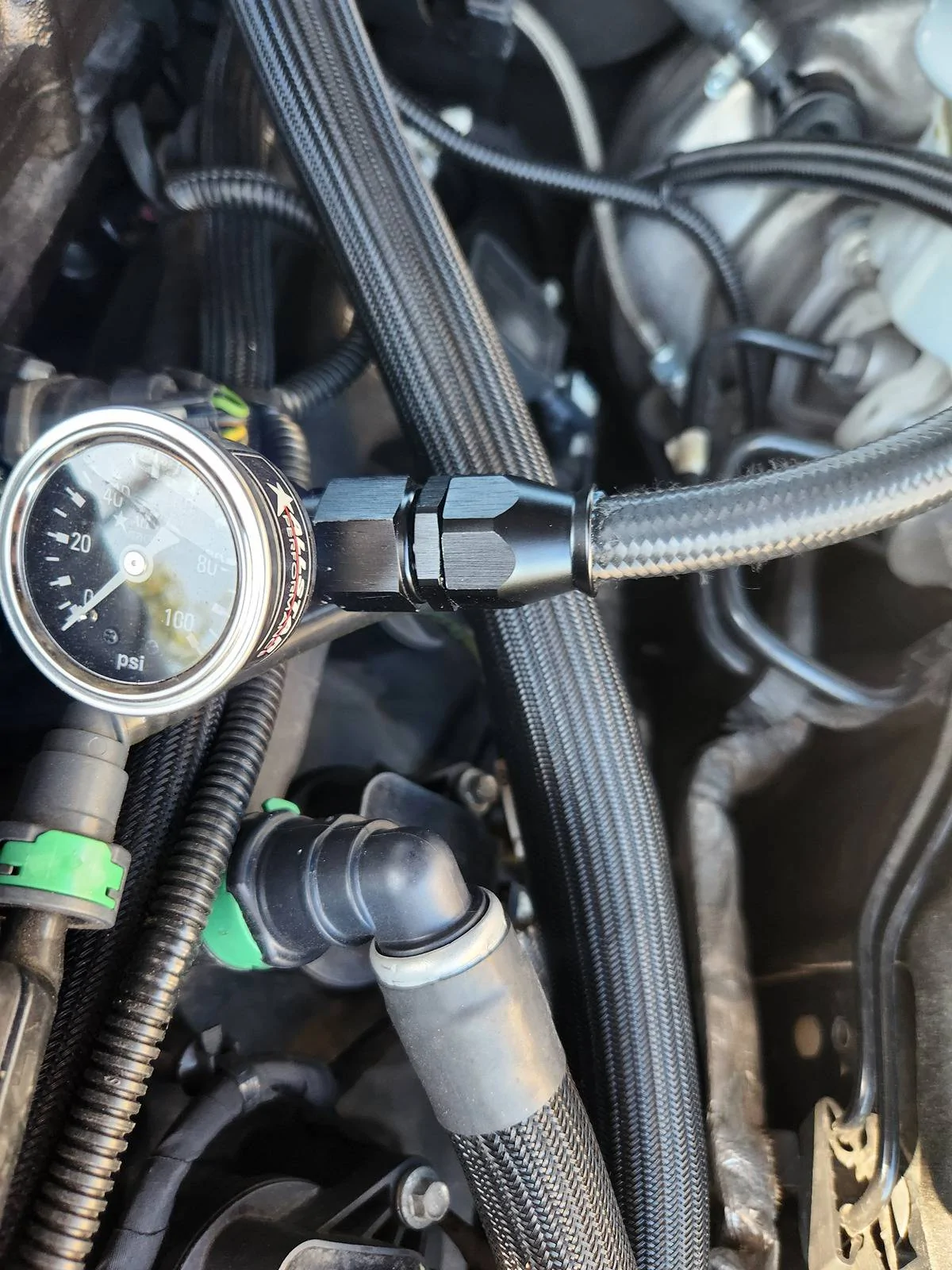

Although I can't tell exactly what you have going on behind the gauge, Radium(and several others) have a female quick connect that will lock on in a different, much more secure method.

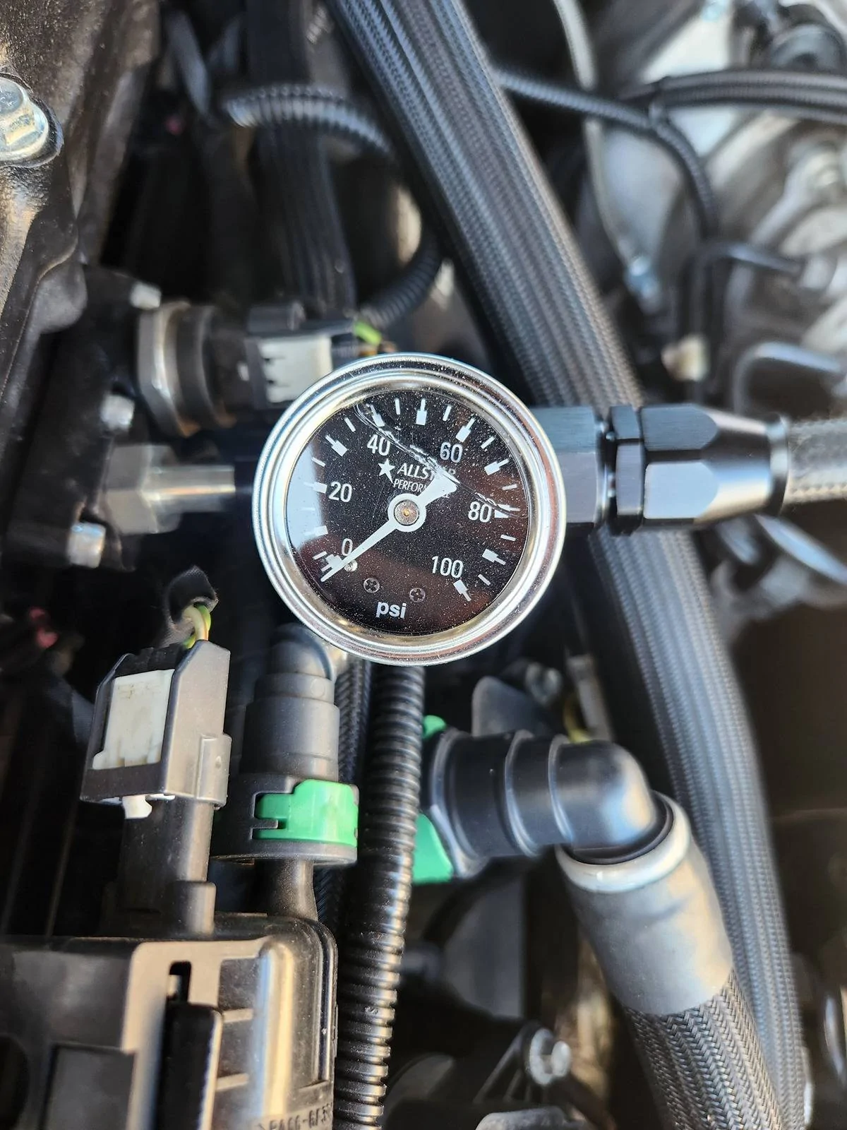

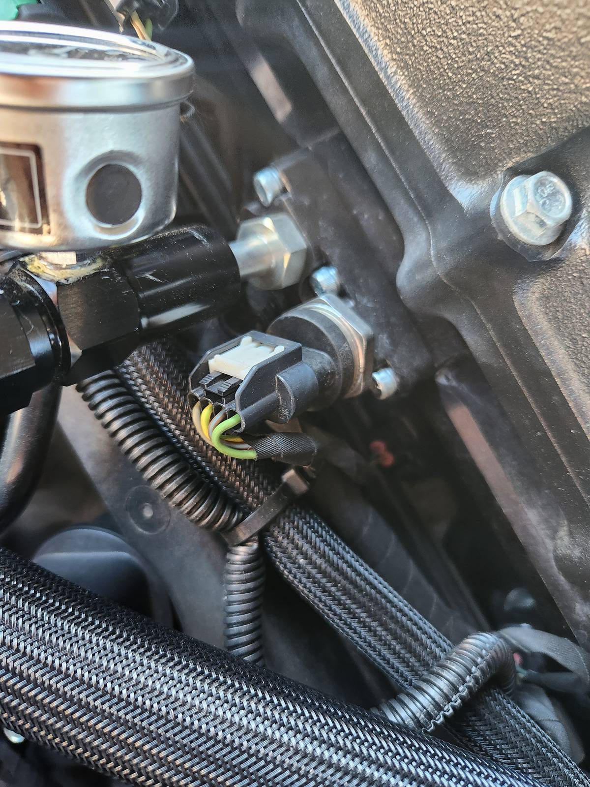

Here are some better pics of the current set-up. The fitting on the Whipple rails was designed to re-use the OEM fuel connection, and the Arcane system was specified to use the Whipple rails. I am going to go by the local speed shop and see if they have the fittings there, if not, I will have them order them for me. When that fitting blew, it sprayed all over the drivers side header and the top of the engine. Once I popped the line back on, and the car started, I doused everything with water to dilute it. Other than the smell, it was all good. Drove it yesterday for about 30 miles and this morning to work, 17 miles. So far, not a hiccup. I can literally move the car grabbing and pulling on the hose, so I have no idea what precipitated that thing coming off.
