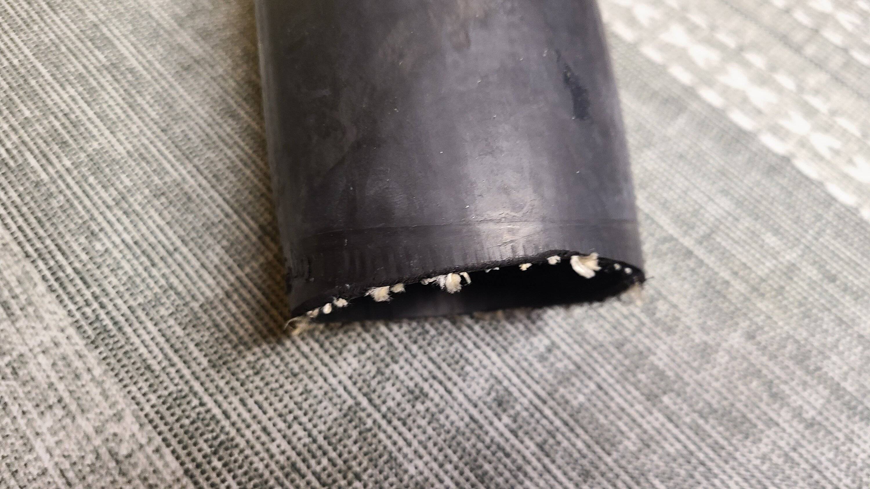

Well it was the lower hose feeding the intercooler. It was cut a little short on install. I need a new one so I can cut it longer than the old one was. Hopefully I can find better clamps too.

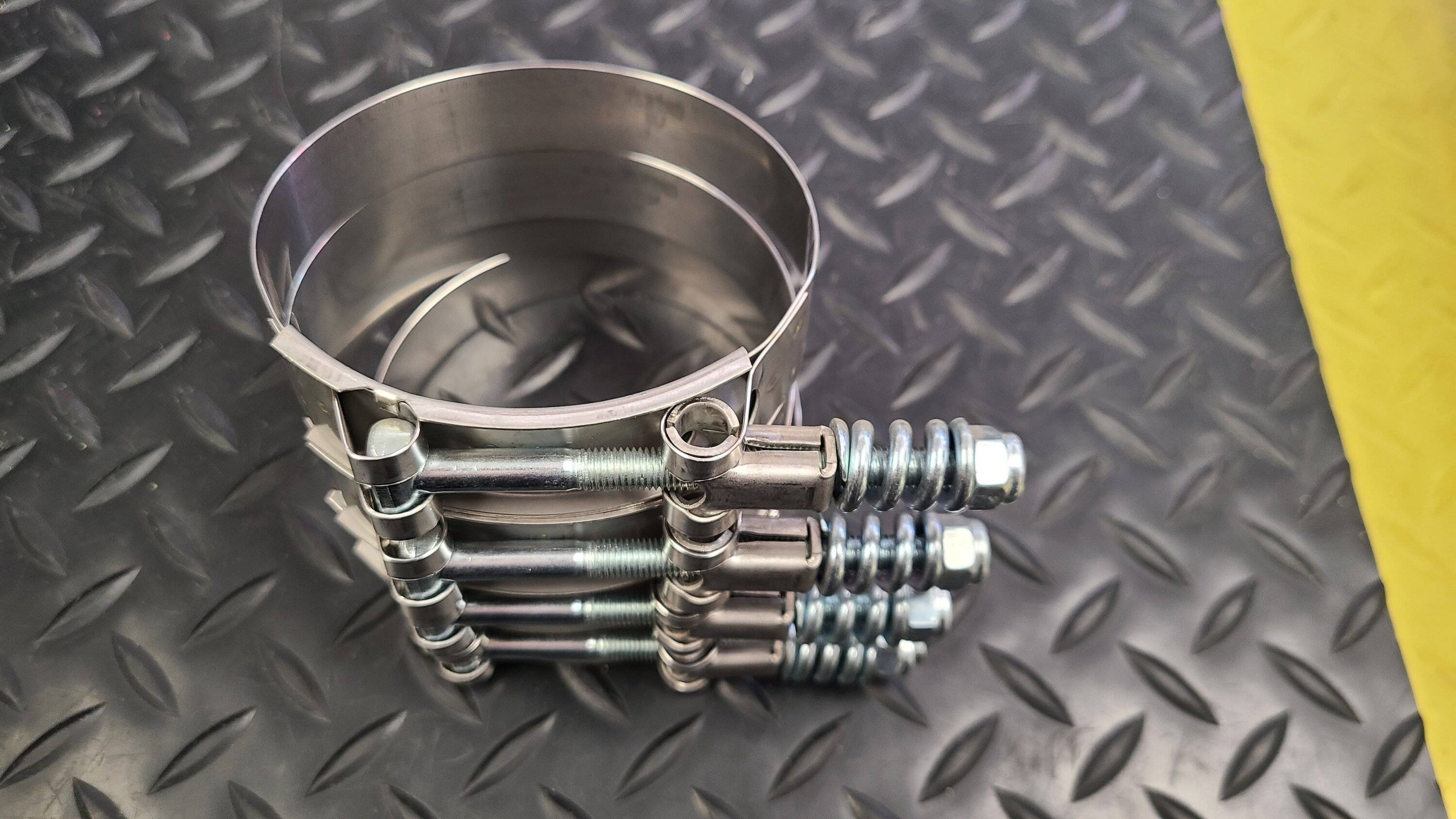

I used H/D T-Bolt clamps on my P1X from day 1. T-bolt clamps have a radius on the band so they won't dig in and potentially cut the tubing.

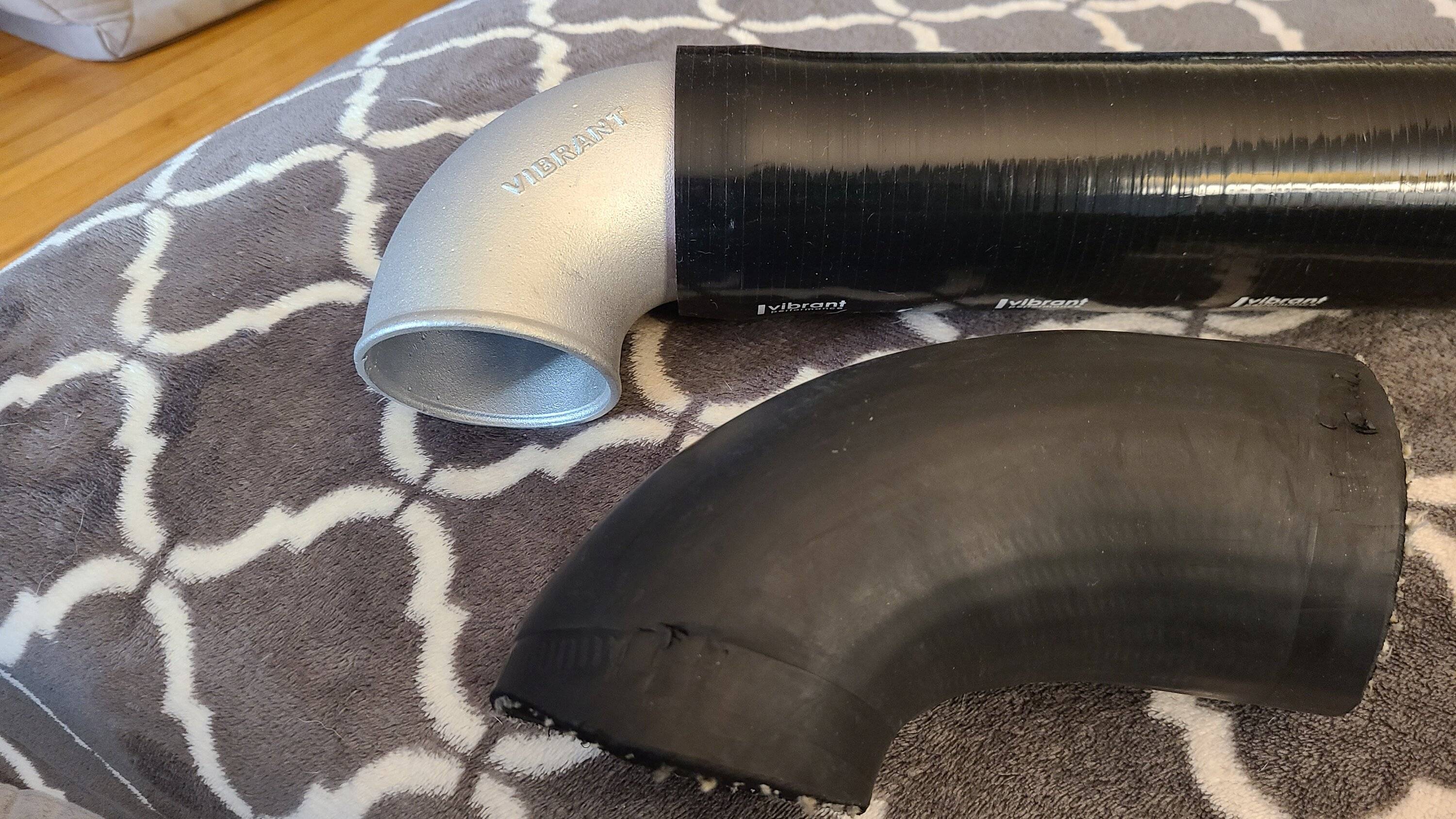

I ordered an aluminum 90* elbow, 12" of 3" 4 layer silicone hose, and 4 t bolt clamps. Should future proof this charge tube. Using tubing instead of hose for the 90 will make it stronger.

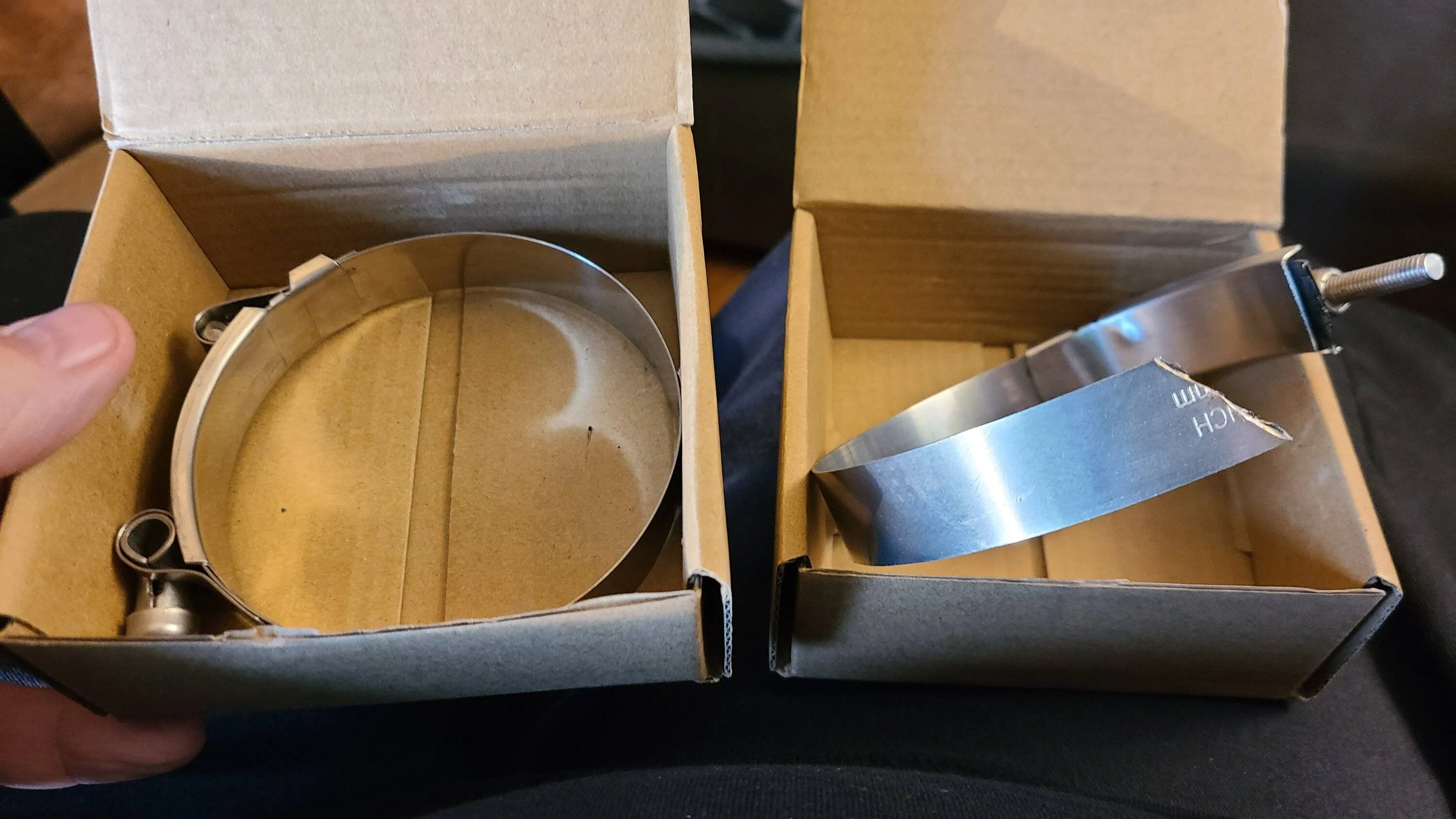

Amazon strikes again. Ordered 4 T bolt clamps (2 two packs) and received 1 new clamp, and one broken clamp.
Had to go to a local truck parts place for new clamps. Double the price, but have them today, and seem to be much better quality.
Compare the new elbow and silicone tubing to the old PC supplied rubber hose. I just need to cut to the exact lengths I need. These should be far more rigid, and build boost quicker!
This is how these kits should come. Procharger could at least offer a premium install upgrade option, which would get rid of rubber hoses and Worm drive clamps and include all metal 90 degree bends with silicone connectors.
I guess I will continue to upgrade the rest after fixing this one.

Agreed, for the price point, most if not all the flexible piping should be silicone. Be sure and get some acetone and wipe the inside of the silicone tubing, they use some kind of release agent that is somewhat greasy and could cause the tubing to slip.

That being said, I bet I have personally installed 20+ of these kits, and now my GF is on her second install, and I have never had that tube come off, or a worm clamp fail. BUT, I am very slow and picky about how to trim that rubber 90, because its pretty easy to cut it to short. (and if its to long, it pinches over itself).

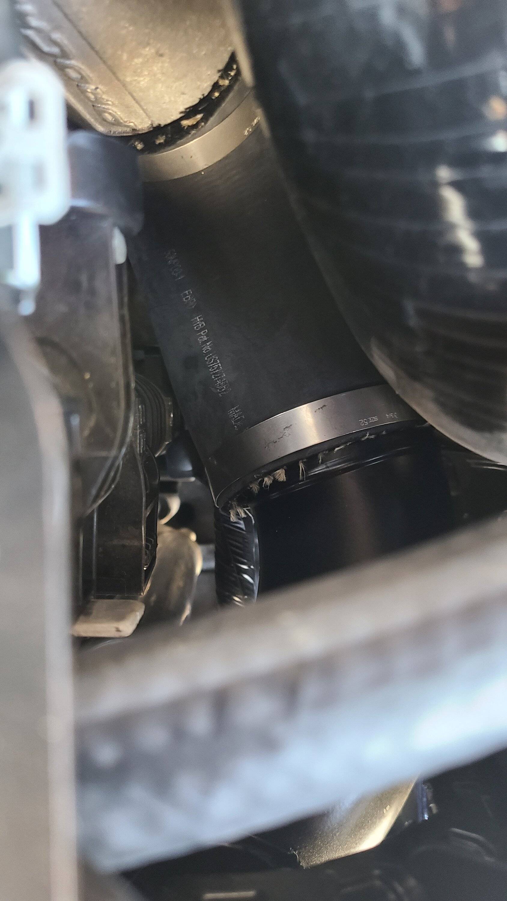

Tried installing the rigid 90 elbow and there is just not enough room. I am stuck until I get another hose for this thing. Not having any luck sourcing silicone j hose anywhere. I might have to go back with rubber until I can get the silicone one. It is a B!tc# to change, because my hands really don't fit in there either. I wish the installer would've left 1/2" more on the hose, I'd reuse it.

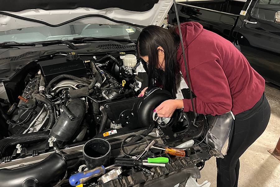

So the way my GF and I do them, is....
We mount the blower first, then slowly trim the "short" end of the 90 about 1/4" at a time... each time sliding it under the headlight and up onto the blower outlet until it fits without a kink.
Then we clamp it tightly with the worm clamp so that it can't really move. Then work our way forward toward the intercooler.
It usually takes us like 2 or 3 cuts to get it right. Which isn't the end of the world, but it will be nice once the "one piece" silicon hose finally comes from the vendor.
