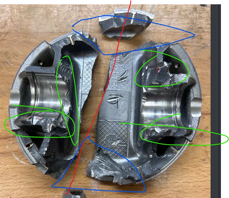

Anyone seen a gen3 piston failure like this?

Yeah, someone probably did something wrong (and it wasn't ford) but that doesn't matter anymore.
I guess this is where we disagree. I believe it does matter because something can be learned from failures to help prevent them in the future.

............ you boosted a NA motor with hyper-eutectic pistons.
no this is not a common failure mode, even in SC applications, however, it is FAR more common once you start forcing pressurized air into those cylinders because A. the part failure odds go up and B. the tune now becomes very important.
you boosted a motor and it let go. no mystery here.
I think you might be missing the point of the thread. The question was, has anyone seen a failure in this manner - not "why did my piston fail". The connecting rod, yanking itself out of the piston is not a common failure point, boosted or not. Failures that are typical with excessive cylinder pressure include blown head gaskets, broken ring lands, melted pistons, spun bearings, bent connecting rods. Failure of the type they had - I guarantee is not from tuning
Maybe I am missing the point, I don't see the mystery.
To me it looks like the piston cracked allowing for the wrist pin to be yanked out from the lobes that would otherwise hold it in place.
my theory:
step 1. red is the first split.
step 2. blue is where after the split the piston halves twisted and fractured more.
step 3. green is where the lobs got ripped off after the piston halves could rotate more than the lobs could bear.
all of that probably happened in less than a second.
a forged piston wouldn't do this, hypereutectic (super fancy cast pistons) are really great but once they crack its donezo.
my theory:
I think the concern here was that- a cracked piston is generally caused by detonation. Yes, a forged piston is a lot more robust, and less likely to crack, but they were not experiencing knock during this event (evident in the log). So, they wanted to see if anyone else had a failure in this manner, and if there was a determining factor. Very well could just be a manufacturing defect in the top of the piston, and the extra boost and timing found that weak spot.
Many other stock Coyotes hold together at this power level, but obviously the expectation of OEM lifespan should not be considered when subjecting the engine to forces well outside of it's design parameters. Honestly, the fact that a Coyote can tolerate this behavior at all is a testament to the design and quality of parts that Ford uses.

If the prevailing failure theory is correct, then it's more of a statistical thing. Even stock NA pistons fail, so any additional stress will increase the failure rate. We've seen 1050 rwhp from a PD blower on stock pistons hold for at least a few dyno pulls....could last forever...could fail on the next hit, but for sure the chances are higher than with 400 rwhp. That said, I've heard it stated that 850 rwhp is the sweet spot for a stock coyote and 10r80. You can generally make on live a long time at that power level.
The owner is going wtih Mahle 10.4/1 pistons and GT500 rods. It's an interesting combination, but should be very strong and more forgiving.
