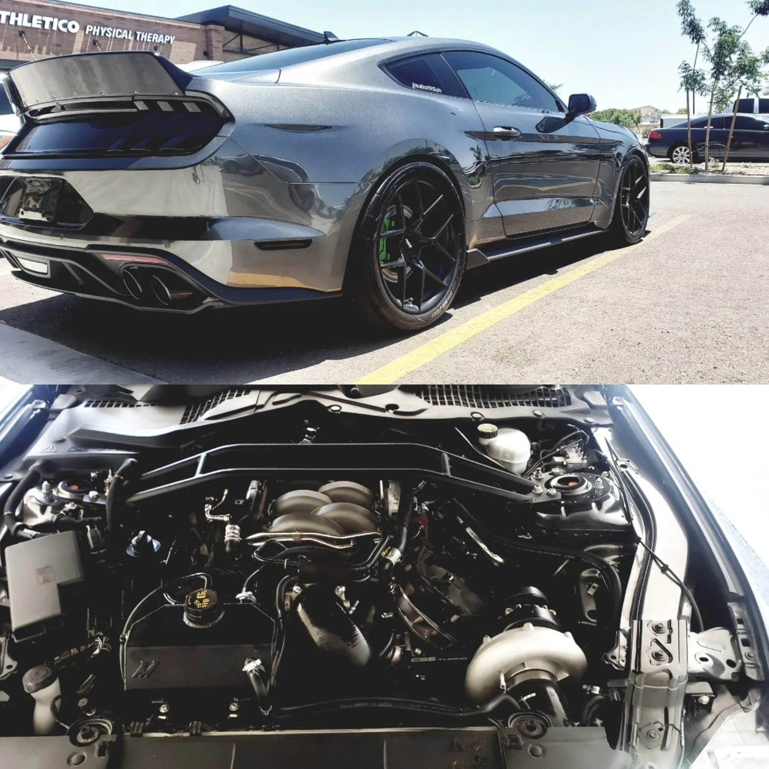

Currently 720whp on there G2 kit. Running 9lbs boost, 110mm pulley on 91 and boostane. Car is Currently in the shop as we speak upgrading to G3, Fore innovations fuel system, 105mm pulley and E85. My tuner estimates 850-900whp easily! Just fyi

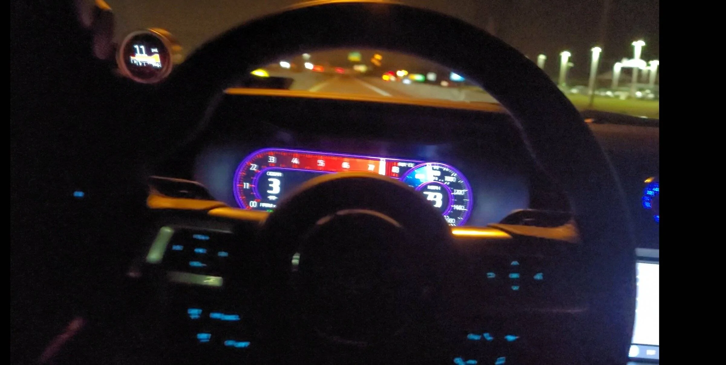

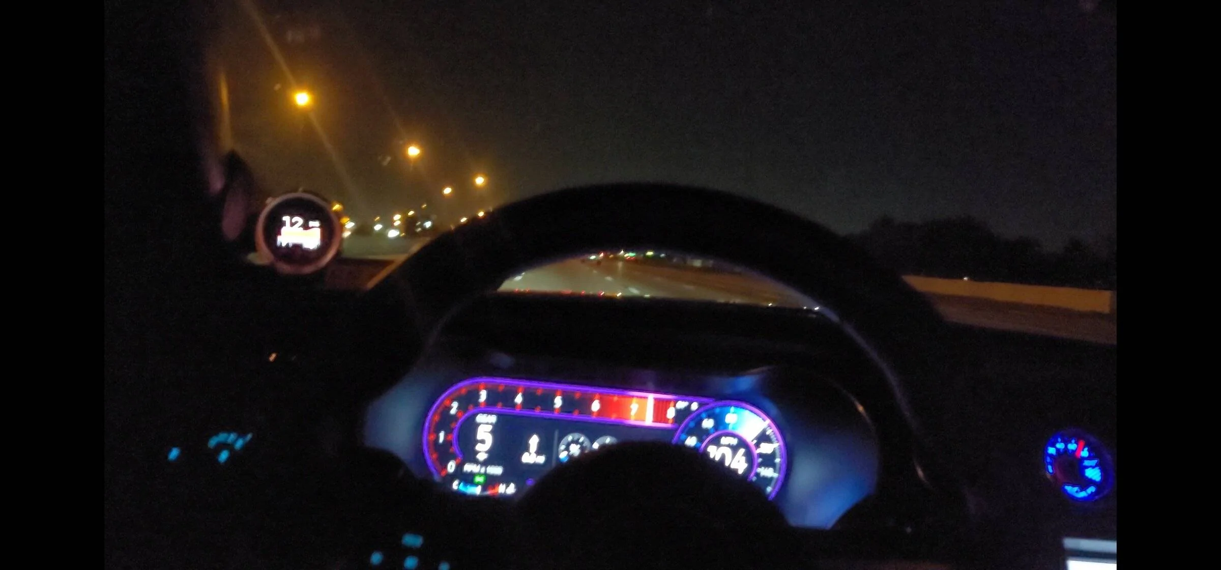

I don't see the risk of blowing up your engine as ESS gives specifics on the smallest pulley you should run for your setup.
The pulleys they recommend are actually pretty conservative, a lot of people run smaller pulleys than they recommend (me included) and are doing fine.
Personally my pulleys have been mostly spot on.
I have a G2 with the 105mm/11 psi pulley (Now on the 100mm), stock TB, stock IM, catless headers but running the magnaflow tru-x resonator with 2.5 inch connect so quite restrictive.
I've seen 14 psi when revved to about 8000 but at 7500 I'm usually at 11 - 12 psi
