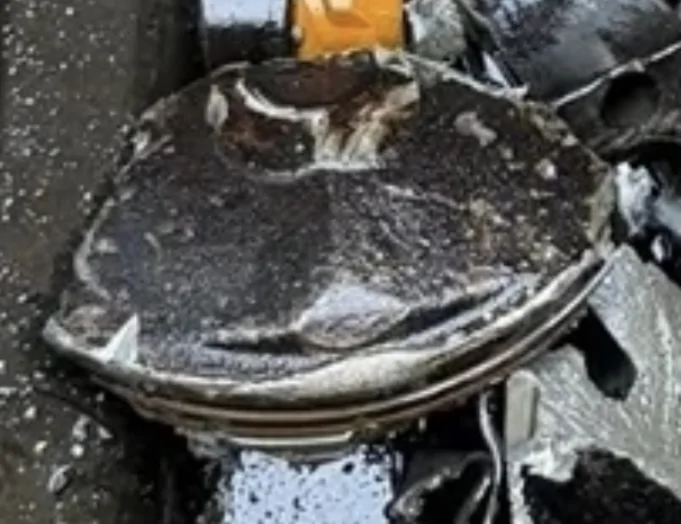

Anyone seen a gen3 piston failure like this?
