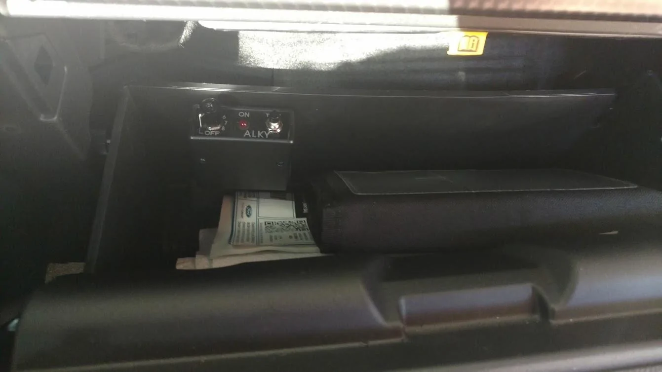

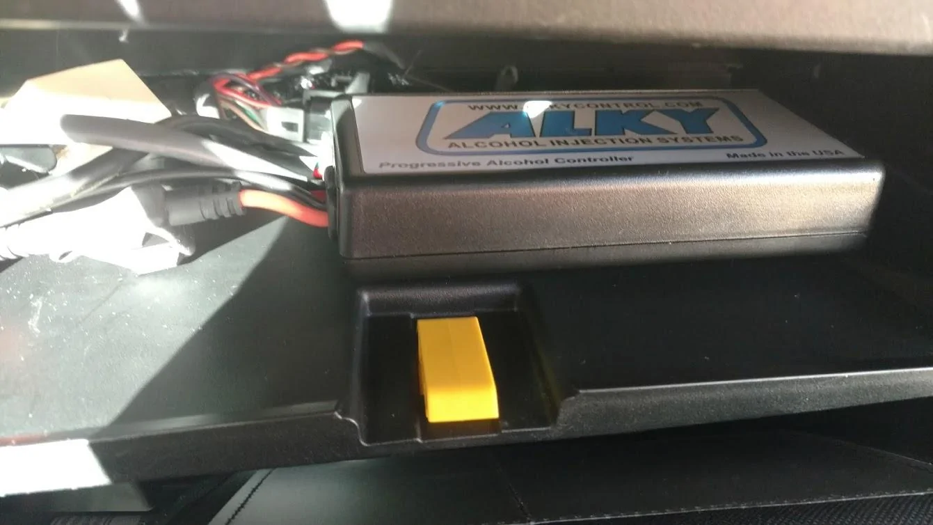

No pics, sorry. But I mounted my controller in the glove box. using the 3M dual lock to hold it on the back wall but be removable to adjust settings. Then I ran the "gain box" to the center console and mounted it on the back side with 3M tape. After its tuned you will almost never need to access any of it. Only the gain box once in awhile when you want to hit the test button. No reason to have it visible all the time. I mounted my injection and low level LEDs in the A pillar near my gauges.

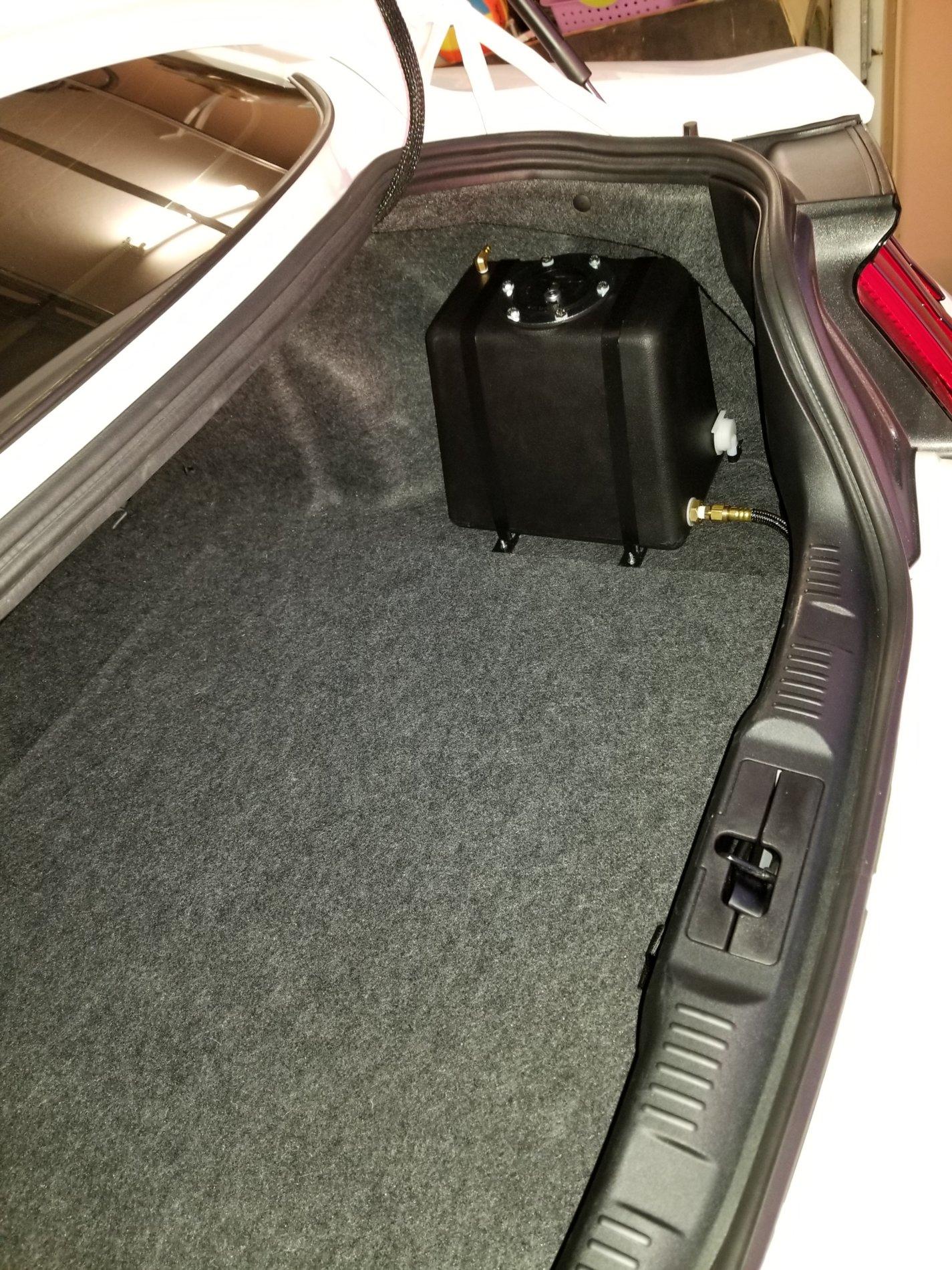

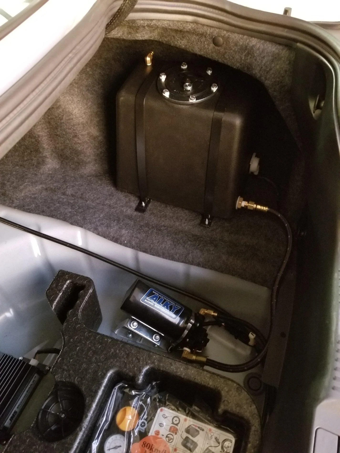

I mounted the map sensor behind the glove box fabric flap thing (where interior air filter is housed). My grey controller is mounted with velcro in the upper glove box where the owners manual goes, that way its completely hidden. I drilled a small hole and mounted the black box/gain dial in the lower glove box also with velcro. Completely hidden and easily removed in the event it needs servicing. My pump and tank are in the back of the car, but same principle. Also, I tapped into the factory washer reservoir sender wire so my low washer level light will illuminate if my meth tank OR washer fluid tank is low.
