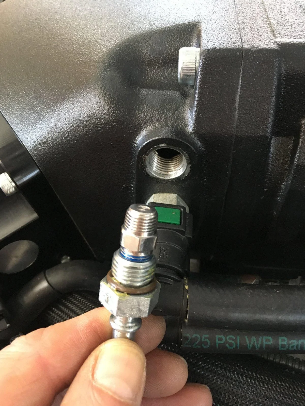

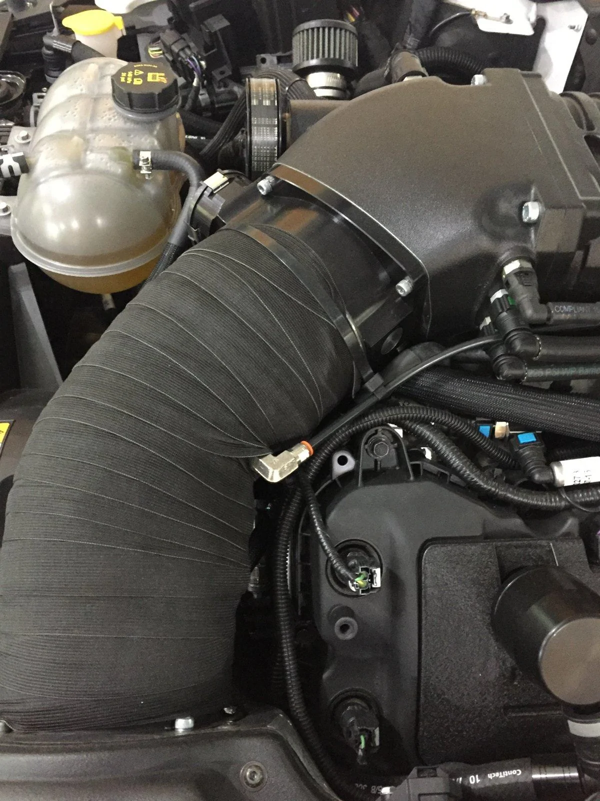

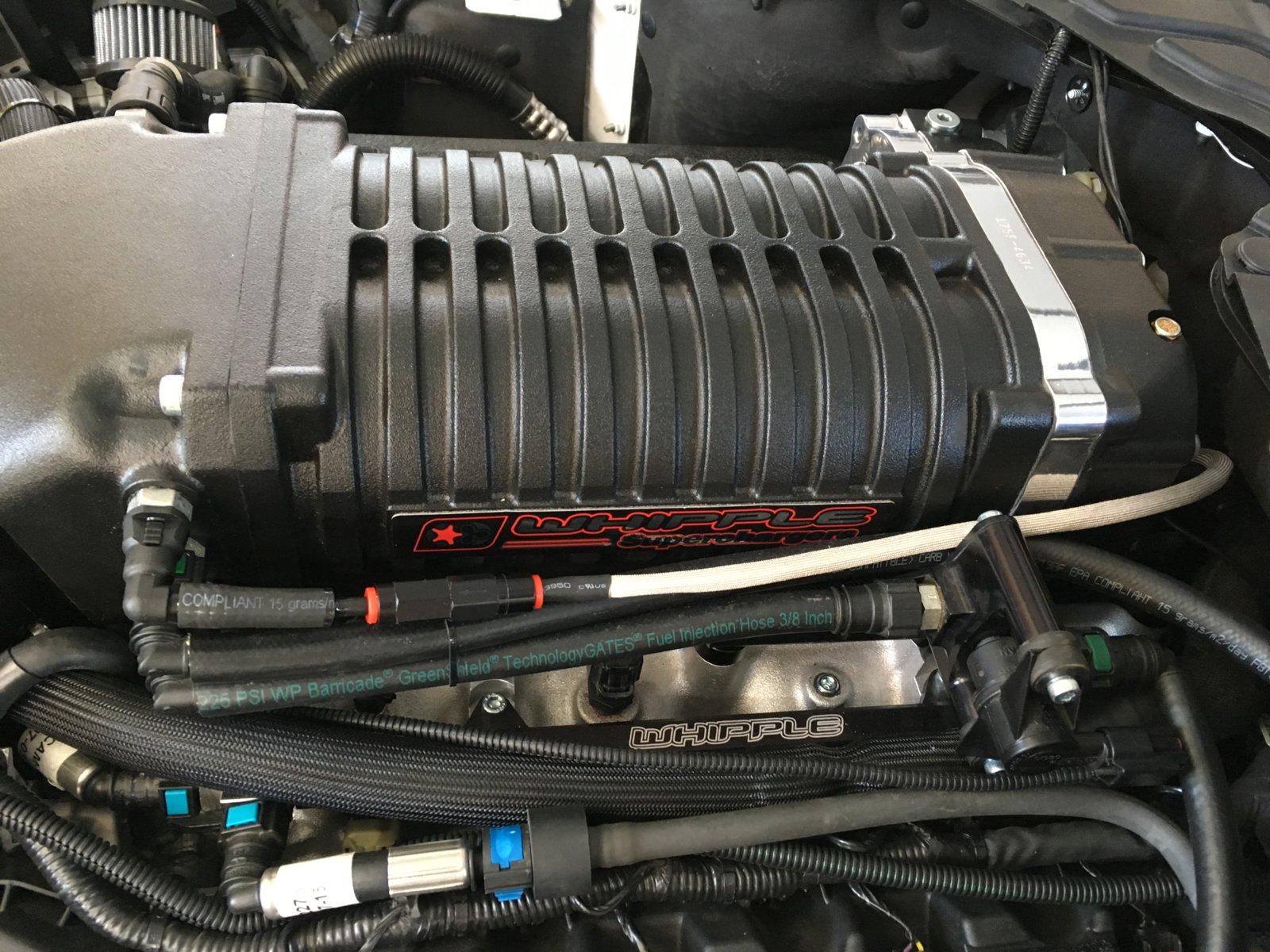

I have it in the elbow which is the easiest place and threads into the plastic just fine (bottom pic) I know have it in the whipple top 6an threaded port which I made my own custom setup there to make it fit. Both work fine though.

So is the connection in the head unit your boost reference? Or are you spraying in the plastic elbow and head unit?

As I said above I’ve sprayed previously in the plastic elbow, but now I spray after throttle body (vac, but not boost reference) in the upper part of the whipple 3 ports on the drivers side like in the pic. It’s not subject to boost there, only strong vacuum when throttle angle and load is low.

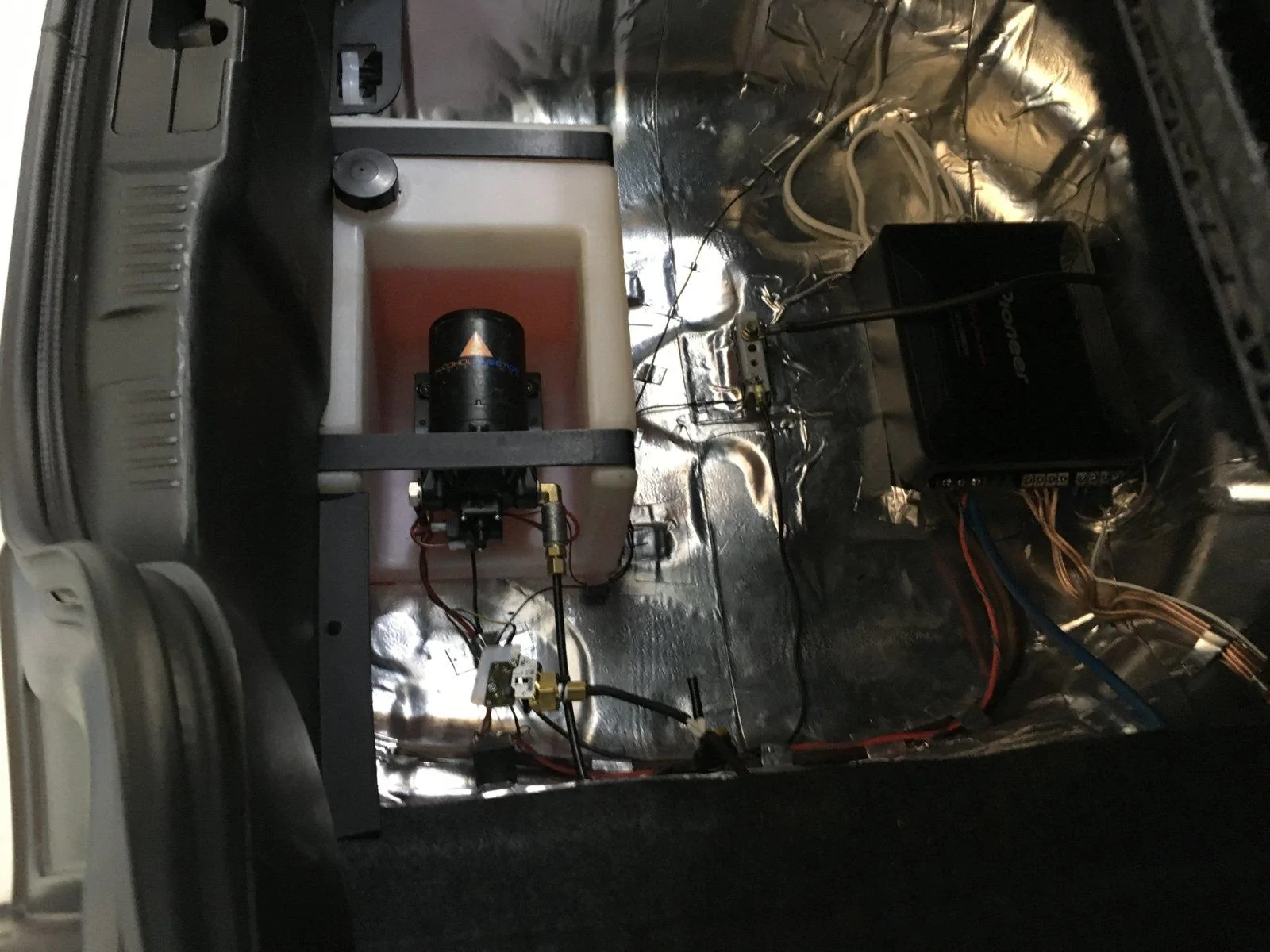

Mine is an amazing older AIS kit and it’s very basic all in at 10 psi on a boost switch. Would be much better to have progressive of course and even better to have the calibration fueling/spark tables adjust when meth comes on.

Did you notice any difference in IATs with the wrap on the intake tube?
