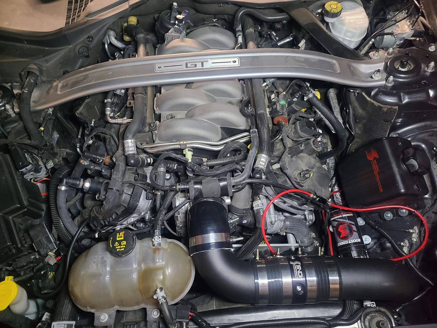

I run it with turbos not a whipple. Been running it for 4 years now. Not tuned for it but I'm using it for the extra cooling and octane. I'm running the snow kit but not the progressive. I use two nozzles that combine for 14gal/ per hour that spray above 5lbs of boost. The kit works good and keeps the engine happy. I'm injecting about 8" from the throttle body in my charge pipe. Here's a picture of the adapter I used to mount the nozzles.

Where are you injecting from? I love my meth kit but it has one issue where if I drive hard in boost and spray but then turn the car off, without enough drive time or without a little semi hard driving, it will start and die the next time I start it. Fires right up second try everytime. I've discovered I get a little liquid meth build up at the throttle body. I assume from letting off the gas at the end of a pull the extra meth puddles there and on a restart it sucks it in as liquid and that's causing the issue. Only happens in this exact situation. I'm injecting about 8" away from the throttle body with dual nozzles to help atomization but curious how others are doing it?
