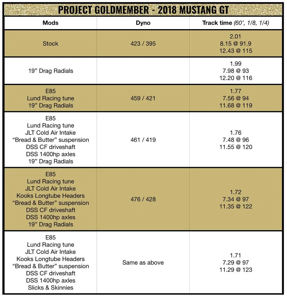

For torque a tune, headers and E85 is a great start.
LethalPerformance
Sep 5, 2014
333
3,273
2,034
Fl
2020 Shelby GT500 CFTP, 2021 Whipple'd F150
A custom tune for E85 or Flex fuel will make a huge difference over what you're running now. Add some longtube headers into the mix and that's about the best combo you can run until you add a blower/turbo into the mix.

Checkout the results we got on our 2018.
