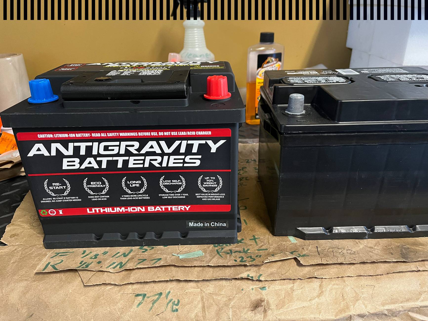

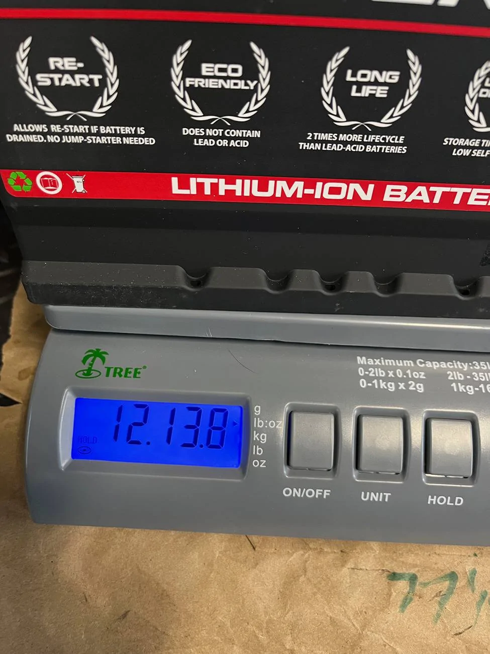

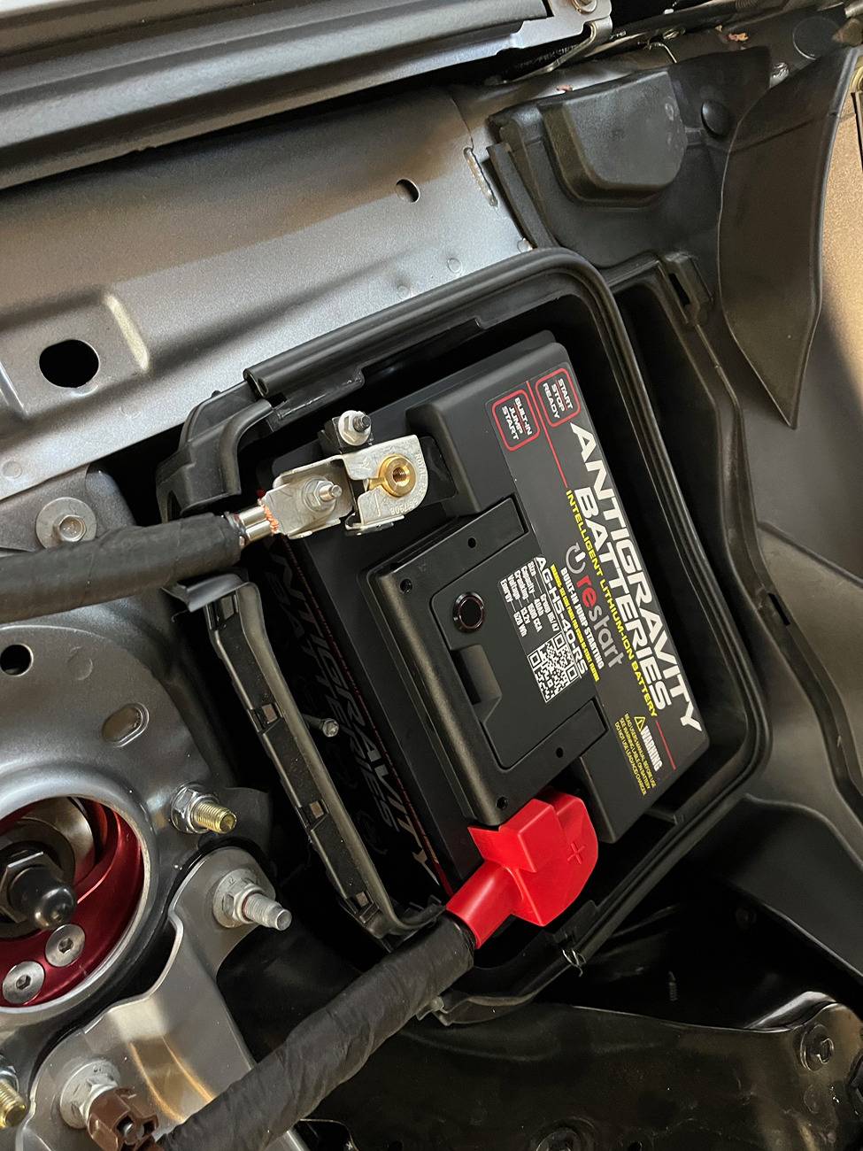

I went the AG battery route and had considered battery relocation option too. As already pointed out, relocation is a pretty marginal cost-benefit solution. I think the same argument could be made for the AG battery.
All these AG battery failures folks are experiencing I wonder about. Did those people all go for the 7-8 pound tiny battery option? I have the full-sized automotive AG battery. Going on 2 nearly 3 years of uses. My car has sat for 3-4 weeks at a time and starts up each and every time (I try not to let it sit that long). Have driven on two 2,500 mile trips with no trouble and generally have been satisfied. What about weight loss? My AG batter weighs (if I'm remembering correctly) 12-13 pounds and stock was something like 32 lbs. It's not a very good trade off in terms of cost but I've had good luck so far. I've been trying to "lose weight" without extreme measures and have my car at 3,780 lbs (Tremec trans) with full-tank of gas. Have full interior including back seat.
Anyway, it's a trade-off but I've had good luck with the full-size automotive AG battery.
