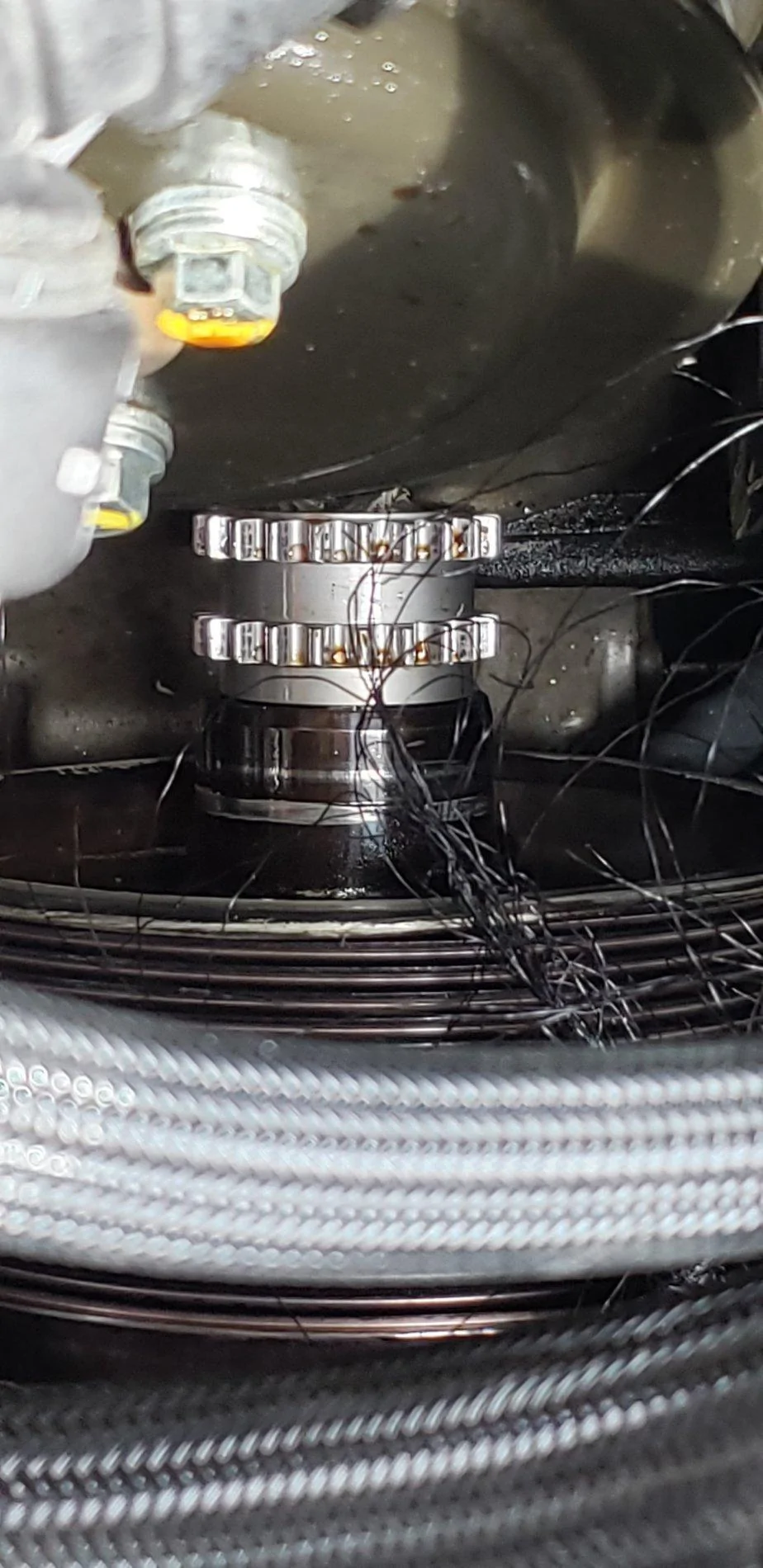

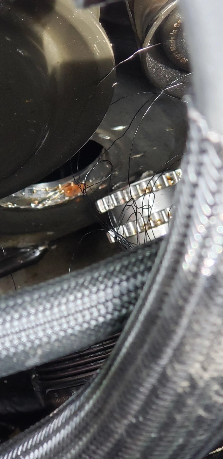

This car is making about 600. We did not install the blower so we cant verify that piece but it was throwing random codes when it came in. Check out the slop in stock timing gear.

I mean I get all the hate about not wanting to spend the money on a billet piece, but I'd never run a bunch of power without it. When my crank snout cracked it had the side affect of beating the snot out of the timing gear - but the MMR piece held together preventing catastrophic failure on my last 170mph pass. I know most don't track their cars but I think anyone that races would be crazy not to get the billet one in there.

My cars been boosted since since 12k miles, I just rolled over 30k. 650 wheel the majority of its life and 800 wheel for the last 3k miles. My buddys 2018 gen5 whipple A10 car imploaded the opg and ruined the engine at the track with less than 5k miles on the car. Scared me into doing it, went with the VMP OPG and crank sprocket with an ARP crank bolt. Did it myself, not a bad job just alot.

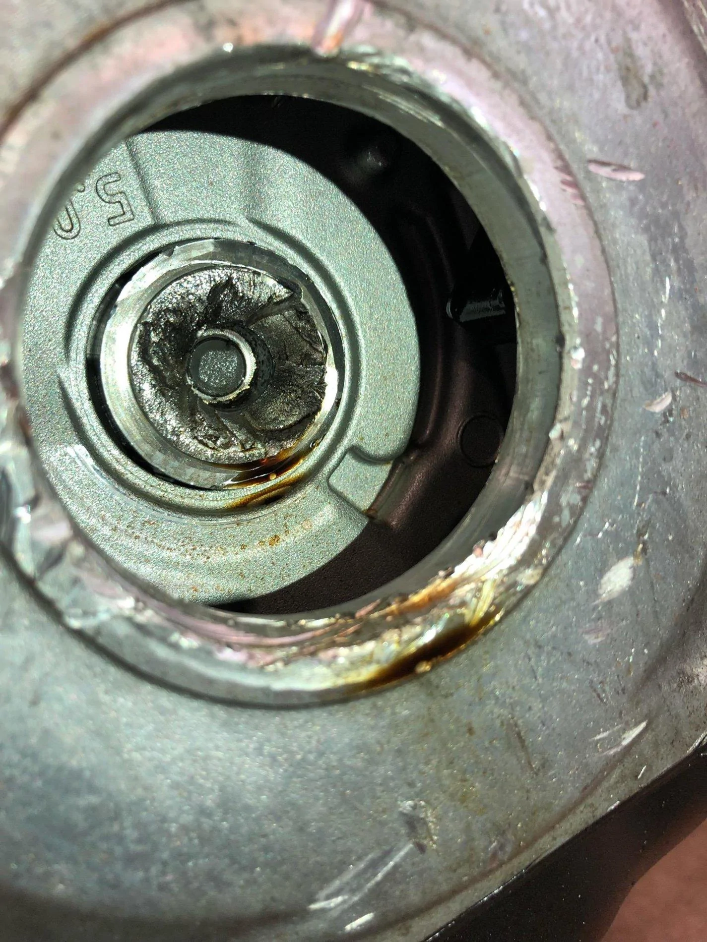

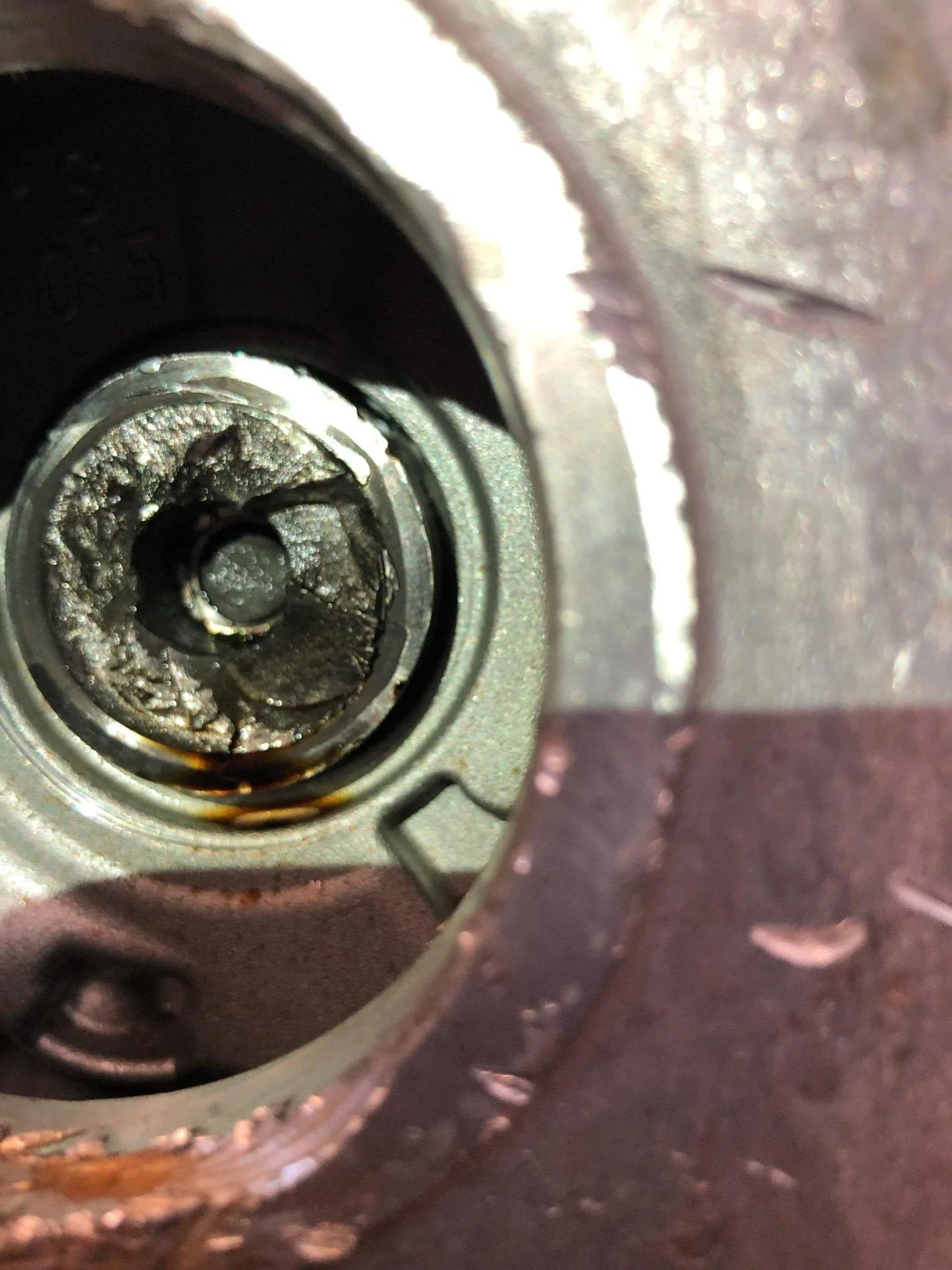

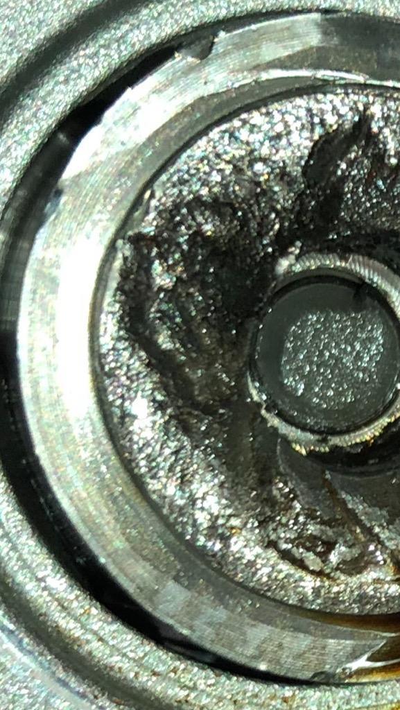

When the snout of my crankshaft broke at 12,800 miles , I was surprised how well the MMR timing gear held up. I ended up going with an aluminator crate engine which now includes upgraded oil pump gears and crank sprocket. I'm starting to think the crankshafts for 2015-2017 might have had manufacturing issues and might be more prone to failure. Interesting that Ford went with an improved crankshaft for 2018 and 2019. From my count there has been at least 7 forum members who have snapped their crankshafts so far.

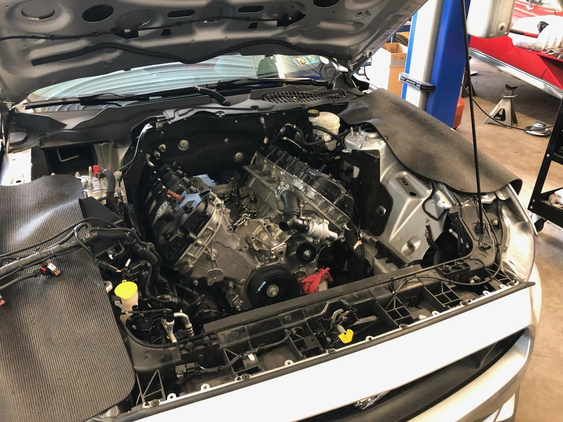

Some more pics of the carnage

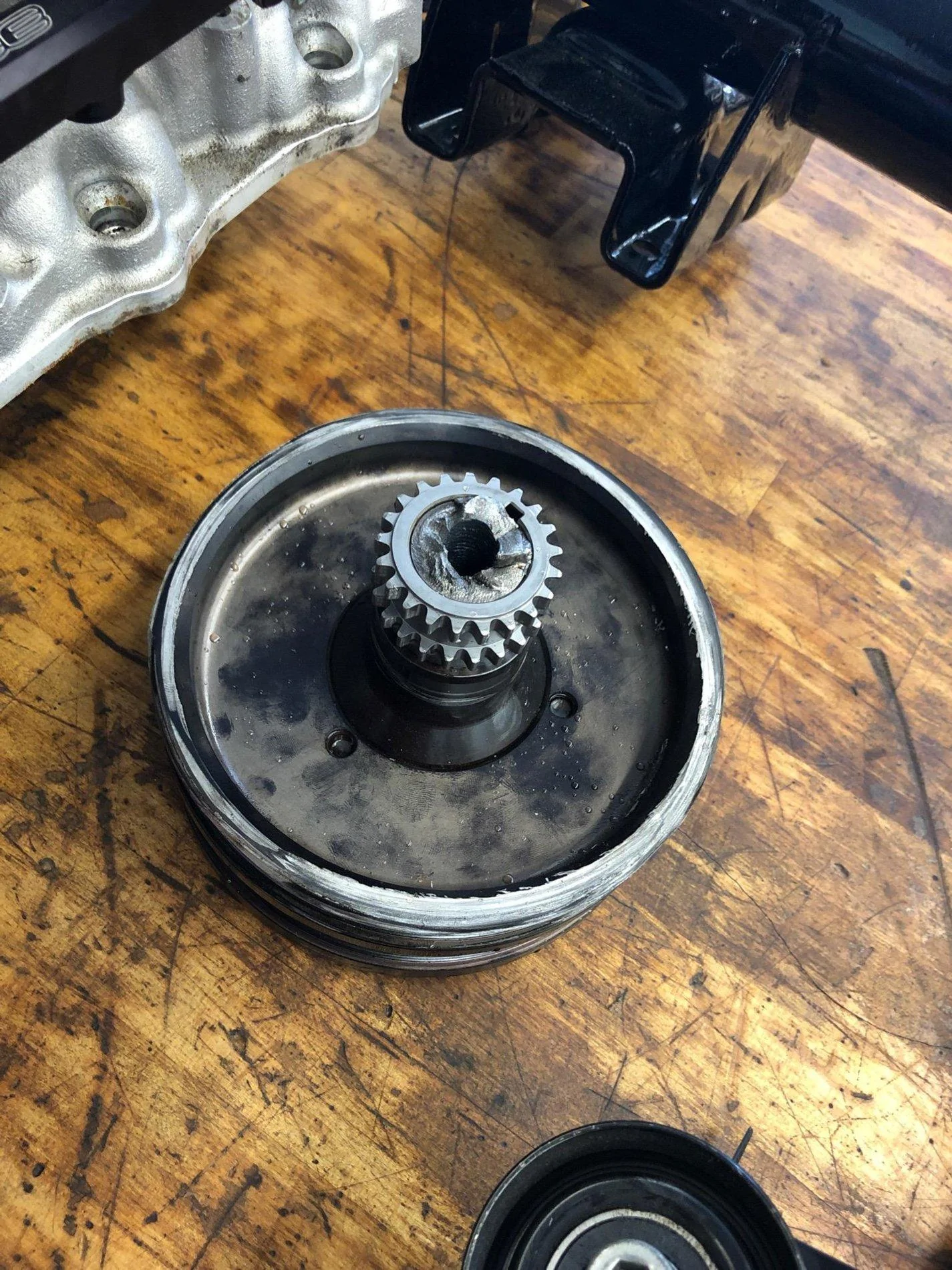

stang17
Jun 5, 2016
669
307
Wilkes Barre, PA
2017 GT Premium PP

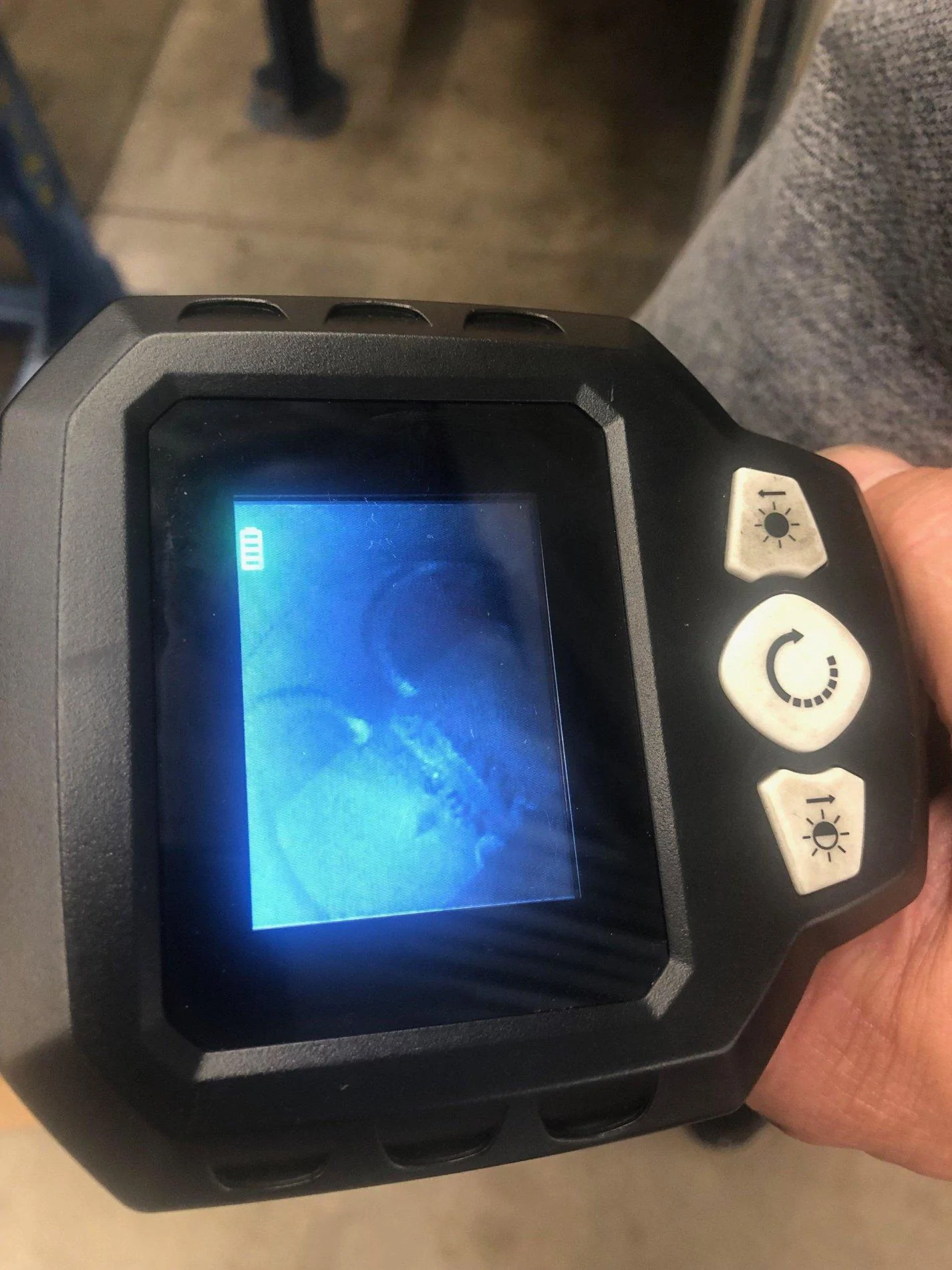

And some more...moral of the story is that even if you upgrade the crank sprocket, it still wont save you from the snapping the crank. We used the borscope to take a look inside...valves whacked pistons pretty hard. Scary thing is that this happened while cruising in 6th gear at about 2,000 rpm....totally out of the blue.
