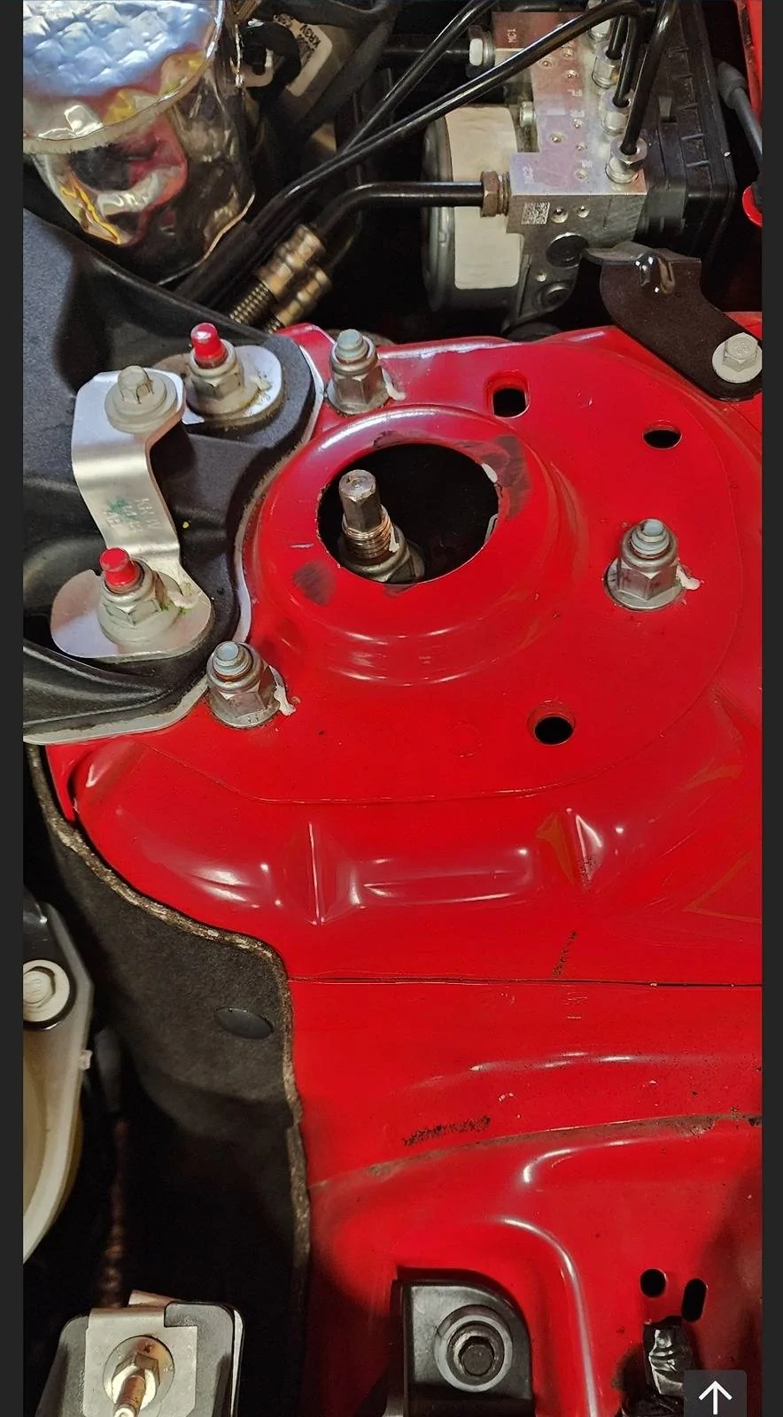

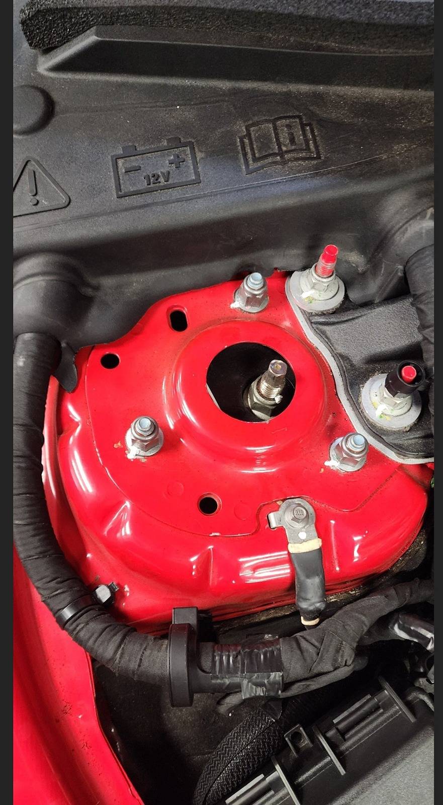

Are the camber plates adjusted with the weight of the car loaded or with the car up in the air?
I've seen a video with a tech at a supposed "Track Alignment Speciality shop" ask that same question, while torqueing on it with a pry bar. Then he proceeded to beat on a socket that's on the top it with a mallet. It eventually moved but even the "specialist" wasn't sure.
I have a car with them in full track setting and went to move them over myself. I'll have an alignment check later.
Is it as simple as loosening the nut and sliding it? Notice the black scuff marks on the car in the second photo. Mallet or pry bar from the previous adjustment?

To answer the above question, the OEM camber plates suck pretty bad in that regard. I have had to unload the suspension to get the camber adjustment to move. The problem with that is the suspension has to have weight on it and be settled for the camber setting to be accurate. So if you unload the suspension, you will have to take your best guess, reload the suspension and preferably drive it. Then remeasure the camber and possibly repeat.
I've never had that issue with vorshlag plates. The slide smoothly and I am able to get better results in less time.
Edited to add:
There was a comment in the above post that (what seemed to read as) I'll adjust the camber back to street...... if you change the camber, you will change the tow. You will require a tow adjustment if you go from track or street to the other.
When you align, always start with camber. Caster is fixed on the s550, so you then adjust tow once camber is set.
