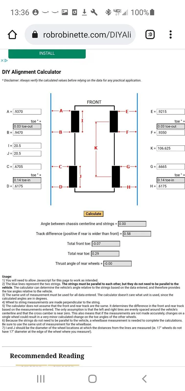

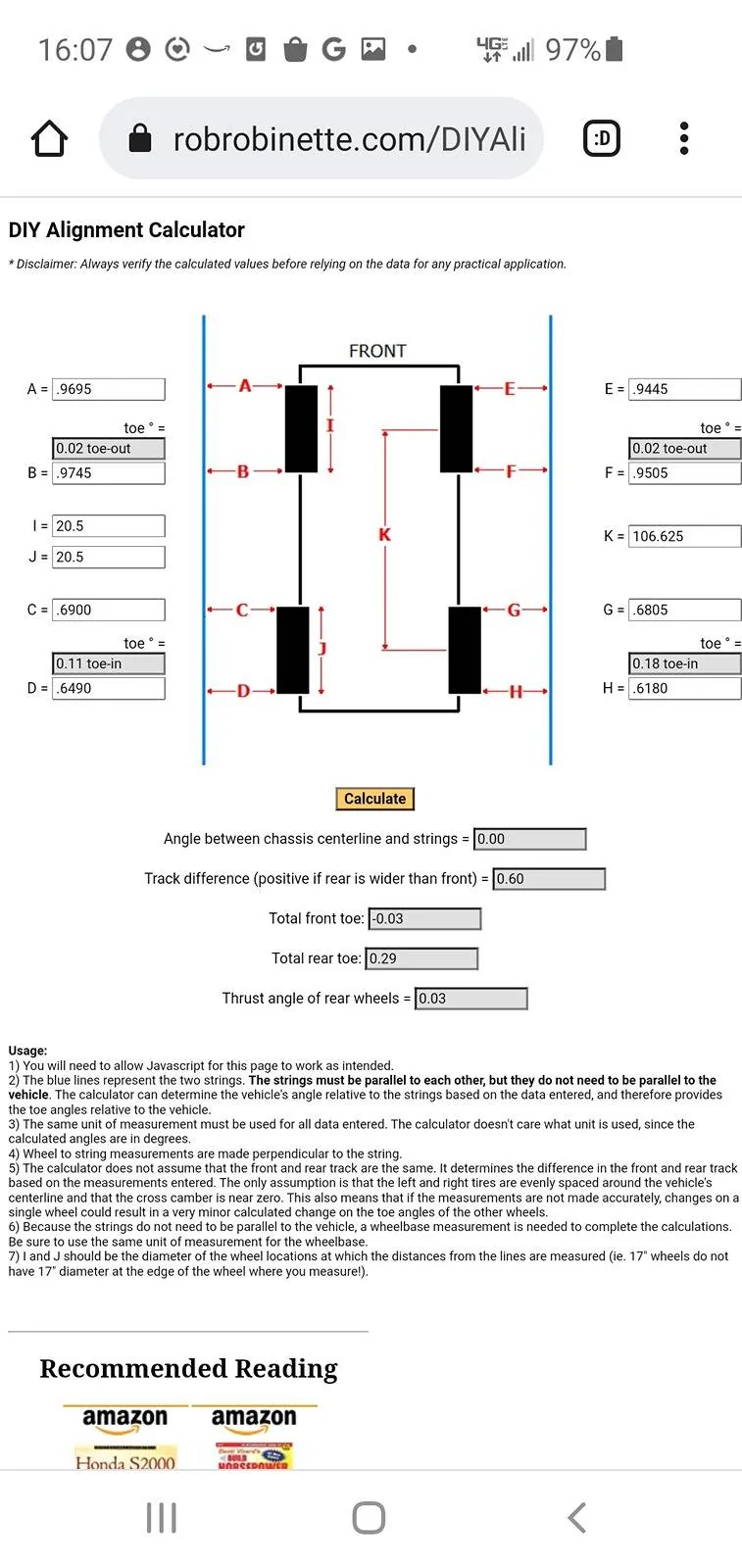

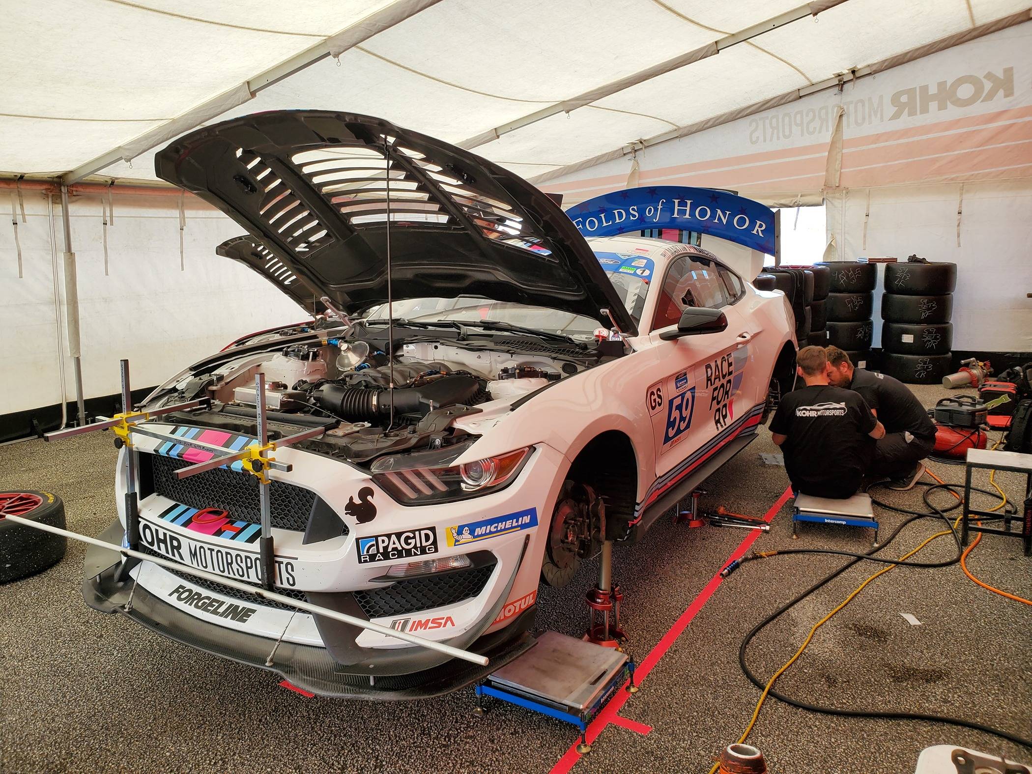

My alignments are out of spec if the measurement is a few thousands off.
With that said, you can do what you suggest, but it won't be accurate at all.
The best way is to either pay someone else or to stringing the car and do it yourself.

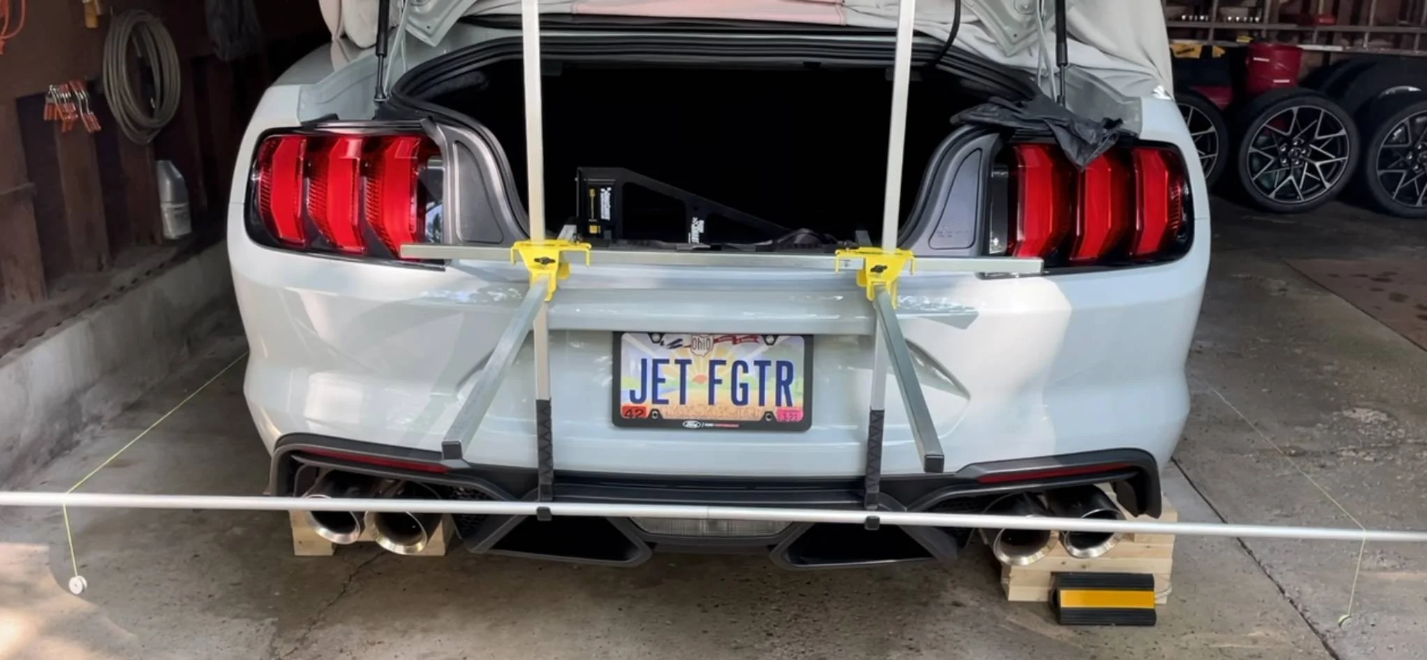

The measurements screenshot is a demonstration of the very small tolerances needed for a track alignment. A small adjustment makes a fairly large change.
The photo is the BG string kit that I use for my alignments. Pictured is Dean's old #59 GT4

I use race ramps wheel cribs to get the car up in the air so I can make the adjustments. I put turn plates under the cribs to aid in tow settings, otherwise, the friction of the tires interferes with adjustment. The problem with this method is that the car has to settle once you jack it to get the car on the cribs. So I bounce the car and let it settle over time.
If the car isn't settled, the adjustments made are not valid. So what I do is what I stated above, align the car, and drive it. I then re-string the car and verify the alignment parameters are correct or need a minor adjustment. I'll note the "settled settings" and use that as a delta to adjust what I have if I have to jack the car again.

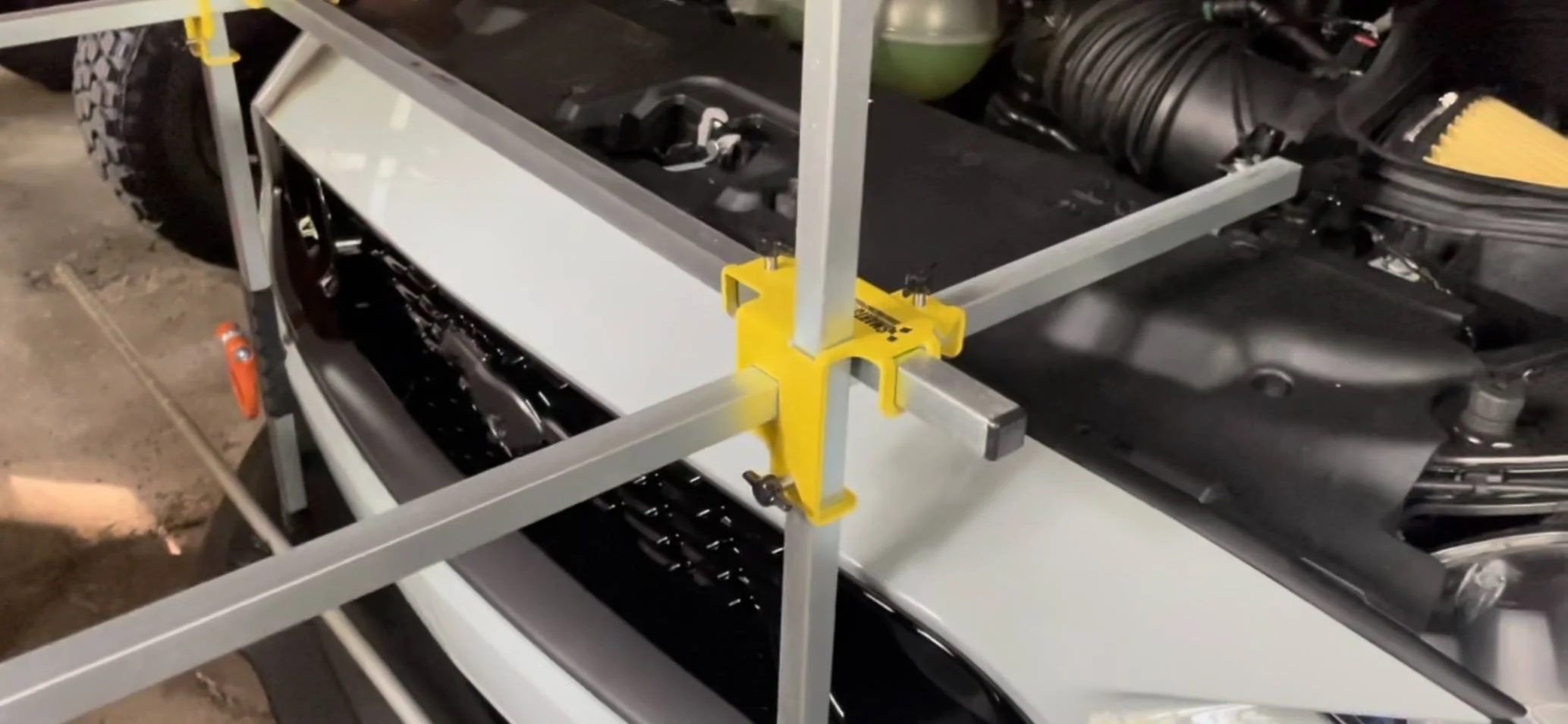

Might be time For me to finally get one of the "string" systems and learn how to use it.
I just mounted my DSP300 Hunter heads up to the front wheels, and there is no way TOE
sensors are going to see each other, with that splitter/belly pan (especially on a CFTP car).

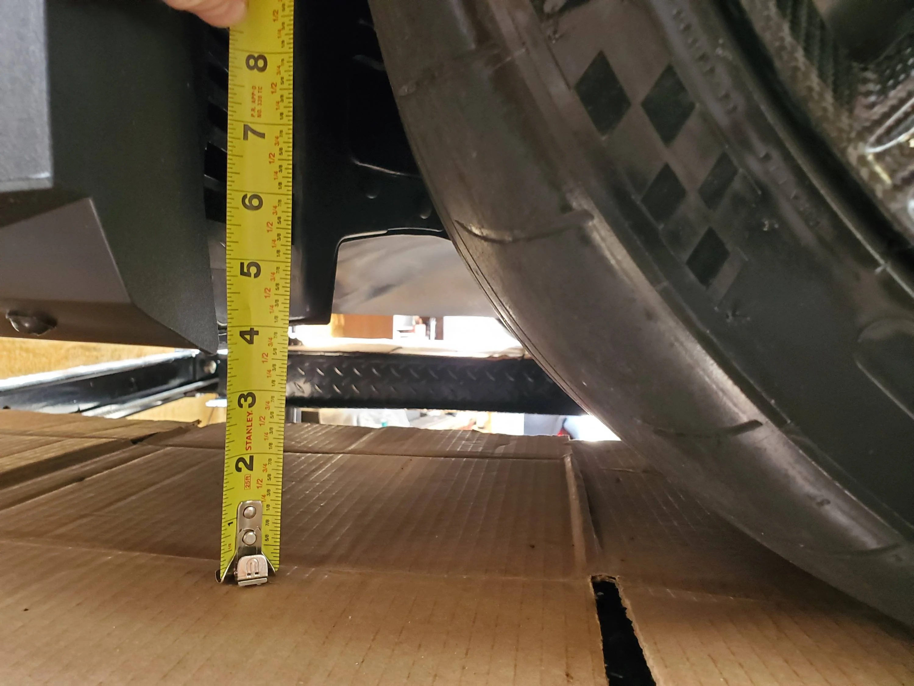

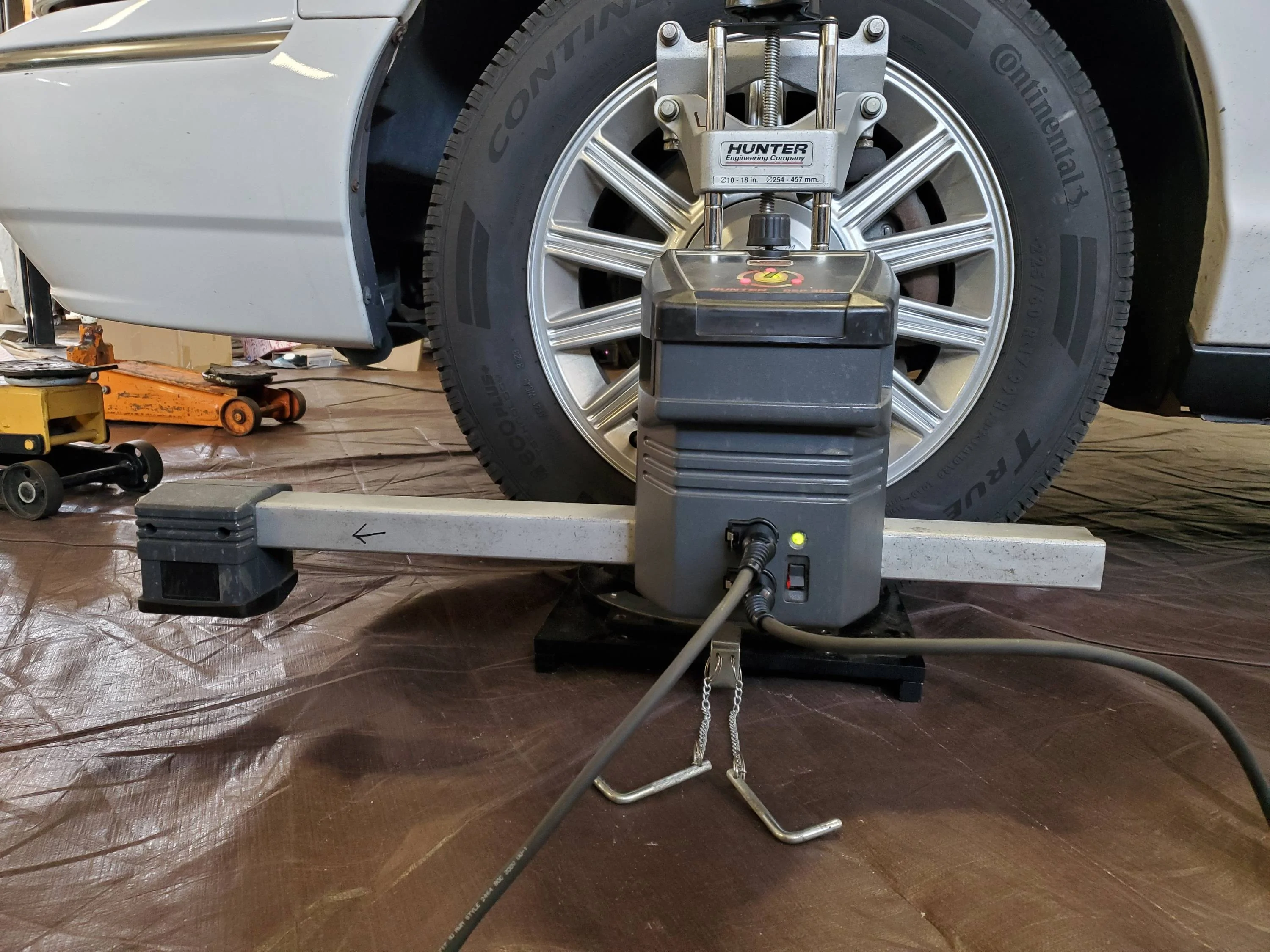

CFTP is 3/4 inch lower than not (so I'm told). My alignment system is older, so laser has to see other laser, under front bumper (or bumper cover, or edge of fwd fender, etc..).
This is the front head on my system (mounted on my mom's Grand Marq on the floor, just to try out something I might be able to use on the 500).
There is only 3.5 inch under the edge of splitter and belly pan on CFTP 500.
