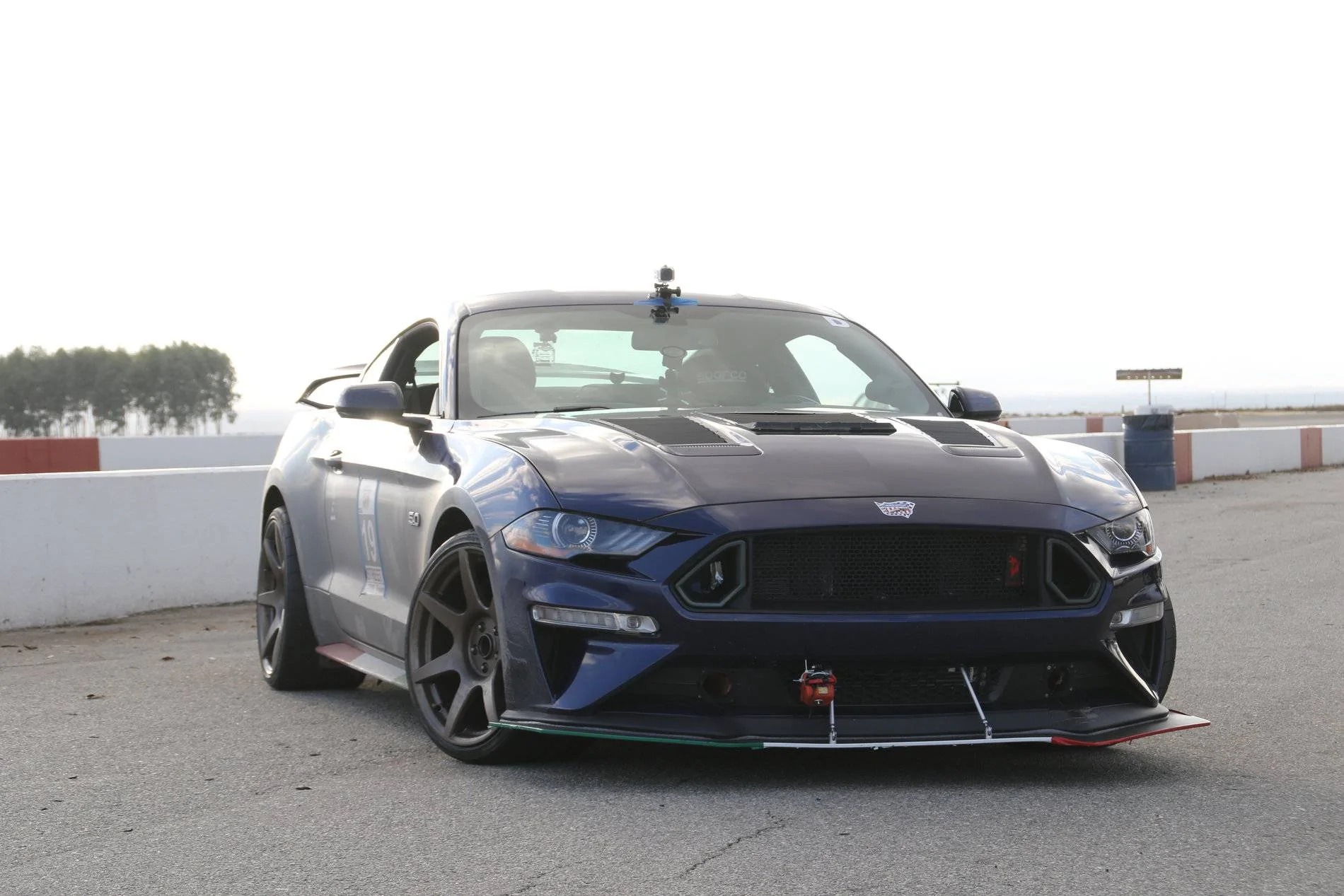

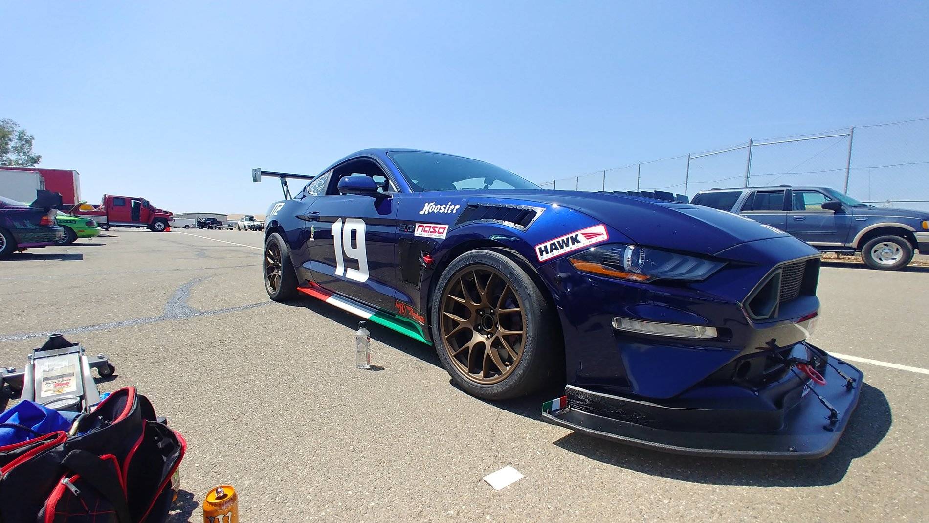

I had 350anderson (partial) replica and ZL1 addons on my pp1.
Few notes
The 350R wing ,according to ford perfomance generates 125lbs at 120mph.
300lbs is really too much (i mean maybe at 150mph)
The zl1 addons with chassis mounting was a nice piece. Before mounting on the chassis i saw big deformations on the oem pp1 splitter ,sign of "downforce" pushing down.
However
A splitter over 4' height is not really effective.
Pp2 splitter generates around 20lbs more than pp1.
Gpod Aero to work needs to be over 100mph to feel the effect...
Last info
Remember the hood vent you have in the car does generates DF. i think 20-30lbs if i remember well. So put that also in the equation.
Ps i have the Zl1 addons still at home. :)
Pps. Not i dont sell you the old anderson wing lol
