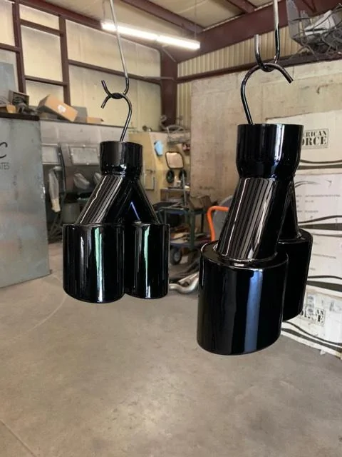

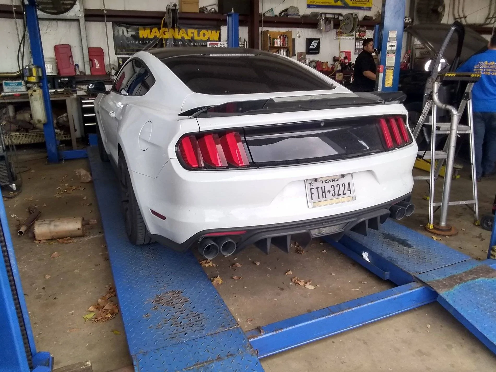

I was at the shop to get them installed today, however, turns out my borla ataks are 3" instead of 2.5" inlet so these tips wouldnt fit them lol. The guy i bought the ataks from said they were 2.5" so that sucks haha. But im planning to get 2.5" ataks so i can put these tips on still, just might be a little time. Also, i actually got them powder coated black.

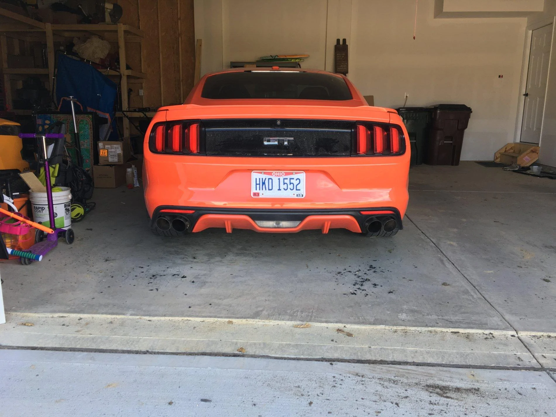

First, here is a before and after shot.

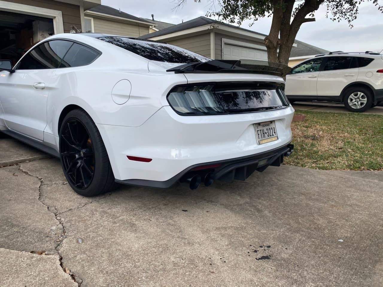

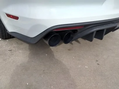

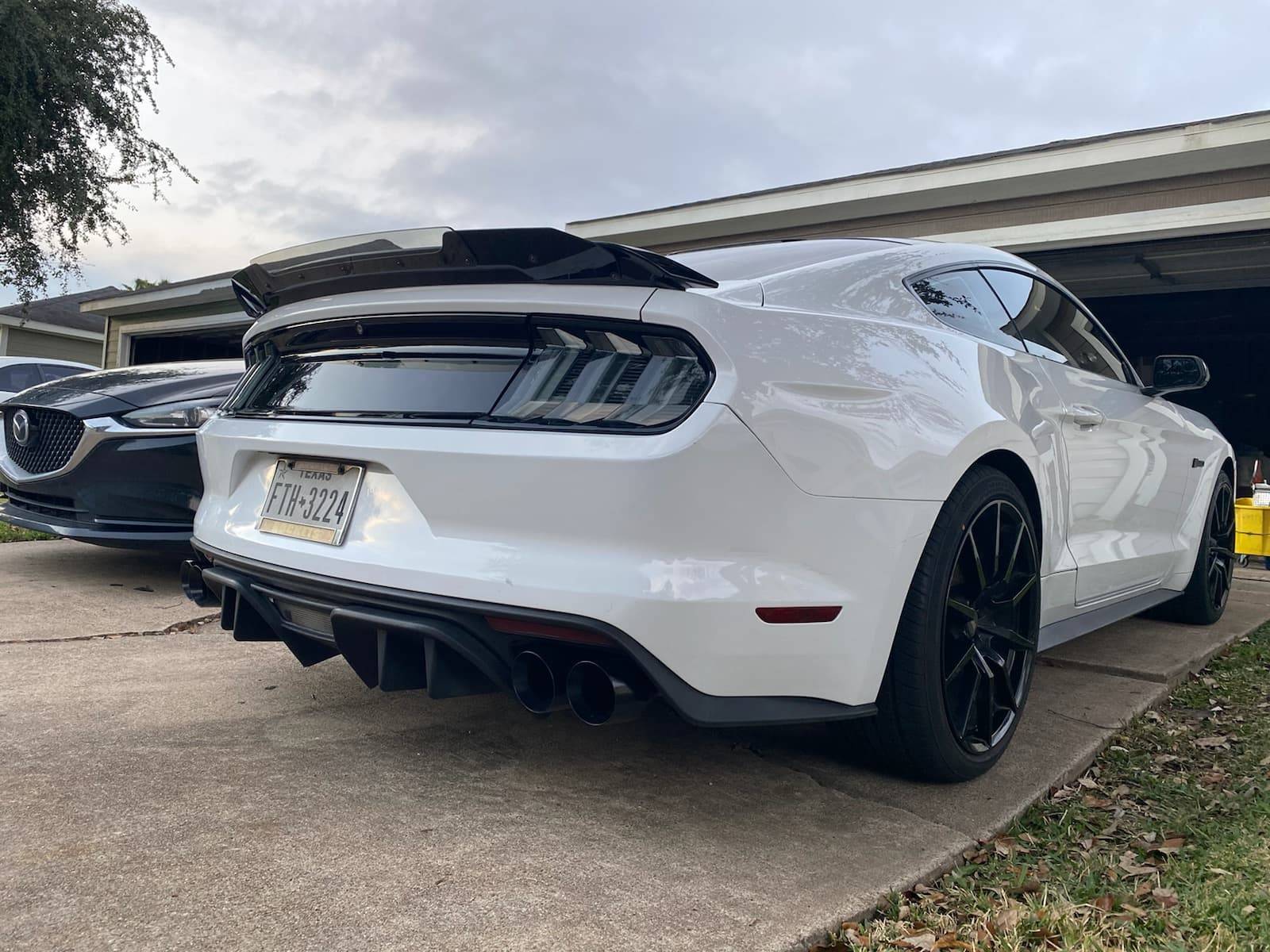

I ended up switching to 4" tips. Sorry for bad quailty on one of the pictures. I also still have the trim and no issues with it. (Also, i am selling the 3.5" tips that are powder coated black, $50 plus shipping)
